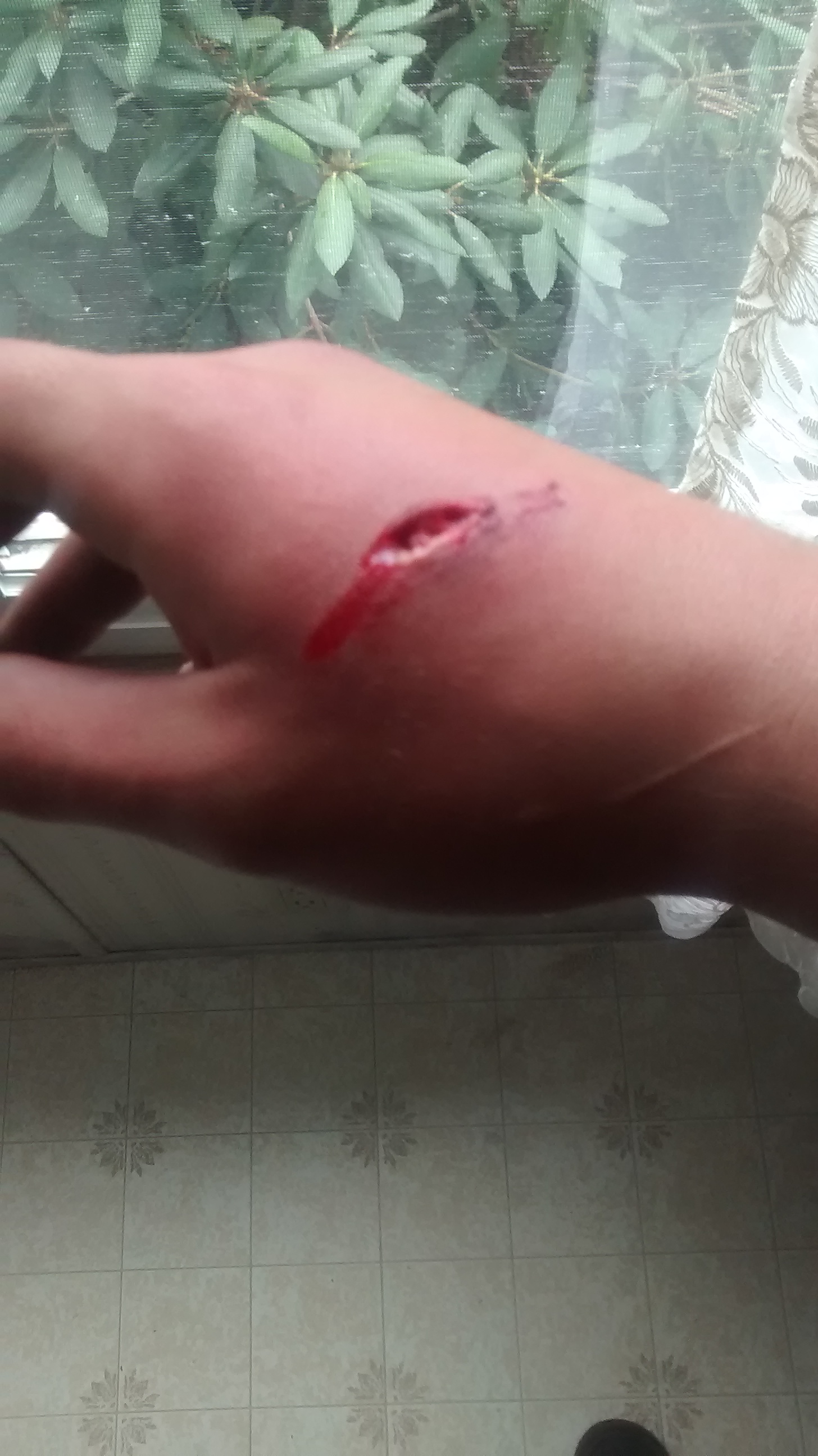

May 7, 20179 yr Was in a hurry to get a knife done for a customer, just got the steel this morning. Was making a few cuts with my 4-1/2" angle grinder and the cut off wheel wore out. Looked around, couldn't find another *proper* one. But I did find about a 7 inch cut off wheel (probably for a demo saw) stupid me, I thought "I only have one more cut to go, what's the big deal?" Threw it on the grinder, about 5 seconds into cutting, it exploded, and a piece nailed me in the hand (wasn't wearing gloves.) It cut to the bone. I'm just glad it didn't hit me in the face, or the neck. Im all patched up now, though typing one handed. Todays lesson in the School of Hard Knocks: Don't use improper grinding wheels, even if it is just one little cut you have to make. P.S. That scar on my wrist that's kind of hard to see? Also from a grinder. One would think the lesson would have been learned the first time.
May 7, 20179 yr Moved this into the safety section for you. Lesson to be learned: Buy an extra "proper" cut off wheel. New or old wheel, ALWAYS allow the grinder to speed up and reach full operating speed for a period of time before using the grinder. Hold the grinder in a safe position in case the wheel or grinder has a problem during this testing period of time. Keep all safety guards in place, in the proper position, and operational when using the tool. Glad it was no more serious than a few stitches and the injury does not restrict the use of your hand a whole lot while your healing process. Lessons in life are a learning experience. The tests to see if we learned from these lessons are sometimes graded on the pass / fail system. Thank you for posting the refresher lesson in safety.
May 7, 20179 yr Author Woops, thanks for moving that for me Glenn. I appreciate the wisdom, as I'm sure others will too. It was one of those go, go, go moments where safety was forsaken in favor of production. "The customer has been waiting long enough" I kept thinking. Would have taken me about 45 minutes to run and get another wheel, now I'll be lucky if I'm only a day or two behind. And yeah, the mobility is still there. The gauze and medical tape are somewhat restrictive, however haha. Thank you for the kind words as well.
May 7, 20179 yr What were you cutting with the cut off wheel? Did it REALLY require such a dangerous tool to cut? The only place I use a cut off wheel except when it's the only thing that'll work is in my hot saw and I only use that for really thin material the band saw snags on. Unless the stock you were cutting I'll bet a hack saw would've worked and in many cases faster. The worst injury you're likely to do yourself with a hack saw is barking your knuckles if the blade breaks and then only if you're leaning too hard on it. About cut off wheels. Oh yeah NEVER use one that isn't rated for the tool you're using it in!! would you put an Allison airplane engine in a Cooper Mini! That's just an example I knew a fellow that if he were alive he'd do just that and be running it on drag strips, he was famous for V12 and V16 Allison powered funny cars. Sorry for the side track. The right cut off wheel in the right grinder is only the start. As Glenn just said, let it come to speed BEFORE applying it to anything! Even peanut grinders torque when you start them, give it a try, hold it as steady as you can and pull the trigger. It WILL twist in your grip, not a lot just a little bit. However cut off wheels are pretty fragile and if it's in even a little cut the grinder torquing will bind it and binding can break or damage the wheel. Same for shutting it off, remove it from the cut BEFORE letting go of the trigger! Do the above text again or just pay attention to what it does in your hand when you let go of the trigger. It torques the other way and if the wheel is in the cut it has drag on it the motor has to fight with momentum. Conservation of angular momentum says it WILL twist and the blade is trapped in a slot almost exactly the same width. The blade will bind, maybe not enough for you to notice it but it can damage an already darned fragile cut off wheel for the next time you use it. If you drop the grinder or heck anything hits it. CHANGE the BLADE! It may look fine and it might be. MIGHT BE FINE pieces of a shattering 4 1/2" grinder leave the party at around 140+mph and you are literally inches away. The only time I wear my leather apron anymore is when I have to use a cut off wheel. I think hard about alternatives before picking up a cut off wheel. Glad you weren't injured more seriously though where it got you is a really close call. Lots of tendons and connective tissue to damage in your hands. Heal up quick. Frosty the Lucky.

May 7, 20179 yr Author 58 minutes ago, JHCC said: How did you fit a 7" wheel inside the guard on a 4-1/2" grinder? 50 minutes ago, Frosty said: Didn't, couldn't. Nothing gets by you guys haha. No, admittedly, there was no guard. Ding! Another foul. I was pretty much asking for disaster, I realize that, but I was in too much of a rush. Frosty I was making a few cuts on the stock to save from having to grind it out, hacksaw probably would have worked, but again, too much of a rush. Did it require that dangerous tool with a lethally incorrect wheel on it? Nope. Definitely not. I hope youre not kidding about if I want to know why you're called Lucky. That sounds like an interesting story. Thanks for the wisdom and kind words as well. Anachronist Thank you. Das Thank you. I don't plan on doing that again. Like frosty said, a few millimeters could have meant me losing 1. A lot of blood, or 2. Mobility in a finger or two. On my dominant hand nontheless! I'm glad to hear you took the wheel off that deathtrap though.
