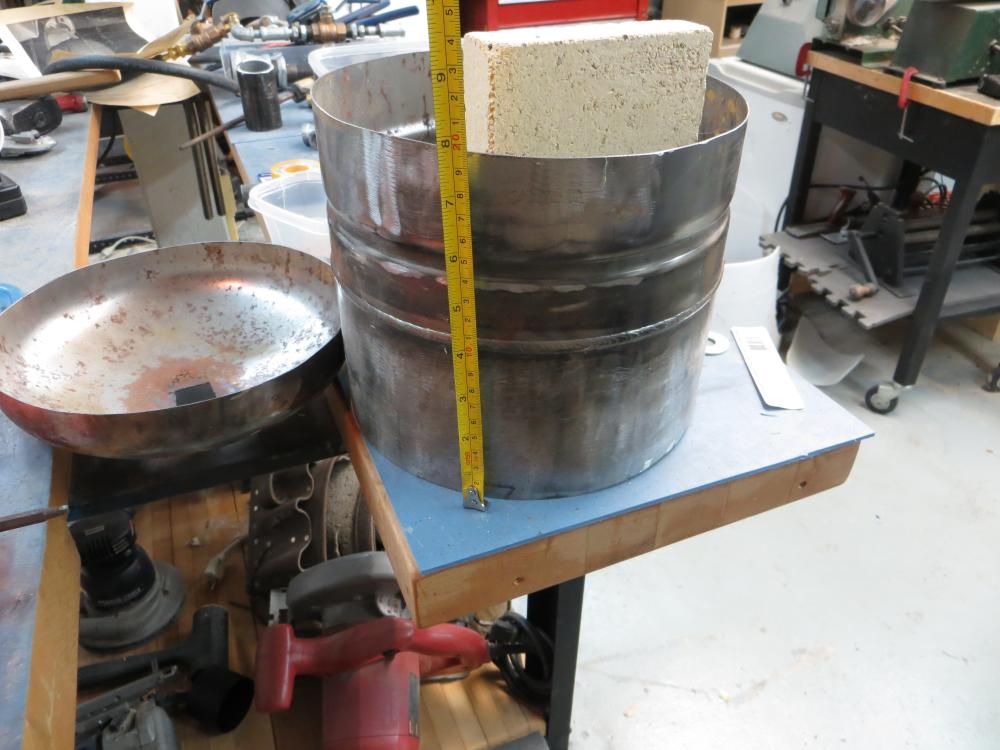

Hi Folks.
Mike H here.
In the interests of posting build stuff in the right sub-forum (instead of my Introduction) I thought I would share my progress so far.
I have so far cut open a small water pressure tank measuring 9" high by 7.5" long. Assuming 2" kao-wool plus ceramic refractory I am NOT looking at a lot of volume in the forge. (147 cu in")
I have now also have a (mostly I think) working 3/4" Mikey Burner.
So I have concerns that
a - the burner is too big for the volume causing extreme back pressure.
b - the mouth of the forge will be a major obstacle to getting things in. ie coil springs for reforging, armour bits, curved s hooks and such.
I can roll my own forge body out of some 16g cold roll I have here...I was thinking a slumped oval profile might be an efficient yet wide style. Or I can widen the existing shell into an oval (the doors will be pain though) or I can length it (but then I wonder if the heat will get to a 12" long forge from just one burner)
Here is some video of the burner. (Audio is a bit low)
Here is a quick vid of the flame with lights out.
Thoughts?
ps. Pretty happy so far with this burner design. Thank you Mike.
Any feedback is most appreciated.

If you will study the Build a Gas Forge attachment at the Forge Supplies page at www.WayneCoeArtistBlacksmith.com you will see how you can cure the size issues you talk about.
Don't use fire brick for the floor.  It is a heat sink.  Cast it instead .  You can' tell anything about the flame of the burner outside the forge.  Enlarge the back door to help with back pressure issues.
Let me know if I can help you.
Wayne
A 3/4" Mikey burner would be too much burner for that little amount of space.  I'd recommend a 1/2" Frosty T burner or comparable.
Concern B is what I'd be focused on. The burner is fine, make a bigger forge body. Like you're already thinking, what you have is great until you start to bend the straight piece you've been heating up. Then all of a sudden it doesn't fit back into the forge for the next heat.

  • I am drawing up a 'slumped' oval shape 8" wide by 5" high
More Volume. Done.
  • I am extending length of working space to 8" (12" external frame) gives 322 cu in.
Do not use firebrick for floor.
I thought firebrick was a good sacrificial material assuming it takes the brunt of the wear of
  1. objects placed inside the forge
  2. dropped borax flux from forge welding
  3. direct flame hot spot
Am I off the beaten trail on this?
Here is a sketch of new forge profile showing all elements and some dimensions.
Does the firebrick work in this configuration? Its surrounded by 2" kao-wool plus a thin layer of castable refractory cement.

Yes and no.  Firebrick does handle the things you listed fairly well. The main drawback is it's a large heat sink, so it can reduce the efficiency of your forge a bit.  The simplest way to put this is that there are better materials to use which can still hold up to the things you listed, but don't suck as much heat out of the system.   Kiln shelf or castable/rammable refractories seem to be the generally accepted favorites at the moment.
FWIW if I were doing that general design I think I'd go with the clamshell option so that you could lift one side a bit to get odd shaped pieces in the heat if needed.  I'd still stick with the flat floor and the oval or "D" shape, but having more configuration options is not a bad thing.
