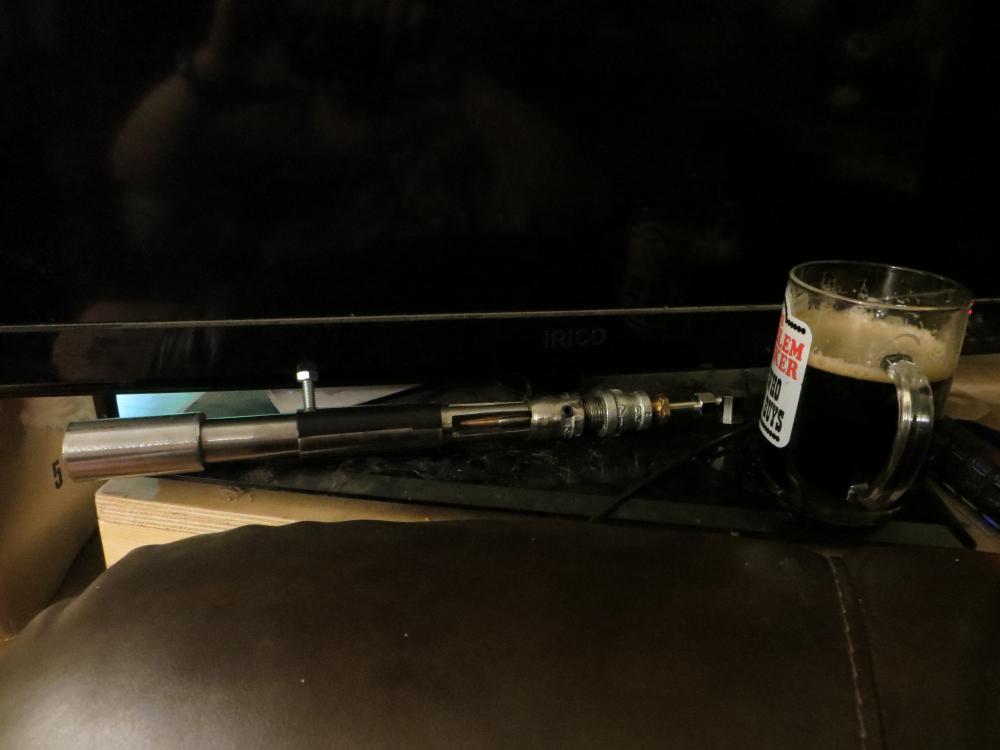

A few minutes ago I called it a day, poured a beer and looked over my first Mikey 3/4" gas burner.IMG_3382.JPG

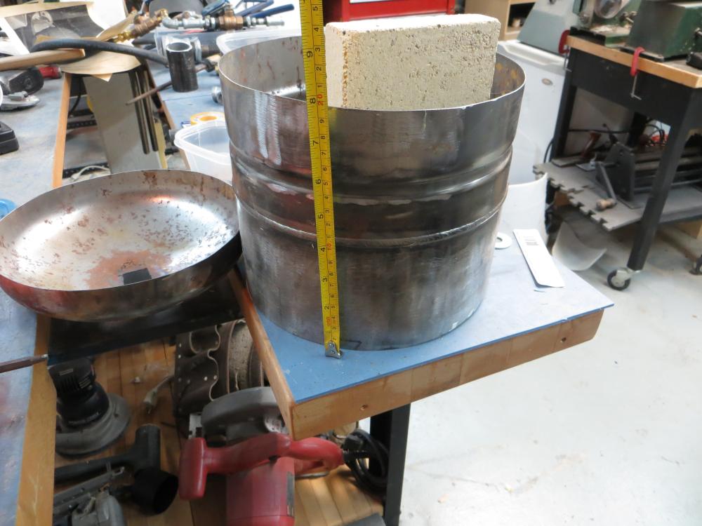

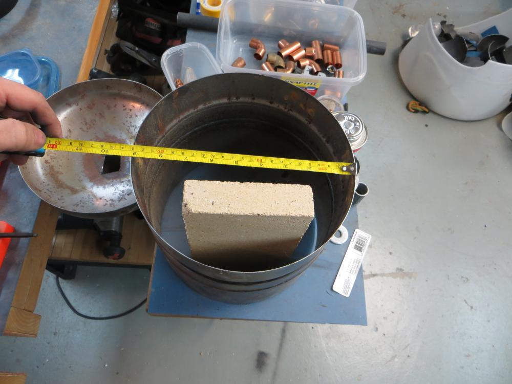

I have had a small water pressure tank cut out for several months, but finally got time to get back to this project.
Seeing that this forge inside dimensions after 2" Kao-wool added will be about 147 sq inches I am pretty sure this burner may be too big (maximum 340 sq in for the 3/4" burner apparently).
I am going to add 5" to the length of the forge to try and match the burner a bit better. (245 sq in.)
Anyone think that will be big enough for the 3/4" Mikey burner?IMG_3376.JPGIMG_3377.JPG

Anyways, Mr Porter please accept my highest accolade for a great burner design.
Thank you.
Yeah, that's about 2x the burner for the volume but it will be a good test of your building skills if you can turn the PSI low enough it'll run properly. Going to find something better than a fire brick for a floor? Fire brick is a major heat sink , it takes a lot of fuel to heat it and keep it hot. Sure you'll have more than enough burner but the internal volume is the limiting factor, it'll make a lot more back pressure.
Bearing in mind a Porter burner is a lot more stable and forgiving of conditions than a T or Sidearm it may not have trouble in that size chamber at all.

I will bring it to a 12" length, just to give it less back pressure. That is exactly what I was worried about.
Brick will sit on 2" kao-wool + castable refractory coating.
It is also my intention to have both ends with side hinges, with access port in front and pass through in the back.
I really do want this forge to stay small, but part of that is containing the flame as well. I get that this is probably just my first forge as I know how needs can grow based on a new toy.
If I may ask a second question, would it be worth tilting the burner back slightly towards the back door to try and heat the longer length more evenly?

Any thoughts about this tiny forge and 3/4" burner? Do I have a hope or did I just build a bomb.
Lord knows that is what the guy at the hardware store thinks...har.
Seriously, am i gonna die? (grin)
I've done forging sitting down before.  Had to set the anvil down lower and certainly wear a leather apron.  Best for working small stuff as I recall I mainly worked on some bodkin points and small blades.
Well, to answer your question; yes the 3/4" Mikey burner will turn down that low, and serve well. Moreover the larger exhaust port tube used to hold this burner in place will serve all the better if you  decide to build a 1/2" burner for the forge, later on :D
