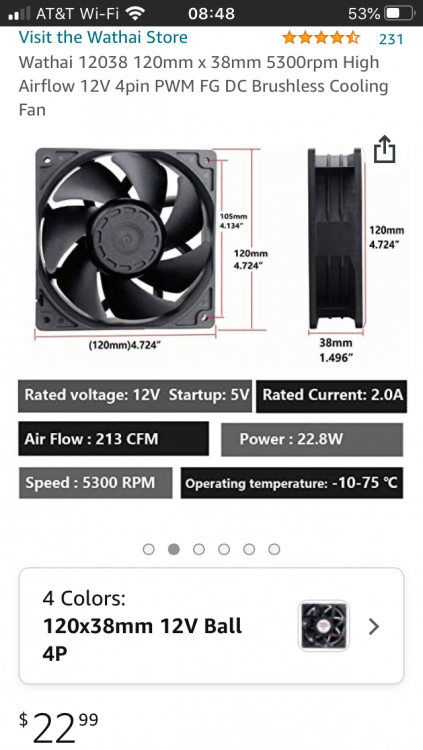

Glenn Posted February 4, 2008 Share Posted February 4, 2008 From the email: I have a question about forge motors and CFM. My twenty year old hand made forge used an underpowered bathroom vent fan (50 CFM) and I need to replace it. I have a pancake fan (75 CFM) or another old computer fan that might generate 300 CPM. What do you guys think? I pipe the air from the fan box through 3" ducting that has a damper installed in it and then it transitions into a 2 inch pipe tee and flange that bolts to the the top of an old inverted cut down hot water heater. Really, it's not much more than a rivet forge, but I've fashioned a lot of tools and hardware with it over the years and I'm anxious to get back to using it. Nett Link to comment Share on other sites More sharing options...

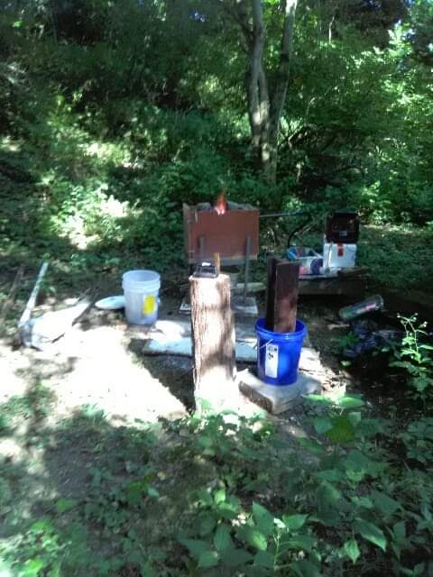

blksmth Posted January 31, 2009 Share Posted January 31, 2009 It is pretty well known that any forge that can burn iron or create iron sparks is hot enough to forge weld, if all other requirements for a forge weld are in place. Even if that forge has a very small and weak blower such as a small squirrel cage blower. It may not be fast or efficient, but you can say it works. Nevertheless, here is an experience that the Prairie Blacksmith Assn. of Nebraska had a few years ago: We had Tom Ryan of New York as a demonstrator. Tom was trained in England and also had experience working in France. His project was a multi-scrolled sign hanger that was mostly made of 1/2" by 3/4" A36 bar stock. It consisted of several forge welds and Tom did not use flux. The PBA had a Blacksmith Journal designed side draft forge built as a Blacksmith Association of Missouri workshop project, and it was set up for Tom to use. The forge had a squirrel cage blower that BAM had purchased for the project from Granger. It was 175 -200cfm. It did not take Tom long to ask for another forge as the BAM forge was not able to heat the iron to forge welding temperatures fast enough for him. We switched him to a medium sized Champion 400 hand crank railroad forge which worked fine as long as someone was turning the crank at a relatively brisk pace. After the demo I began forge welding without flux also. Since the Blacksmith Journal designed forge was my personal forge, it didn't take me long to purchase a much more powerful radial fan blower which I did from Centaur Forge. Even though I was making good forge welds with the old squirrel cage blower forge, the new blower made a world of difference in the speed and efficiency of my forgings and forge welds. It also allowed the forging and welding of much larger iron. There is my story for whatever it is worth. Link to comment Share on other sites More sharing options...
Paul B Posted January 31, 2009 Share Posted January 31, 2009 blksmth, Was the new blower an electric one or hand cranked? Do you see an advantage to the electric with a control knob or do you think a hand crank is so good or better? I am in the process of building my first forge and would not like to do it twice before I get started. Link to comment Share on other sites More sharing options...
Ten Hammers Posted January 31, 2009 Share Posted January 31, 2009 (edited) Once I figured out the airgate, I stopped using crank blowers ( in the home shop). My first use of electric was a shop vac. On/off. I then brought the dayton speed control from the basement shop ( used for dremel etc) out to the smithy. Still on/off but had better control. This lasted till the vac toasted ( I guess it was a year and was a used vac when I started ). I bought another shop vac. Sometimes availability of other blowers is not good. I don't get out much. I then built the airgate. Scrapped 3" cyl tube. I found the ( current) blower attached from an HVAC fella. From the pic you can see what it is. Probobly 6-7 years ago and it was (blower) was on a wrecked furnace. I run the blower many days for 5-6 hours. Wide open all the time. The airgate gives me the variance I need. Yes I have burned up a few things over the years. Yes that is a Canedy Otto blower in one of the pics. It stood there until I built the gassers. I do a substantial amount of production work sometimes and the airgate gives me the freedom to go to the other side of the shop ( or around the back of the forge to welding station ). When this squirrel cage toasts it is possible that I will just get a replacement motor from the farm store. I really haven't decided. I now have another blower or 2 that could be put before the airgate. They are belt driven and would require a brush motor to hook up the speed control. I have one or 2 of them also. My point is, the blower I have in the shop functions great. I can either put half dozen tripod legs in the solid fuel or gasser. 5/8 stock. I can burn the tripod legs in the solid fuel and if I'm not careful I'll have them stuck together. I have no clue about the cfms. No I do not weld billets. From time to time I will do some forge welding. The fire you see in the pot is charcoal and the edge of the sack in the lower left of that pic. The plumbing from the blower to the pot is a ( somewhat) copy of Juniors shop. The pot is a Roger Lorrance and shop built from there on back to the blower. I have no wish to do anything except convey information. I make mistakes most days. This is my setup and some of my experience. Edited January 31, 2009 by Ten Hammers Link to comment Share on other sites More sharing options...
Ian Posted January 31, 2009 Share Posted January 31, 2009 Steve, why are you apologising? There's no need to. All you're doing is showing what you have, what you work with, and how you find it works Good on you for doing it, more should Link to comment Share on other sites More sharing options...

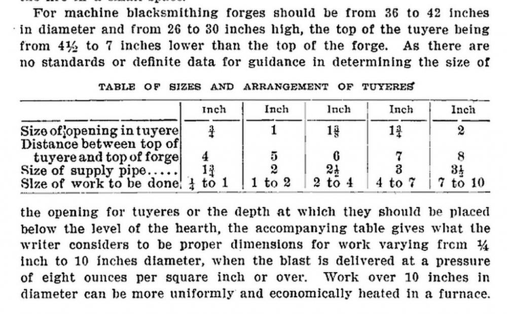

Glenn Posted January 31, 2009 Author Share Posted January 31, 2009 Machineries Handbook 12th ed.Blacksmith forges require air pressures varying from 1-1/2 to 6 ounces per square inch. Small forges with the blower close to them are adequately supplied with 1-1/2 ounce of pressure. If the blower is some distance away and a long discharge pipe with many bends leads to the forge, even though the latter be small, it may be necessary to carry 3 ounces pressure or more, to overcome the friction in the air ducts. Large forges usually require 3 to 6 ounces of pressure.This was written in 1945 based on forge sizes and forging standards at that time. The point is made apparent by listing the size of the discharge main at the blower for 1 to 10 forges in use, each forge with a tuyere sizes from 1 to 4 inches in diameter. For instance, a set up using 4 forges each with a 1 inch diameter tuyere would require a 3 inch discharge main at the blower. The 3 in duct has just over 7 inches in area, so 10-1/2 to 42 ounces of air pressure would be required. This does NOT suggest what size forge is appropriate for that time period, how large a fire us used, or how large a piece of stock is being forged. I would suggest that in 1945 they were not forging s hooks from 1/4 inch round stock for sell at a ren fair, but that it was a working forge and required to produce what was needed for the client. Link to comment Share on other sites More sharing options...
HWooldridge Posted January 31, 2009 Share Posted January 31, 2009 Machineries Handbook 12th ed. This was written in 1945 based on forge sizes and forging standards at that time. The point is made apparent by listing the size of the discharge main at the blower for 1 to 10 forges in use, each forge with a tuyere sizes from 1 to 4 inches in diameter. For instance, a set up using 4 forges each with a 1 inch diameter tuyere would require a 3 inch discharge main at the blower. The 3 in duct has just over 7 inches in area, so 10-1/2 to 42 ounces of air pressure would be required. Now THAT is really good info. Some engineer sat down and figured out what actually worked then consigned that data to MH. I have both a 22nd and 18th edition MH but they had removed the references to forging by then. I'll have to try and find one of the older publications. Link to comment Share on other sites More sharing options...
