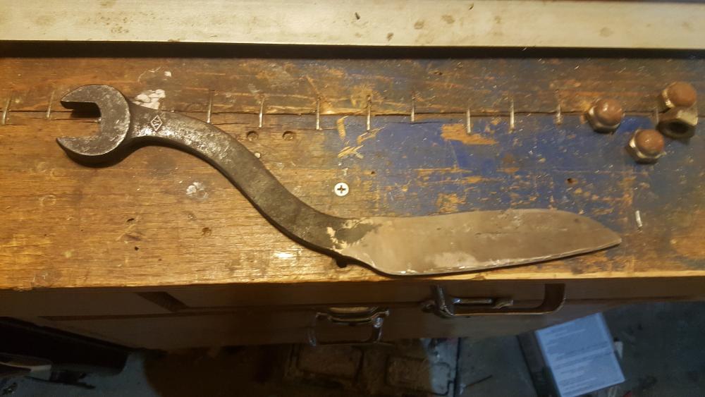

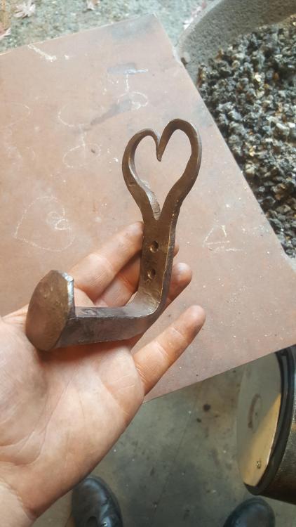

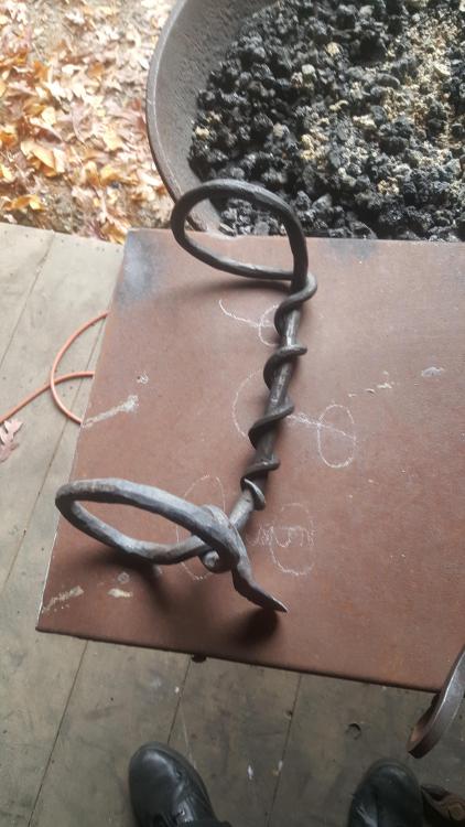

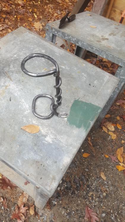

SkoobyNewb Posted November 3, 2016 Share Posted November 3, 2016 These are my latest beginner projects ive finished. Just a basic wrench knife, which was my first attempt at forge welding. A drum stick stand that someone asked me to make for them. And a RR spike coat hook, I just made this morning for my girlfriends birthday. I may make another for a set, but not sure yet. Quote Link to comment Share on other sites More sharing options...
SpencerDirks Posted November 3, 2016 Share Posted November 3, 2016 I like the heart hook! good work man. Quote Link to comment Share on other sites More sharing options...

Daswulf Posted November 4, 2016 Share Posted November 4, 2016 Nice spike heart hook. One tip/idea is to countersink the holes for the screws unless you plan to use something else like a bolt to fasten it. Typically I find people like the countersunk screw holes. Keep up the good work. Quote Link to comment Share on other sites More sharing options...

ausfire Posted November 6, 2016 Share Posted November 6, 2016 Great ideas. The heart spike is very well done. I like the spanner knife too. Needs a good polish to finish it off. You're off to a good start. Carry on, sir. Quote Link to comment Share on other sites More sharing options...
JHCC Posted November 6, 2016 Share Posted November 6, 2016 One thing to consider is deliberately NOT making a lot of different things, but instead to do one thing over and over until you can do it in your sleep. I have a friend who doesn't have her own forge and thus relies on the weekly open forge half an hour away. What does she do with her limited shop time? As she puts it, "Leaf after leaf after leaf after leaf. Lots of key rings." That RR spike/heart coat hook is a real winner. I promise you this, my friend: once you've made several dozen, you're going to be really good at splitting, drawing out, punching, bending, and shaping. That's a good, sellable item. Go get really good at making it. Quote Link to comment Share on other sites More sharing options...

Glenn Posted November 7, 2016 Share Posted November 7, 2016 The RR spike/heart coat hook might be improved by making the bottom part a J instead of an L. The upturned and rounded head of the spike will be easier on the inside of a coat than the sharper edge of the spike that sticks up now. Try both and make the version YOU like. Quote Link to comment Share on other sites More sharing options...
ausfire Posted November 7, 2016 Share Posted November 7, 2016 Perhaps he made the hook an L rather than a J so that the screw holes were easily accessible without angling the screws. Could be avoided by drawing out the spike a bit of course, but that adds time and takes away from the original shape of the spike. Anyway, the heart idea is really neat. Quote Link to comment Share on other sites More sharing options...
