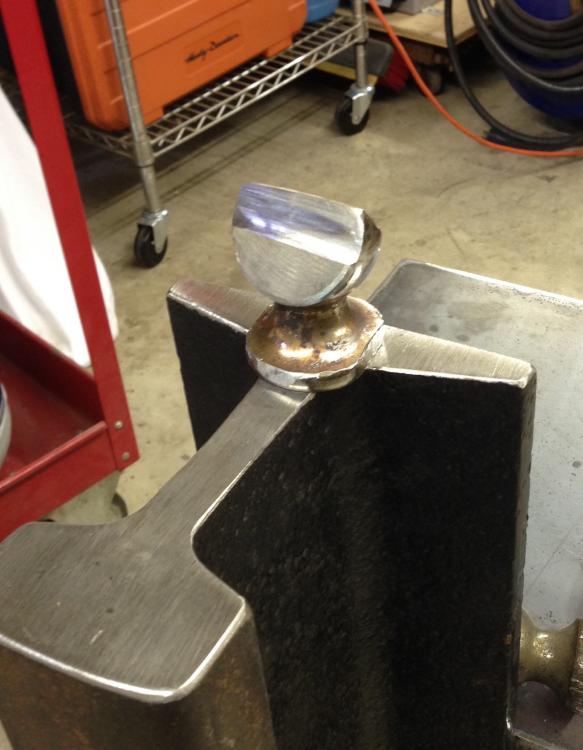

CTBlades Posted October 20, 2016 Share Posted October 20, 2016 I drilled a 3/4" hole in the web of my rail because a have a box of tow ball hitches and thought could make a bunch of tools. Here is a cut off tool I ground out this morning. Seems to work well. What do you guys think? Frosty does this help your guts thinking? LOL Quote Link to comment Share on other sites More sharing options...
Daswulf Posted October 20, 2016 Share Posted October 20, 2016 Looks like it'll do the job. Wow that is a lot of grinding. Does it just sit in the hole? They are better off easily removed in my opinion so you can pop it out and get back safely hammering without a potential finger lopper there. On a side note, if it just sits in a round hole there is the potential for it to rotate around making you chase it. Quote Link to comment Share on other sites More sharing options...
Buzzkill Posted October 20, 2016 Share Posted October 20, 2016 I had the same thought, but it looks like it would be fairly easy to weld some vertical pieces on that would keep it from rotating. Quote Link to comment Share on other sites More sharing options...
CTBlades Posted October 20, 2016 Author Share Posted October 20, 2016 Yes Das it is a slip fit but tight so I just tap and pull so it pops out for quick change or removal. I thought about having to chase it so I cut in diamond pattern teeth on the collar so it grabs the web and holds it. I used it a couple times and she stayed in place. On 10/20/2016 at 2:00 PM, Buzzkill said: I had the same thought, but it looks like it would be fairly easy to weld some vertical pieces on that would keep it from rotating. Again, I cut a diamond pattern in the bottom of the collar so it grabs or digs into the web just a little...welding a couple stops might be an option as well...thanks. Quote Link to comment Share on other sites More sharing options...
Daswulf Posted October 20, 2016 Share Posted October 20, 2016 Good deal then. Since you have a box of the ball hitches, and you obviously are good at grinding them, you could make a couple different diameter bottom fullers. Quote Link to comment Share on other sites More sharing options...
CTBlades Posted October 20, 2016 Author Share Posted October 20, 2016 Yea sir, that's what I was thinking as well...the grinding took some time but other then a little time and some electricity, it was free so I'm happy! Quote Link to comment Share on other sites More sharing options...

bigb Posted October 21, 2016 Share Posted October 21, 2016 That is a great idea. Myself I found a bunch of bucket teeth at the scrap yard and I welded one to a piece of round plate, works great for cutoff and for opening up my split crosses, Your trailer ball idea has me thinking, I believe I have an old 2-5/8" ball in the shed with a 1" shaft that I could grind into a 3/4" square to fit my little Swedish anvil. Are trailer balls hardened? I wonder if the grinding heat anneals them? Quote Link to comment Share on other sites More sharing options...
CTBlades Posted October 21, 2016 Author Share Posted October 21, 2016 8 hours ago, bigb said: Are trailer balls hardened? I wonder if the grinding heat anneals them? Yes sir they are and they are a PITA to grind. I took my time grinding to make sure I keep the heat down. I also used a rag wrapped around the shaft and collar away from the grinding area and a couple wrapped around my vice with extra packed around the ball that I kept wet with cold water. This helps to draw heat away so that I could grind longer and stop less. (An old knikemaker tought me this trick) works great on straight razors and knifes. Every little bit helps. Quote Link to comment Share on other sites More sharing options...
