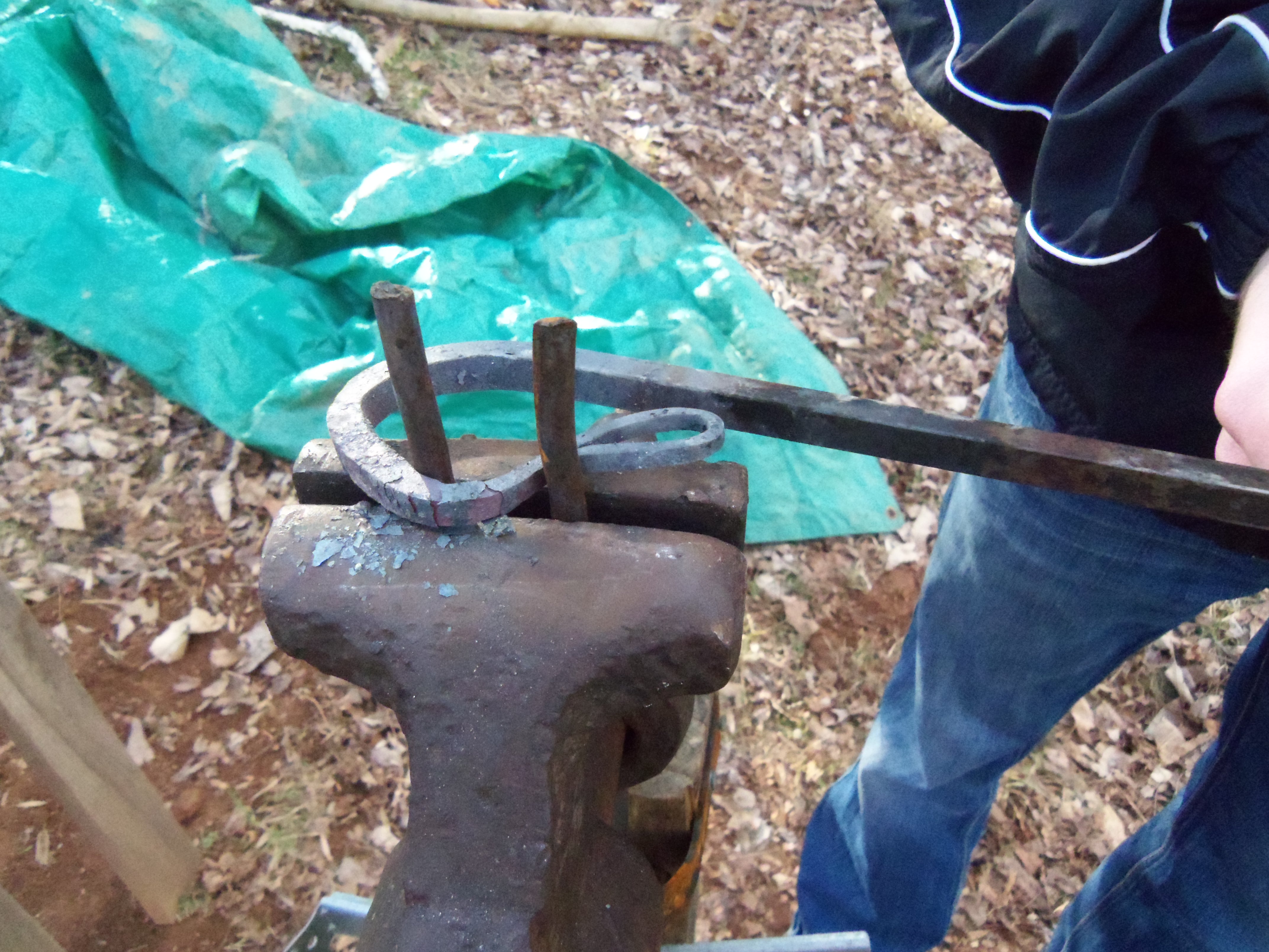

Ridgewayforge Posted October 12, 2016 Share Posted October 12, 2016 52 minutes ago, Zeroclick said: Well to begin with I am looking to learn basic techniques, so tongs, chisels,candlesticks, door hinges etc. Just smaller pieces that expose me to a few different techniques, once I get to grips with them I hope to get a bigger anvil to work on. I am hoping to put a hardie hole into my first one so I can build some tools for curves, so a horn isn't essential at this point. That makes me happy; You want to learn blacksmithing first, not bladesmithing (nothing wrong with bladesmiths, but this makes me think of my own beginning! Tools and hardware, as I say!) The curves can be done: 1) over the edge of the anvil without a cone or horn- its really easy to do, and once you start hitting hot iron, you will see how it forms an "anvil" on itself- I.e., each time you hit it unsupported, it curves a certain amount, making nice gracile curves, once you have the hang of it. or, 2) with vice-mounted bending forks and forms. This removed the need for a hardy hole, as even a machinist vice (cast iron) can withstand bending motions, to a degree (don't go overboard, though.) if you're using mostly smaller stock, then there is no reason a light duty vise can be used for twisting, bending and curving. It makes a good non-impact tool holder. Quote Link to comment Share on other sites More sharing options...
Zeroclick Posted October 12, 2016 Author Share Posted October 12, 2016 Thanks I like the idea of making some bending forks, I have a vice that will suit it perfectly. I will look into getting a sledge hammer or a big chunk of something hardenable. If I did use a big chunk of mild steel wouldn't that deform quickly with use. Quote Link to comment Share on other sites More sharing options...
