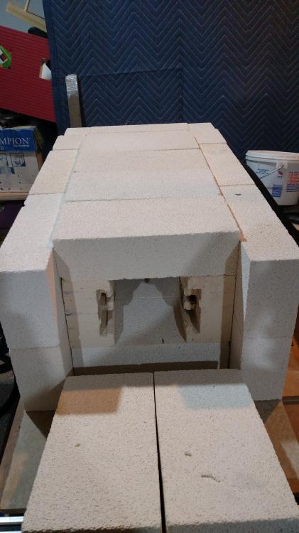

Goro,
Heat treating ovens are not too difficult to build and can be done for far less that $2000.
I built one for around $300 using all new parts.  It is powered by standard 120V AC and has a digital temperature controller.
I can provide construction details (separate thread) if anyone is interested.
7 hours ago, RogueGeek said:
Im hopeless at anything electrical. Ive been told PID controller, power supply, thermometer and heating elements etc pretty much the electrical side would cost in excess of $1500 AUD
I can't speak for non-US costs or availability but the PID controller I used included the thermocouple and solid state relay.  I think it was under $50 USD on Amazon.
I also wound my own heating element coils.  The resistance wire was also purchased from Amazon for around $25 USD.
I think the bricks were the most expensive part they cost me around $80 for a case of 25.  Misc switches and lights were probably another $25 or $30.
The hardest part was winding the element.  The wire is very stiff and I had several rats nests to untangle before I managed to finally get it.

On 10/10/2016 at 10:04 AM, RogueGeek said:
Goro,
quote edited
I was wondering if you ever got around to providing construction detail for this. It looks great from what I can see but would like to know more about it.
Unfortunately I didn't.  I will try to do a quick write up or video soon and post it.
I definitely look forward to it then.
