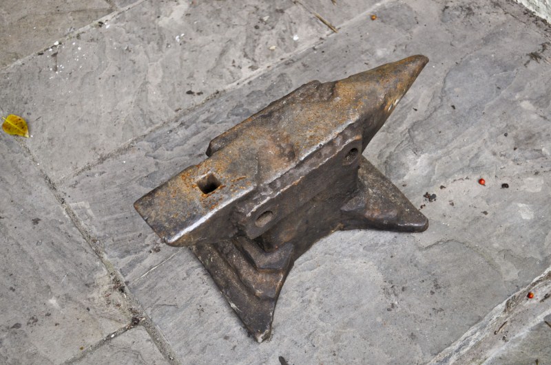

the iron dwarf Posted September 29, 2016 Share Posted September 29, 2016 when time permits I am going to clean this up, check for markings, remove the badly welded plates and try to fix this. at the moment though I have too much to do so just posting some pictures. weight is between 100 and 112 pounds at a guess. these pictures are from 2011 when I got this, more details when I clean it up a bit the anvil has broken from above the feet to the middle of the table as can be seen in the second picture and 2 ugly plates have been added. my plan is to closely examine it as is and then to clean it with pressure washer and hand wire brush and then examine it more, then to remove those added plates and check for markings below them, remove the welds that have been added and deeply V it and do a better job of welding and then look into refacing where needed. this will take a lot of time but I will try to do updates when I can Quote Link to comment Share on other sites More sharing options...

JHCC Posted September 29, 2016 Share Posted September 29, 2016 That's not a reinforcing bar on the side -- it's a heading plate for rivets! (Very short, very thick rivets.) Quote Link to comment Share on other sites More sharing options...
aessinus Posted September 30, 2016 Share Posted September 30, 2016 Have to wonder how that got busted. Under a big power hammer? Anvil shooting? A really enthusiastic smith get his hands on Mjölnir? Quote Link to comment Share on other sites More sharing options...
the iron dwarf Posted September 30, 2016 Author Share Posted September 30, 2016 it was probably just a failed weld, it may have failed after 100 years or more of use which still makes it a good weld, maybe things will be revealed when it gets fixed. it will be some time as I have just moved shop and need to get machines working and tons of junk sorted so I can make my normal stock for events so it will be a winter project Quote Link to comment Share on other sites More sharing options...

Everything Mac Posted September 30, 2016 Share Posted September 30, 2016 Anyone else notice the weld running diagonally down from the centre of the face towards the horn? It looks as though the front half of the anvil was broken off completely and then welded back on. And rather badly by the looks of it. Where did you find it David? It looks like a Czech anvil, you don't see very many of them over here. And what size is it? Andy Quote Link to comment Share on other sites More sharing options...

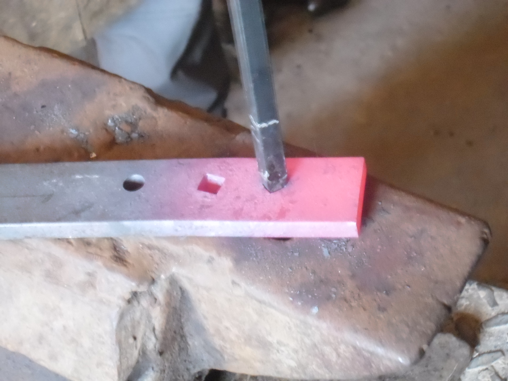

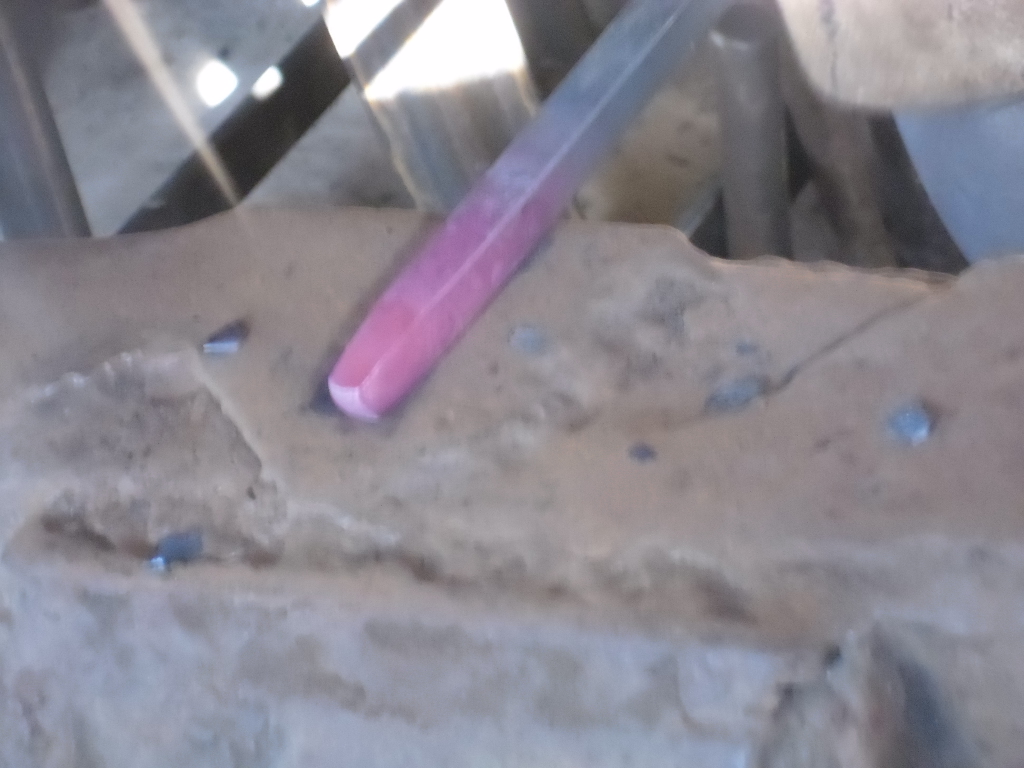

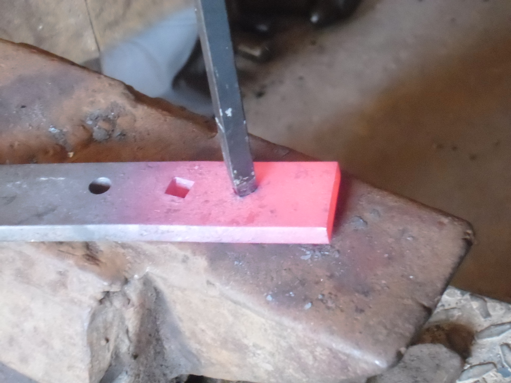

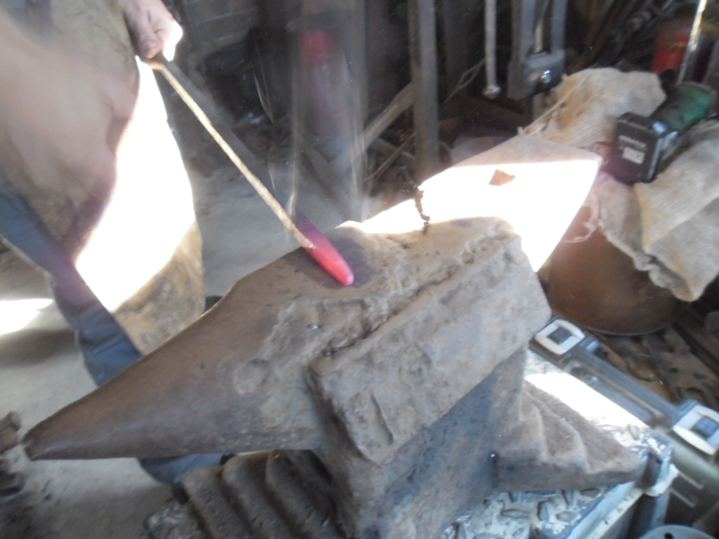

the iron dwarf Posted October 3, 2016 Author Share Posted October 3, 2016 today we used it, works fine according to John, we just avoided the areas where the top was missing making a nail header and drawing out some 12mm square ( 1/2" ) Quote Link to comment Share on other sites More sharing options...

Copper Elf Posted October 3, 2016 Share Posted October 3, 2016 I found it to be a perfectly usable anvil, needs a stand to get a real feel of it, at the moment it is on a set of plastic builder's steps. I will keep using it to clean it up. I am the first person to hit metal on this for ??? years Quote Link to comment Share on other sites More sharing options...
