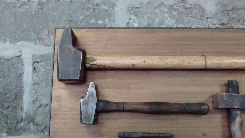

September 21, 20169 yr It occurred to me today that although I've seen a lot of hammer heads, I can't recall seeing a cross pein where the pein was offset to the top of the head like the claws on a framing hammer. I noticed that cross pein designs that aren't symmetrical tend to place the pein on the lower half of the head like the French pattern. I've also seen some called "Viking" pattern, as well as "Colonial" patterns that had peins biased to the bottom profile of the head. From what I've read, the French pattern is a "cutaway" to allow it to be used inside of a hand made lock case. I can imagine the vertical edge of the "cutaway" would give the smith some perspective of where the pein is inside of the case. I have no idea if the earliest French patterns were actually cut from a symmetrically headed hammer or if they were forged to that shape. As I think about it, it sure seems like a pein that was offset to the top of the head would maximize the moment forces of the swing just a little more than symmetrical or bottom offset pein. It also seems like the visibility for use inside of a lock case would be improved with the mass of the head completely to one side. I'm sure that any advantage one way or the other is minimal, but it strikes me as odd that smiths around the world have such a variety of hammer patterns, yet I've never seen one with the pein offset to the top of the head. I'd be interested to hear any explanations for it. Thanks in advance.

October 15, 20169 yr On 9/21/2016 at 5:53 PM, rockstar.esq said: It occurred to me today that although I've seen a lot of hammer heads, I can't recall seeing a cross pein where the pein was offset to the top of the head like the claws on a framing hammer. Here ya go...
