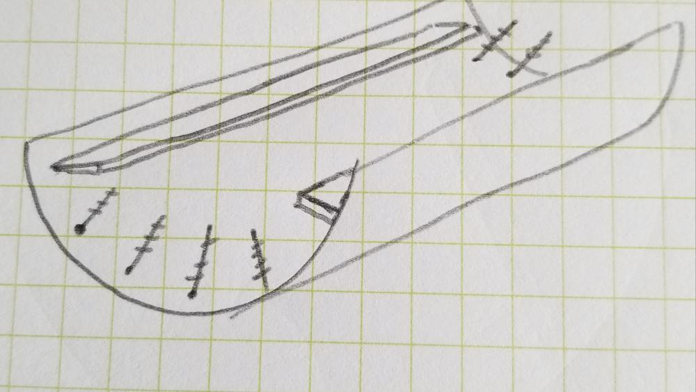

teenylittlemetalguy Posted August 7, 2020 Share Posted August 7, 2020 On 8/6/2020 at 7:49 PM, Another FrankenBurner said: When you say you welded in screws, are they protruding inside the shell and cast into the refractory liner? Thank you, nice to be called clever and not " that nutter that uses little forges" 8-) I drew a little diagram of how I did it. My biggest concern was all the guts falling out while driving down the road so I have internal features for the Kastolite to grip on and the shape is an arch. The flat bar running down the length is set in the Kastolite on both sides giving the arch a toe to hang onto. The screws are there to brace the external facing ends. Overall my Kastolite was 1/2-3/4" thick, except for the edges which are thicker to add strength, but nothing over an inch. Underneath is 2" of wool (also held in with a few screws. I probably went overboard, but it hasn't failed) I actually don't like the door locks, I just used a bolt with the very end bent in a U shape to pin the door rod down, a wing nut loosens the grip when needed. I have been forging cam latches for various things in my shop and my next version of the portable forge (v4, I think) likely will have cam locks for the door stops. My name is actually Tristan as Frosty kindly mentions me above. I am a fan of the Teeny Little Super Guy on Sesame street so I just co opted it. The kind of messing about you are doing here is very near and dear to my heart. Obviously you are taking it to a higher, more refined level which is really exciting. Can't wait to see where you head with your ideas. If there is any way I can help out please let me know. Quote Link to comment Share on other sites More sharing options...
Another FrankenBurner Posted August 8, 2020 Share Posted August 8, 2020 Thank you for all that. Frosty now has me wanting to see your forge all folded up. Any chance you have any pictures of that? Name is Curtis over here. If only I lived closer to the two of you. Have you had any issues with cracking where the metal and the refractory interface? Have you noticed any differential expansion issues? I like the cam lock idea. You said you have already forged several, any pictures of those? Thank you for the kind words. You have already helped out. I have been inspired to keep after the split forge. As you said, it adds some pain to the process but it seems something that will be worth the extra effort. Quote Link to comment Share on other sites More sharing options...
teenylittlemetalguy Posted August 9, 2020 Share Posted August 9, 2020 That would be really cool if we were all closer. It would be nice to bounce ideas off each other in person. Folded it can stand upright, but this is how it rides in the car, keeping the forge above the carpet. The metal bar doesn't go super deep, maybe 1/2" or 5/8". After 2 years of regular use and 12 road trips (90 mins each) it wore out partially along that line where the bar is, but only on the side where the flame hits directly. The screws are deeper near the side door openings and have held up well, which surprised me, I expected issues there but they have been stable. It might be from not putting them all in one exactly straight line. Just randomly placed. Your foam cores have me excited to possibly try another build this winter, if the world doesn't get any nuttier than it is... Cams- first small one with coil spring, happy with the action. Then I scaled up and made several hold downs using leaf springs, very strong solid lock. Quote Link to comment Share on other sites More sharing options...
