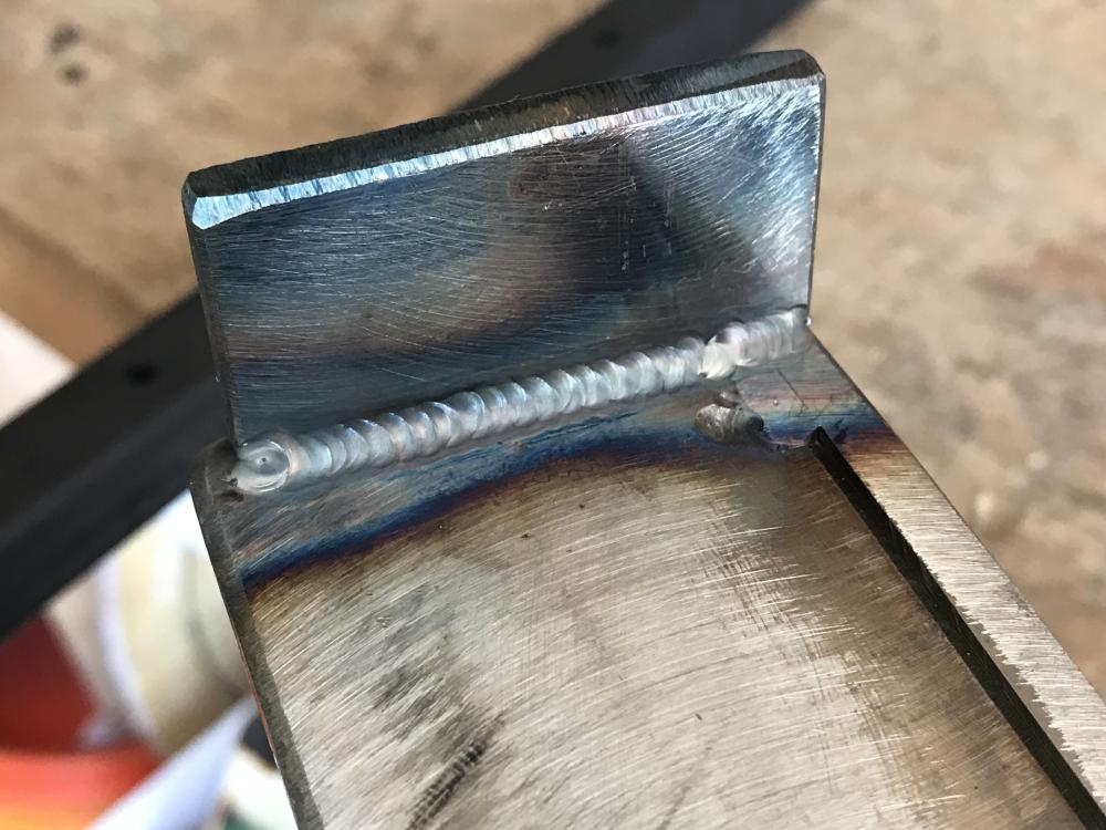

Idk Posted May 7, 2018 Share Posted May 7, 2018 Thanks Frosty. Hope your doing well these days. In reference to the welding, All about determination and the desire to succeed. "COL" should have been "KOL"= Kast-O-Lite refractory. My bad. I was just using stuff I already had around the shop or tucked away. Mike advised as well about the brick. Noted. I'll be needing to add additional rails, etc. for the fuel supply lines. Going with copper tubing, regulator, etc. unless there's a better way. I'm all ears. I'm leaning strongly on making some SS Mickey burners for it since the one I built for the furnace performs so well plus I like the idea of being able to fully open up the air intake manifold to expel the heat after shut down. Don't like the idea of all that heat rising up and upon the actual fuel jet (Mig tip) itself even if it has been turned off. One thing I didn't mention was the chamber dimensions, 13" x 7.5". Still have some fine tuning to do with it, one step at a time. Here's a couple of port plugs I formed and casted out of the KOL. Broke one of the plugs during deforming. My fault. I'm wondering if a good dose of colloidal silicate would weld that suck back together before firing it? Quote Link to comment Share on other sites More sharing options...

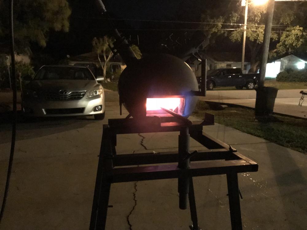

Idk Posted May 13, 2018 Share Posted May 13, 2018 Well Gents, waiting on SS supplies to build my burners for the forge and just couldn’t resist so I stuck the very first 3/4” Mickey burner I ever built in it tonight and here she is. Had to pull the thermocouple probe out at 2100* because I didn’t want it to end up in a puddle. Can only imagine the temps it’ll hit with (2) 3/4” burners in it. Quote Link to comment Share on other sites More sharing options...
Mikey98118 Posted May 14, 2018 Author Share Posted May 14, 2018 You will need to keep them turned down somewhat, or your work will end up as a puddle on the forge's floor Quote Link to comment Share on other sites More sharing options...
