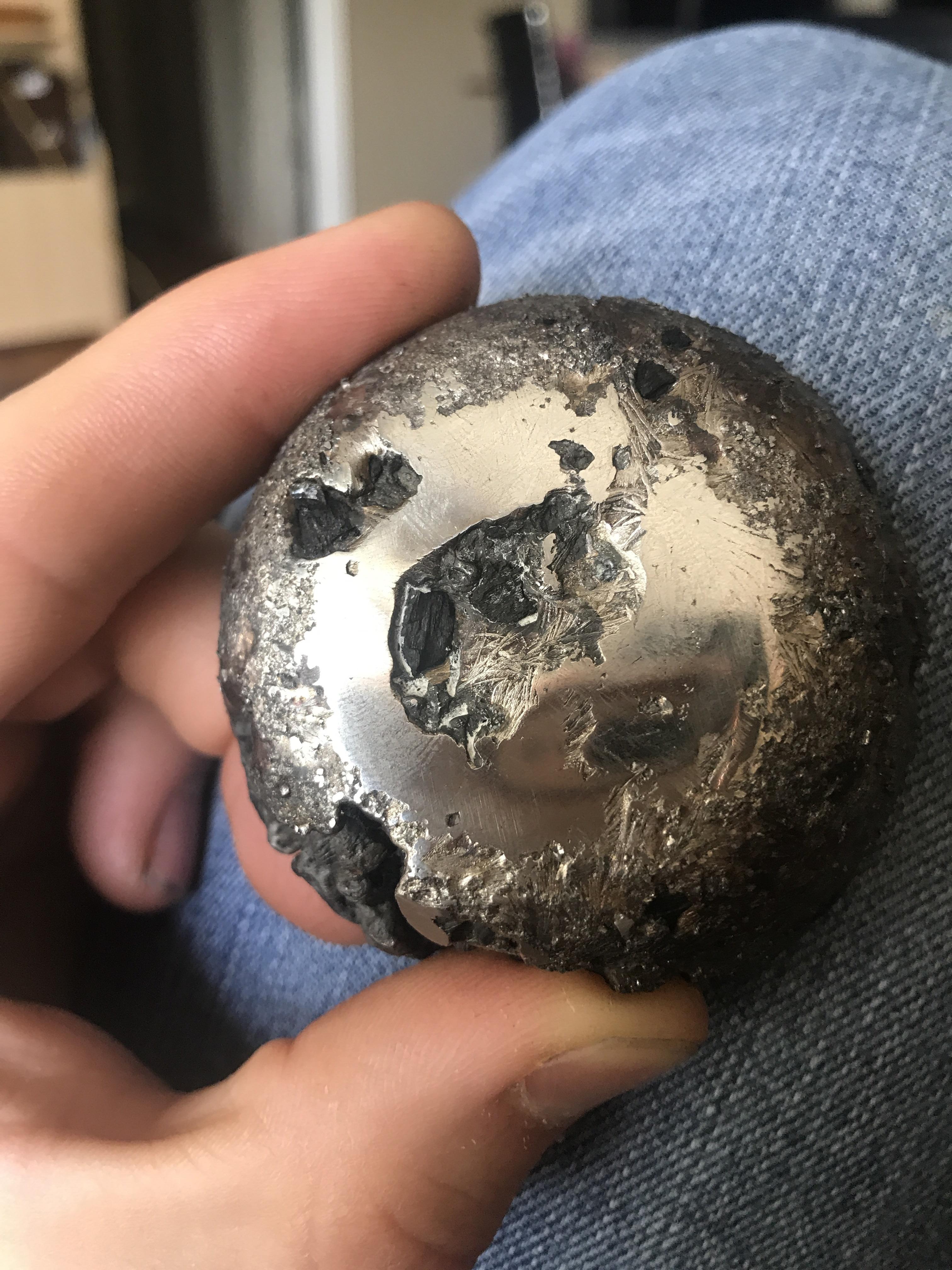

  1. It is definitely not because of the incorrect forging temperatures, but rather the high alloy content

  4. I spark tested it today, and polished up the bottom face to check if there is any visible porosity. Unfortunately my camera didn’t focus well during the spark test, but I’ll describe it; The sparks were dark red, and very short without any visible branching. I compared it to o1, and mild steel which both sparked xxxxxxx a lot more. Then compared to a high speed steel drill bit, which had quite similar sparks however the crucible steel had slightly shorter ones, and less. current thoughts are; due to the saw blades and drill bits used to make the steel, and the other scrap metal/forge scale, it has a relatively high tungsten and molybdenum content, and a medium carbon content. Perhaps the carbon content is slightly low but I’m not sure since it was mostly high carbon steel as input and it was melted under reducing conditions the whole time with a thick layer of charcoal covering, and glass.

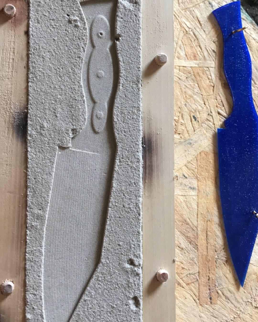

  6. I didn’t use a degasser, I followed some of the recommendations in the ASTM copper alloys handbook for casting bronze alloys with tin. Some of the most important things I make sure of -the sand must have the proper moisture content, just enough to lend the mold strength, but not enough to cause water and subsequent hydrogen and oxygen porosity -I use ground charcoal for deoxygenation, you can’t add too much. -better results may be obtained if it is the second time melting a piece of freshly alloyed metal (the first time from many small pieces seems to have more porosity) not sure if this is 100% true, but it might be. -cast quite hot, I think around 1100c, when you touch the surface of the bronze it should be shiny and very liquid not viscous and not with an oxide layer. This is very key to casting thin items. -I’ve also tried degassing with a green stick of pine. Not sure how this works but the handbook mentions it and it seems to work. -sprue and gate must be properly formed, follow the guidelines in the handbook, later I can update the exact measurements of mine. Here’s a picture of one mold half. 75 grit silica with 10% bentonite looking to get some 125-150 grit to add in as well for next casting

  20. It looks to me like the burner is running way too rich, (even outside the forge) and the mounting tube is too long, preventing adequate airflow to the burner, increasing the problem when mounted in the forge Also be sure to rigidize the ceramic blanket if not done already
