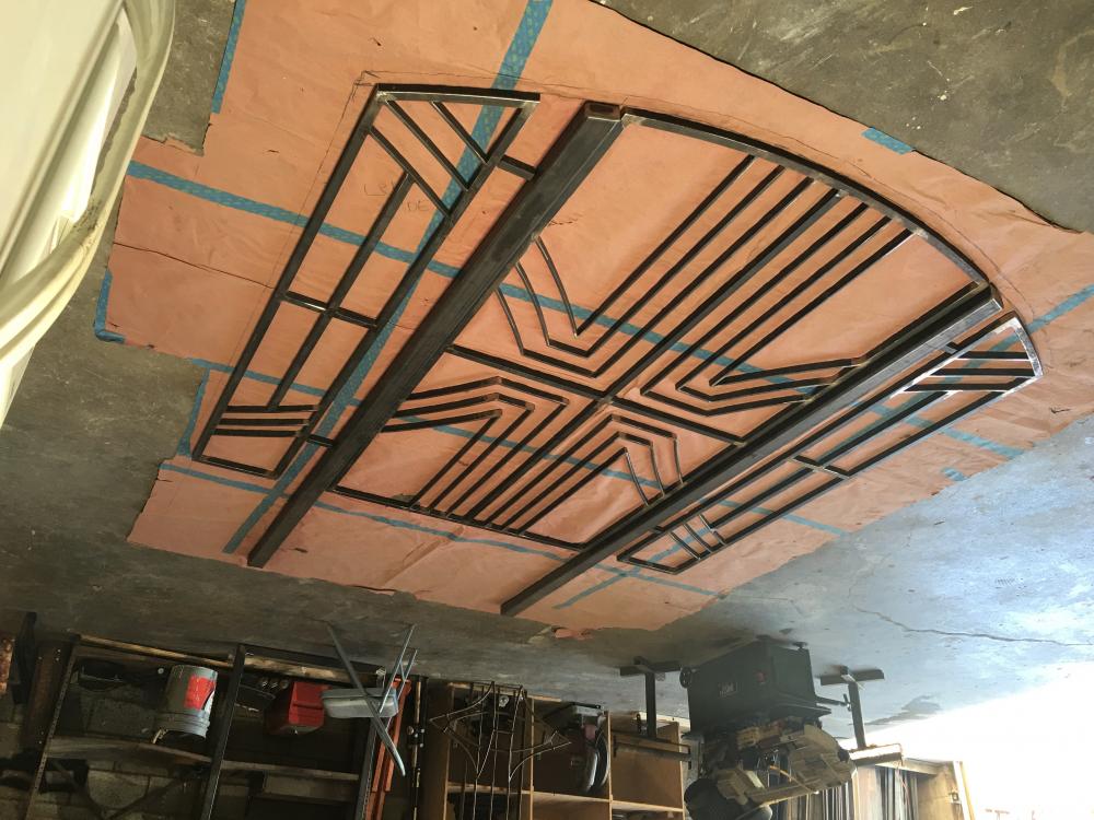

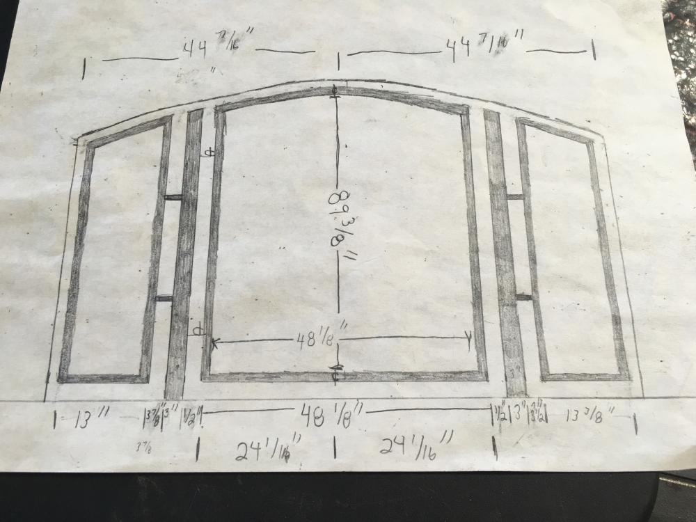

Bmallen77 Posted July 16, 2016 Share Posted July 16, 2016 Gotta gate I'm getting real close to hanging and I am really struggling with whether I have chose the correct posts to mount to, and whether my concrete hole to support the post will be deep enough. I have tried a few post calculators online but can't find enough information to feel confident in my posts. The gate is 8' tall, 4' wide, and weighs almost 300 lbs. the post I chose to hang the gate on is a 2"x3" structural tube post with a 1/4" wall thickness. On the other side of the post is a 13" wide side panel also 8' tall that is welded to the same post. That panel additionally weighs about 85lbs. My initial plan was to set the posts 30" deep in concrete and hang everything off of the post without tying any tabs or anything into the building. It's a large archway and I'd really like it to be free standing without anything tied to the to the side of the archway to support the post when it's under the load of the gate. From what I'm describing and the pictures do you think I'm overdoing/underdoing it? Will that post set 30" deep in concrete be enough to support all that without sag?? You can see in the picture the posts. The left side is where I am talking. The post will have the gate and side panel mounted on the same post together. Quote Link to comment Share on other sites More sharing options...

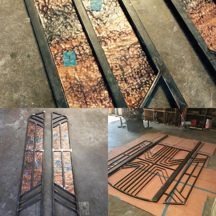

Bmallen77 Posted July 17, 2016 Author Share Posted July 17, 2016 I appreciate all the replies and advice. The gate and side panels are made of 1" solid square bar for the frames and the inner sections of the gate are filled with 3/8"X1" flatbar. There is also some additional weight in copper paneling.In addition to the copper paneling in the side panels, all four open panels of the gate will have copper as well. I added a picture of the unfinished gate so u can get an idea of the weight and distribution of weight. from the specs I have found on the post, structurally the 2"x3"-1/4" wall thickness tube is plenty adequate to support up to 1000lbs with hardly any deflection depending on where the barrel hinges mount. In addition the post will be taking its load mainly on the 3" side of the tube rather than the 2" side. My main concern now is the footing. You see all types of stuff out there about a post being at least 1/3 of its total length in the ground. So for my case, the post is sticking out of the ground roughly 90" so that would mean I need a minimum of 30" in the ground. But It doesn't say anything about that post being under a load of a gate. I really like the landing idea depending on how compacted the ground I'm digging into will be. I think that is definitely something worth adding at least for the shear weight of all that concrete down below for weight. and your absolutely right ironwolf, obviously if that post is not strong to support all that weight then I am SOL. I Guess when in doubt, "nuke it out." Is there no formula or rule of thumb for a foundation for a gate post? I have seen formulas for column loads, but that is only focusing on down pressure, it's not taking into account a heavy item swinging on it 4' away with all that additional leverage. Thanks for the information. Quote Link to comment Share on other sites More sharing options...
