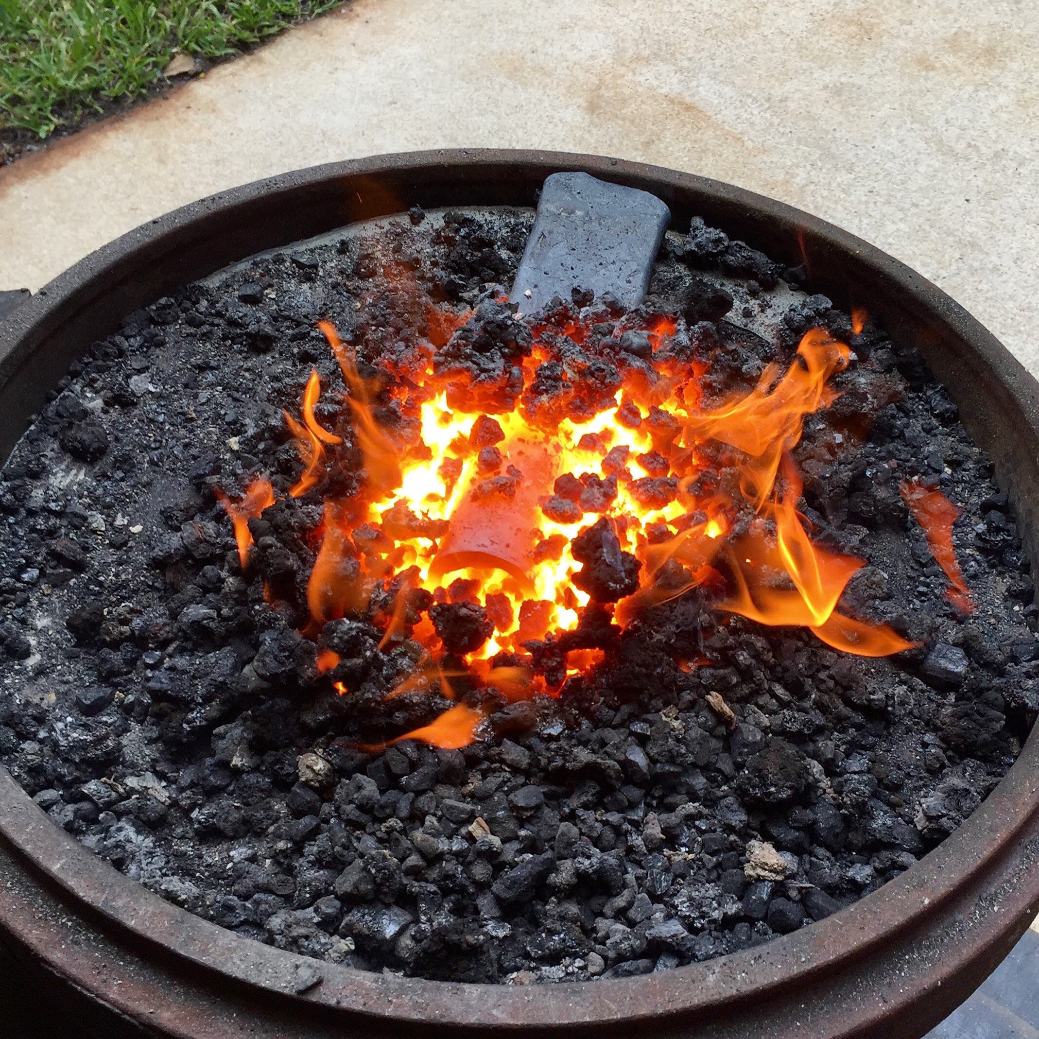

Greetings: New to this forum and was leafing through and saw the topic on brake drum forges - Here's one I did using a Semi truck brake drum - I inserted a disk brake which had a piston sleeve welded to it to raise up the fire pot put wheels and held it down with an old flywheel - it works pretty well but it took some trial and error to get things to go the way I wanted.
I got all this material from my son who is a diesel mechanic - It was fun to build and I use it daily
Can you show us how you heat the center of a 3' long piece in that forge? It seems to me to be missing the slots to put longer work in horizontally.
Nope - you are correct - I started this not having a clue but have been improving it as I go  been hesitant about cutting through 2" of casting - Have been raising the coals to meet the steel bar presently  - Most probably will raise the brake rotor another inch as a solution - want a little bit of lip there to keep everything contained - it's been a trial and error thing - otherwise has really worked well.
How I got around that issue, (using a regular car brake drum as well) was to take a piece of sheet metal and bend it in a circle and let it "snap out along the inside of the brake drum sticking several inches above it's rim as a fence.  it was cut a bit short to allow the opening for the workpiece and then across from the opening I cut a "mousehole" through the sheetmetal just above the rim.  Worked very well for me and I used it as my main billet welding forge for several years.  (Much lighter to move around than a semi drum too)
Yes - over did it on the sizing but it rolls around well enough - That's a good idea. I've been using the handrails I made to support the longer pieces of materials.  Often times with a vice grip clamped to the rail - it has kept things but I like the mouse hole idea

Na, your just looking to cut notches down to the heart of the fire on opposet sides of the big ol' flower pot.
Plunge cut both sides first then cut out the peices.
LOL - It's the right thing to do - I'm just being wimpy.  shuddering about cutting through two inch wall thickness of the casting on either side - that's a big 'ol drum - not your garden variety auto drum - it used to be a rear drive axle brake drum off an old Pete.  Sucker weighs about 150 pounds as is.  Hence I thought, well, let's just raise the fire pot up a little higher - Putting an inch more of that cylinder sleeve underneath it just might be an easier go.

Acualy, cast iron cuts farely easily with a hacksaw, it frills as well (it tends to flake and make dust) so drilling a pair of holes side by side, and cutting down to them, then scoring the other way and knocking out the peice should work.
I bet it's closer to 1/2" at the rim and 1/4 farther down. I have one beside the front step. Makes a dandy flower pot.
I must say, that used the drum as a "box" and bringing the fire ball to the top is a much better idea than what we usualy see, most try to cut half the drum away.
We are blacksmiths, if we wanted to do things the easy way we would be potters.
Halellujiah!  I had cut the cylinder sleeve such that there would be a 1" lip around to hold in chunks of coal that tried to escape the forge.  Well, found that this presents the problem which is now the topic of this discussion - (admittedly it has hijacked the initial discussion presenting what looks like a really nice drum forge made by Forrest Betts.  Adding another inch of sleeve to the bottom should probably be ok - but will make the floor a bit messier as I step on errant chunks of coal and clinkers.  -  you are right - a hacksaw will probably do well and a sawsall an even better option.  Was thinking it could be done in a 'V' shape - that'd maybe hold onto round stock a bit. (maybe)
The 1" lip is a good thing, it holds extra fuel and keeps excaping fuel and embers to a minimum, it just needs notches to allow you to acces the middle of the fire ball with bar stock.

Before cutting the notches find the sweet spot of the fire. No use cutting deeper than that level.
Do not cut the holes in the side of the drum larger than the stock you intend to use. No need for a 4 or 6 inch notch when you only use 1 to 1-1/2 inch stock at the largest. For one thing the fuel will fall out the large notches.

cutting wheel on a 4 inch angle grinder just might do the job in this case - and perhaps its time to buy a sawzall, no?
4" with a cutting blade and a couple of drill bits would do the trick. Drill and then play connect the dots. Clean up the sharp edges with a regular grinding/sanding wheel.
I think your on the right track with cutting notches and having a removable plate (ring with differ t notches?).
4" does sound right - Can't think of anything I do that would be bigger than that anyway.  I guess I should post what I end up doing with that beast - (what was I thinking anyway)
Been tolerating it for a bit now - At times I'll sink as low as bending my stock so it sits down on the fire.  Been loath to cut through an inch of steel casting (or drill through it for that matter)  Hoping the steel removal fairy will visit my forge one night and just make it go away.
