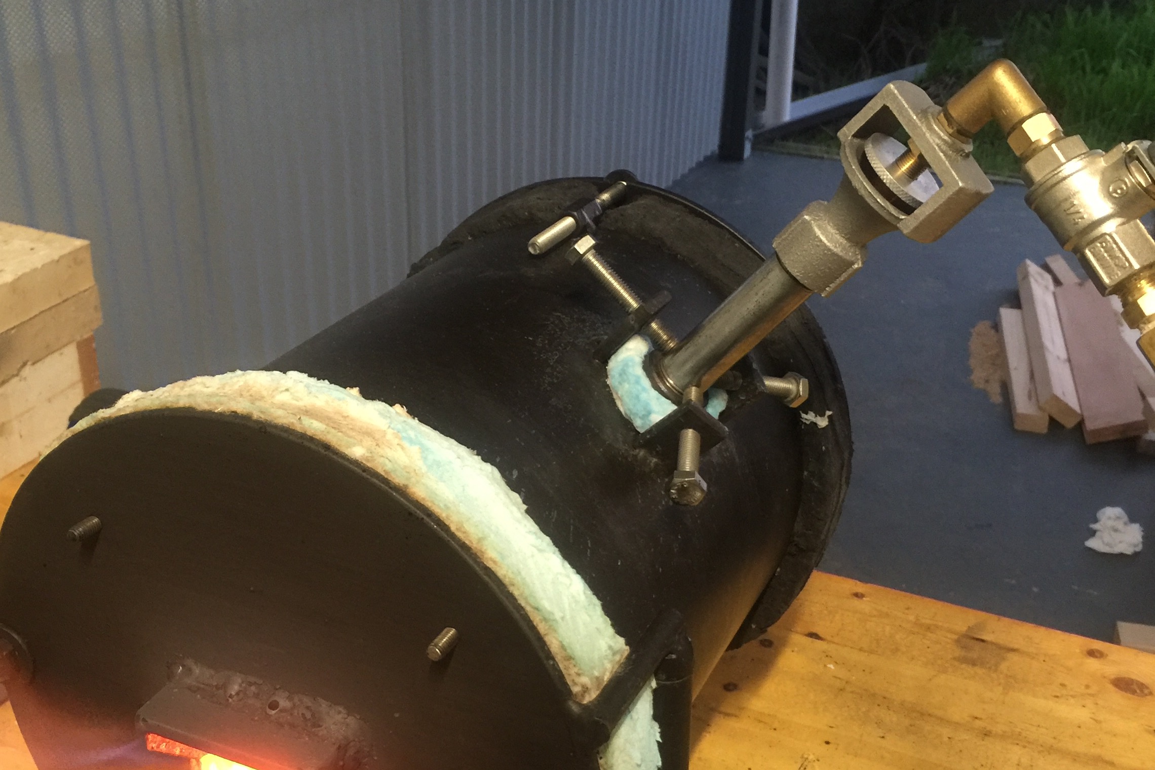

The last couple weeks I have been building a little gas forge.
It uses a 1/2" burner I bought here in Australia.
I used 9" round pipe and lined it with two layers of ceramic fiber insulation and hardener. The forge chamber is 4 and 1/2 inches across and 8 long.
When I tune the burner it works perfectly at 1-30psi.
It all looks to be going well when I put the burner in the forge however when I reduce the oxygen with the choke the burner starts sputtering. At lower pressures the huffing sound is longer between huffs. At higher pressure it still does it but much faster.
I'm wondering if my chamber is too small and causing backpressure? Because when the forge gets up to heat there are quite large flames out the front. Maybe 6-8 inches?
Ive been doing heaps of reading through this forum and am struggling to find an answer. I've attached a few pictures which hopefully upload.

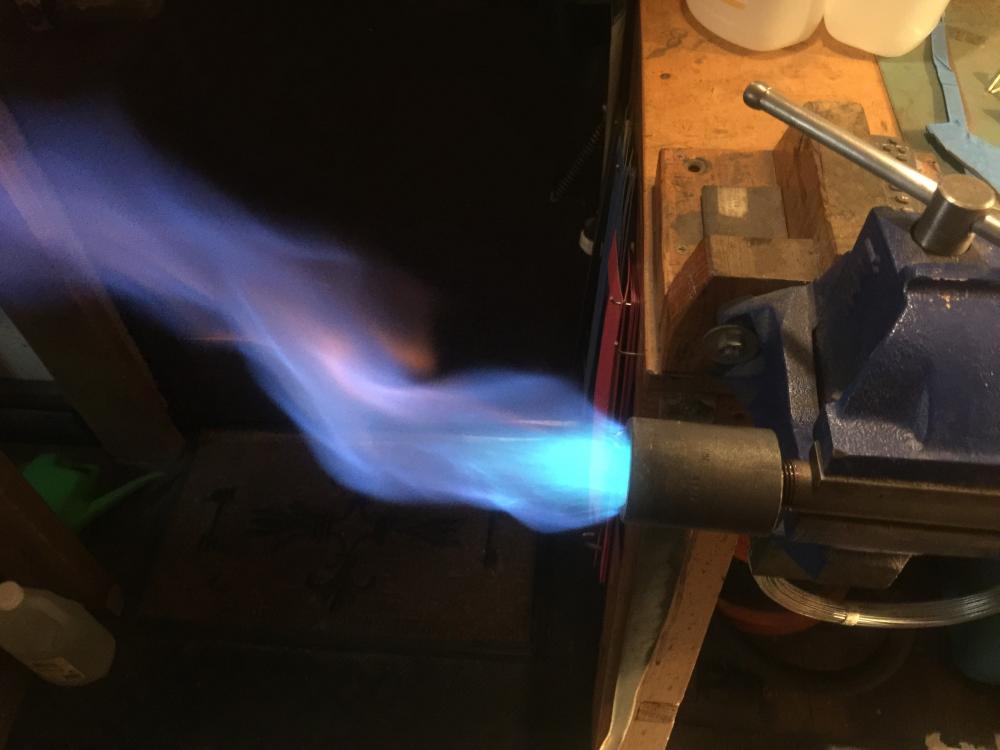

You're seeing two things in the above pics. First is a too rich to VERY rich air fuel mixture running at high pressure. The huffing he's experiencing is probably the burner backfiring as the fuel air mix speed drops close to the flame front velocity. A full blown backfire can be pretty scary sounding.

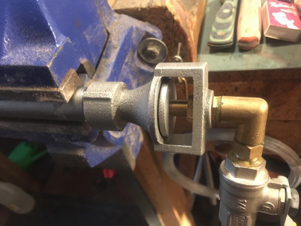

A couple more questions. The hole in the insulation for the burner tip is the same size as the outside of the burner or should it be the size of the inside of the flare tip? Or even taper out the closer it gets the the chamber?
There is a tiny gap around the burner flare, about 1/16 of an inch. Would it run better if I stuff something in there?
The burner gets too hot to touch a long way up the burner and is cool about an inch from the gas nozzle. I probably had it running hotter than I would for normal forging this time though.

I fired the forge up for an hour and a half just now and the burner flare started to flow red hot by the end. I have it sticking about 1/2 inch into the 2 inches of insulation.
I tried running the forge at slightly lower and higher pressure but the burner pipe is still hot at half way up the 6" length. If anything the higher pressure just made the burner flare hotter. I tried running the forge from 6-10psi. Which is when it's roaring loud.
Here's a picture of the closest I could hold the burner tube to the forge.

What is the big cylinder it's screwed into? Is there something forming a flare inside it? It looks to be attached to the forge shell by the bolts through the steel ears.
The way it looks the burner tube makes an abrupt diameter change to what 1 1/2" dia.? If so that isn't a flare it's a design flaw. A diameter change that abrupt will induce turbulence that amounts to a stall and make the flame burn IN the larger piece of pipe and not in the forge where it belongs.
The burner itself is commercially made and shouldn't need more than a little adjustment of the choke plate to operate properly at almost any psi. If that cylinder is part of the burner as sold, call the maker and find out what it's doing there and what's wrong.
How about taking the assembly off the forge and taking a pic inside the burner from the forge end. I'm having real trouble imagining what that thing is.

Corin has them on his knife making website as a forge burner. No mention of handheld. 0. I called them initially for advice before starting my forge build and they offered nothing I already didn't know. But enough of that.
Here is a picture of the top it came with. The 1/2" burner tube screws into the smaller end.

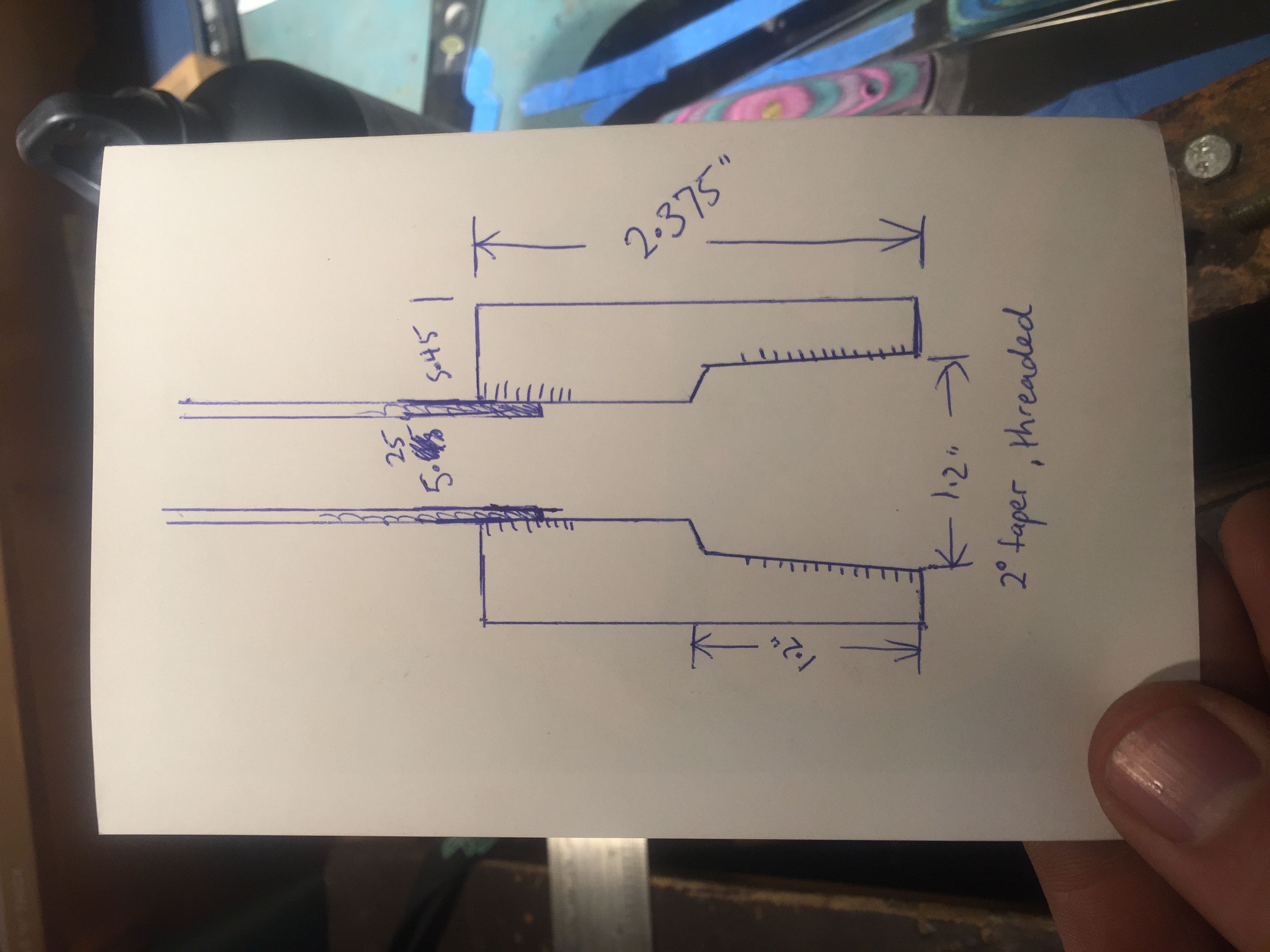

Would a connector to a short 3/4" pipe work as a flare? Would a small step like that cause a slow in the flow speed for a flame to sit at the end?
I also have a metal lathe that I could make something up with a taper. 1:12 ratio I've been reading. Not sure on the length though if my burner tube is already 6" long.

I don't like that . . . THING at all, it extends the length of the tube needlessly and to the detriment of function, then it just increases in diameter to 1.2" abruptly. Both of these "features" hurt efficiency.
Talk to the folks at the local plumbing supply see if they're still getting pipe with steel "thread protectors" and replace that . . . thing on the end with a thread protector. If they don't have steel thread protectors a 1/2" pipe coupler is good. Thread protectors are cheap even free and work well, heck they're throw aways, cost more to ship back than they're worth. The ID of the treads that screw onto the burner tube is plenty of increase to help induction and stabilize the flame just at the end of the burner outlet. The threads actually reduce friction by creating a barrier of still air against them. Its counter intuitive but it. . . is.
I don't use a "flare" all I've ever used is a thread protector or pipe coupler. The one "flare" I turned on my lathe didn't work enough better to make it worth the effort. If you want to make one, set your angle feed to 12* and don't get carried away. I've found deburring the ends of the burner tube improves performance as much or more than any high tech "improvement" I've seen so far.
The length of that tube is much longer than the basic ratio says it should be. 8-9 x the dia. a 1/2" dia burner tube should be 4"-4 1/2" long. There is leeway in the ratio but 6" pushing it. Then if you add the long section of straight pipe in that fitting the total length of the burner tube is long enough to hurt induction. Uh, I'm in danger of starting to repeat myself, I'll close by saying there is NOTHING, zippo, nada, I like about that fitting. I think a burner would work better without anything on it than that . . . thing.
What Frosty said.  I've experimented a little with something like you show and the flame burns inside it.  The way that is held to your forge means most of the actual flame is burning before it enters your forge and is wasting energy heating that thing up and dumping some of that heat into the open air.  I'm guessing that you can actually see part of that piece glow outside the forge when you get your forge up to temp.  I defer to Mike and Frosty on all things NA burner, but I will share a short story here.  I had trouble with a T burner I built blowing the flame away from the end of the burner tube until I got up to a good temp.  This was to the point that it was annoying.  Finally I took the tube over to the anvil and used the horn and light blows to gently and slightly flare the end of the burner tube that sticks into the forge.  Hopefully I'm not making Frosty or Mike cringe too much here.  The bottom line is that improved my flame stability significantly and I'm able to light the burner and bring the propane up to operating pressure immediately without any flameout after making that modification.  Of course it's highly imprecise compared to other methods of adding flares and possibly decreased maximum performance a little, but for me the gain in flame stability was worth it.  Any time I've tried to use a bell reducer or any other fitting on the end as a flare that has an abrupt change in diameter I've always ended up with the flame burning inside the fitting and experienced a decrease in performance (strangely enough just as Frosty and Mike said I would).
I've flared the end of the burner tube on the anvil horn but I had better luck putting a cap on the other end, heating the output end and driving it straight into the horn's end, then dress it as Buzz describes. It was a lot of work but worked. The end of the horn on my Soderfors is round, pointed and smooth so using it for a male die is practical.
The increase in diameter makes the air fuel flow fill a larger volume so it has to slow down which helps prevent it from jumping off the burner. It also increases the vacuum drawing air in. Increase the volume too much and the air fuel mix is moving slower than the "rate of propagation" or "Flame front" of the mix so it burns back into the burner tube.
As I understand it: with a taper in the right "zone" at some point the forward speed of the gas mix will equal the burnback speed and so have a stable flame; and being a taper it allows for some adjustment of gas pressure as the stable point can "slide" forward or back inside it.

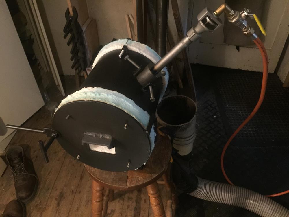

I initially tried the 6 inch burner with a coupler on the end but it sputtered too much. So I bought a 4 inch pipe and with the coupler on the end it would be 4 1/2 inches. It works super well!
I had time to fire it up last night (5pm) for half an hour and the burner tube got warm but nowhere near as hot as the old pipe+weird end.
I was only able to use it for half an hour because the neighbour started shouting abuse about the noise. So my next project is deadening my ringing anvil haha I've bought silicone and plan to add layers between the floor and wooden stand and the stand and the anvil. Magnets made a massive difference initially as well.
A 3/4" tube should be 6" long not counting the coupler or flare. Did you turn up the pressure?
When you change something, experiment with all the settings before you try another change. Changing a physical property of a device often alters the variable settings: psi, choke, etc.
(For instance and do NOT let this example confuse you!! For instance, when I was using a 3/4" TEE I couldn't use a 0.035" mig tip and had to run higher pressure. The intake ports were literally half the area so it took a stronger gas jet to induce combustion air and even then less was available so I had to use a smaller gas jet to achieve the correct ratio. And that's the example I change one thing and two others are altered. Smaller air intakes require a stronger vacuum and still don't allow enough air in so I have to reduce the volume of gas but increase it's velocity.)
You got rid of that thing on the end. Don't start randomly changing everything else! Go to the tuning sequence Fire it off, observe the flame shape, length, dragon's breath, etc. Make notes and compare the to pre-change results for the SAME pressure setting. Tune for the observed results, say there is more dragon's breath and it's more orange. What do you do? It's running richer, maybe open the choke plate a LITTLE BIT, say 1/4 turn. Observe the results and note them.
However if there is more dragon's breath but just a hint of orange turn the pressure down a LITTLE BIT. Observe the results, make notes. compare them to other observations with similar settings.
Have I caused you to lose sight of what you're really interested in yet? The #1 most important initial target you want to see is good working temperature in the forge. So don't forget your goal and also don't forget high temp isn't the only important condition. you can run a burner lean and get really high temperatures but you'll scale you steel to nothing quickly so you need to trade a little hot for carburizing atmosphere in the forge so it doesn't bur your work right up.
