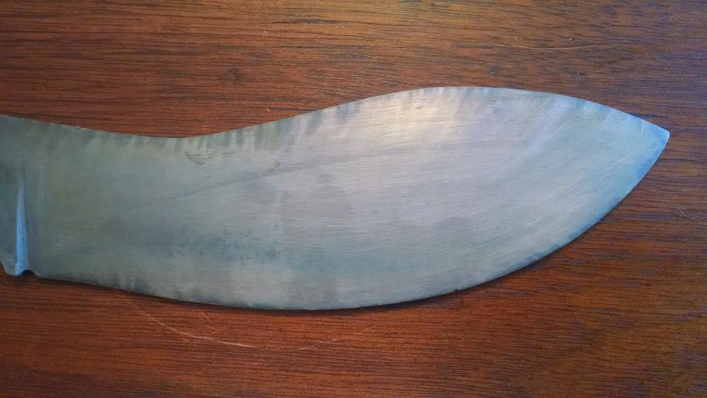

I threw a Nessmuk WIP blade into the coffee yesterday to see what would happen. This was originally a John Deere lawnmower blade, probably something like 5160. One side came out a nice even grey; the other had this funky tiger-stripey effect around the edges.
Well, that didnt turned out as dark as it should(?)...5160 has 0.6% carbon, after forging You have some carbon loss, maybe 04% remaining....that is too less carbon to make the blade really dark with coffee.like I already posted, You need a good amount of Mangan and/or more carbon.
Well, this wasn't really a serious test, more a "Hey, let's give this a try" kind of thing. I don't even know for sure what the alloy composition is for the blade, although given how well it hardened, I'm pretty sure there's more than 0.4% carbon.
DIDN'T you have someone hold your beer?  <sheesh> What did you expect? :rolleyes:
Daddy always warned me never to drink and patinate.
No, I think he said not to drink THE patinate.
Its all about even sanding even the stuff that we cant really see. Or maybe a blemish in the steel from john deer. Sand that baby down to 800 going with the grain of the steel. Id also try blueing if your going for darkness or just wait for the carbonation from the heat treat, just netflix and sand.
Also i like to soak in motor oil overnight after and etch to help with the dullness.
