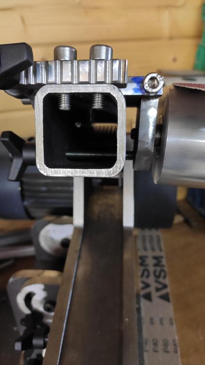

  1. Here is a little update after some hours of usage. Since day one i had tracking issues. The belt was moving most of the time and i thought the tilting mechanism was responsible for that. Due to the fact that I used a standard threat the adjustability was not fine enough and due to vibrations it unscrewed itself during usage. I tried adding additional springs, nuts, locknuts to get rid of the self loosening effect but never really got it fixed. But I kept working with that situation until i got a small wheel attachment. With this the belt cuts into the small wheel holder when the belt moves to far left/right. Then I saw this video from Brian and tried that way of tracking because i already had build that mechanism but didn't used it. Link removed due to advertising This helped a bit but still to much belt movement. Then i took the tracking arm, tracking mechanism apart and double checked wheel alignment/positions. I could reduce the clearance of the tracking arm and the tracking wheel by adding washers. Additionally the position of the tracking wheel was of by 2 mm / 5/64''. The axle of the rubber wheel for the small wheel attachment was out of angle. I added a width across flat to turn the axle and adjust the angle with a digital angle meter. After everything was aligned... no big improvement... I checked everything again and found no major errors. It took quit some time to find the error. The screw holding the tracking mechanism to the tracking arm was locked to tight and the small modifications didn't transfer directly to the tracking wheel. Instead the system flexed until friction was negotiated and the a big adjustment was transferred to the tracking wheel. As soon as I loosened this screw tracking works as expected. Still I'm very happy that I build this 2x72'' and it gets used more and more often. The next project is already in planning. I want to build a heat treat oven and because it needs some welding I will take this opportunity to buy a stick welder and try welding it on my own.

  20. Hi guys, Yes I like to do things on my own but the torsion springs are 4$ a piece and so I won't try to rework it. The new ones are also less then half the width of my actual one. So I will order two and can decide if I need one or two for proper tensioning. I don't have a welder and I also can't weld myself. But if have some friends who can weld and they will help me. And yes I will use fine thread nuts. The idea is to weld one nut in place, screw the screw in and then screw the secon nut on applying a little pre tension. Maybe this can also help with the self-loosening. But I will also order a concentric spring to have another possible solution. End caps are also planed but I couldn't wait to start a test run Yes it is a TEFC, 3 HP, 2860 rpm motor with an 8'' drive wheel. So power won't be a issue. I just need to learn to handle it. And tweaking was expected and is also good to understand how the machine reacts.

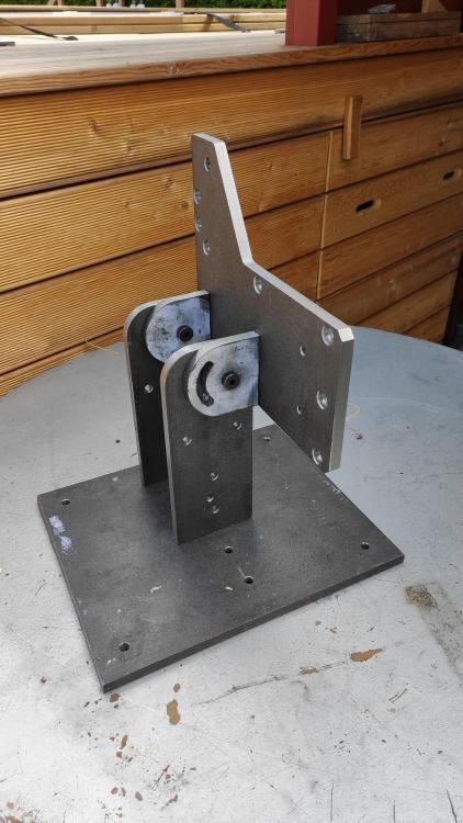

  22. First test assembly. Starts looking like something: Still a lot of work to do but I'm happy with the progress.
  23. Hi there, slow and steady I'm making progress. But I had to change my process because I busted the carbide blade somehow. Didn't changed the pressure or something else but somehow on the last cut the blade lost 5-6 tooth. Now I changed to pre-drilling and then cutting with a standard metal blade and it works pretty good. I finished rough cutting the two raisers, one hinge, the flat platten, the workrest and one part of the tracking. For the big side plate I got some help from my dad's colleague. He did the big 130 mm / 5'' hole on a mill. He also did one pass on the outside profile of both side plates. So they have the same profile and are looking great. Greetings!
