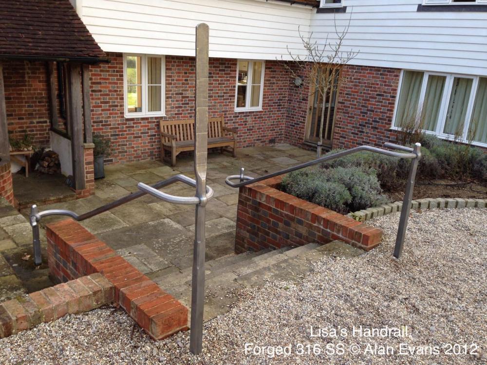

Alan Evans Posted May 22, 2016 Share Posted May 22, 2016 5 hours ago, the iron dwarf said: on stainless you could try using a pickling paste to clean the surface after forging or welding to prevent rusting I hesitated to mention pickling paste...it is horrible stuff to handle. I think Hydrofluoric Acid (anybody doesn't know, look it up) is the worst thing I have in the workshop. It just eats its way through you. I agree Pickling paste is a very effective scale and contamination remover and provided you can sort the PPE and the environment contamination it can leave a good finish on stainless.This handrail was left from the hammer with a coat of wax initially... but the wax was not re-applied frequently enough to prevent the rust staining, so I pickle paste passivated and re-waxed it on site...took me a day and a bit. The handrail and stanchions were forged from 50mm (2") square 316L. The octagon section handrails taper from 50mm AF to 30mm AF over 3 metres (10') so it has been subjected to a few heatings and bashings. Alan Quote Link to comment Share on other sites More sharing options...
7A749 Posted May 22, 2016 Share Posted May 22, 2016 That's some beautiful work Alan. Quote Link to comment Share on other sites More sharing options...
Alan Evans Posted May 22, 2016 Share Posted May 22, 2016 2 hours ago, 7A749 said: That's some beautiful work Alan. Thank you. Hopefully it is an appropriate and useful example for the OP and the thread. Alan Quote Link to comment Share on other sites More sharing options...
7A749 Posted May 22, 2016 Share Posted May 22, 2016 It sure is easy on the eyes whatever the case Mr Evans! Quote Link to comment Share on other sites More sharing options...
