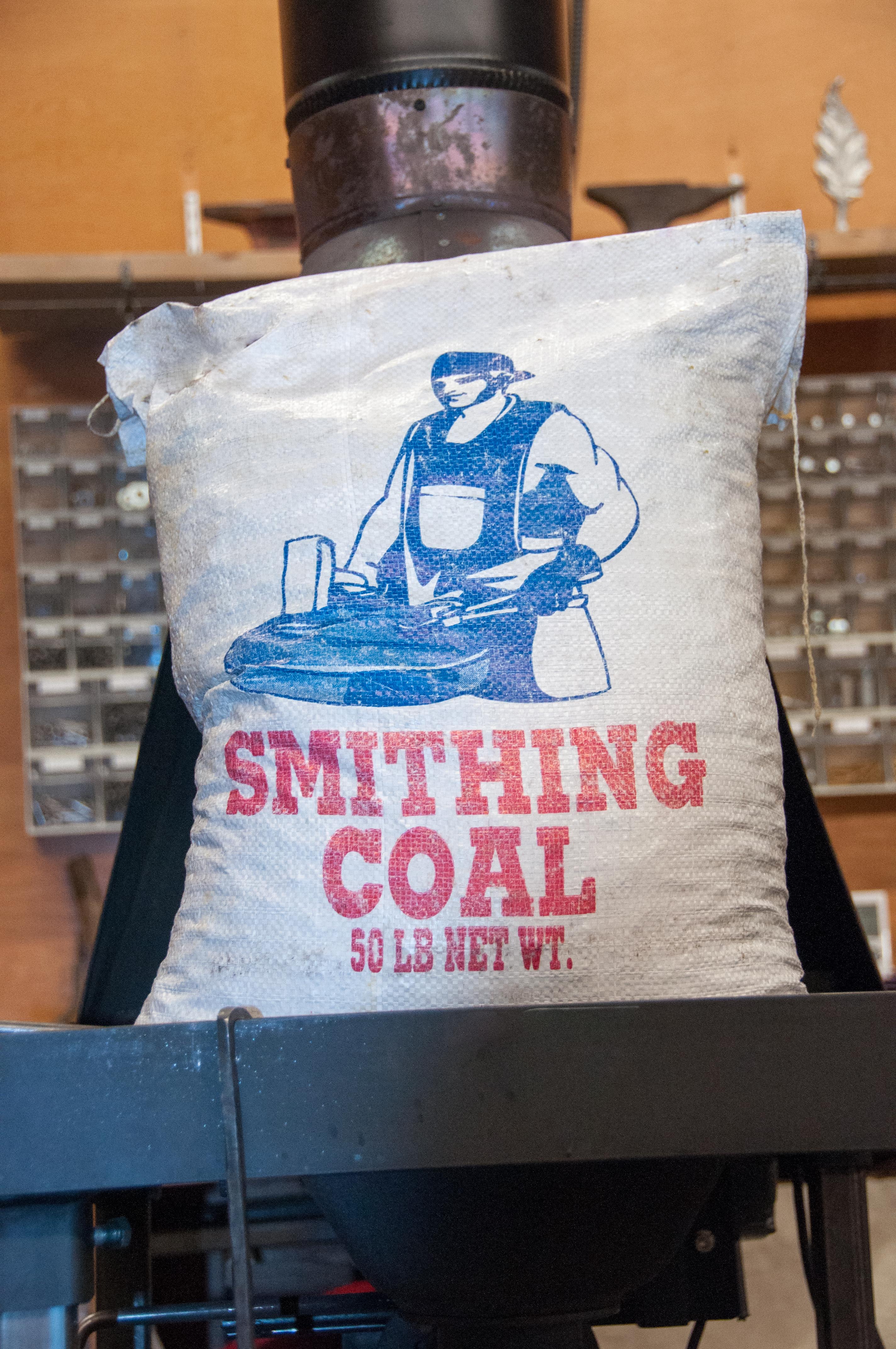

  10. I'm sure the green vs red bags means something more than just different ink. Thanks Glenn for your reply. I'm going to track this down further.
  11. Hey folks, My standard smithing coal is pocahontas #3. 50lb bag with the blacksmith at anvil graphics (see pic). The writing on my old bags is red. It was great stuff to work with. I received a new skid and the bags have the same picture but with green writing instead of red. I used a bag today and it seems to smoke more when coking up, seems more greasy in the bag, chunks are more porous and also has a nasty, gooey tar-like gunk when coking up. The coke itself seems lighter than the coke from the other bags. Does anyone know the difference between the two bag styles and what the heck I'm working with? Thanks, Randy
