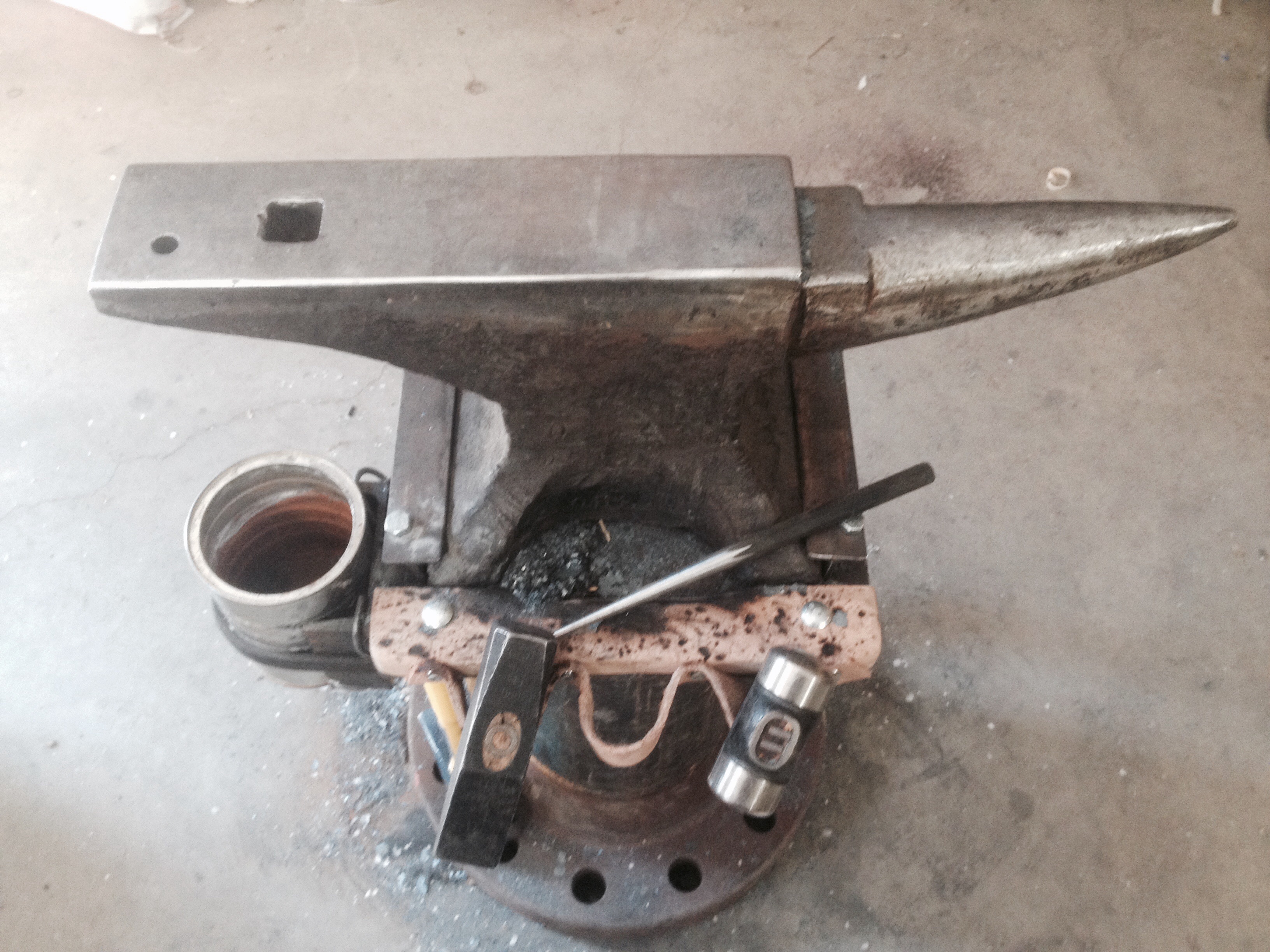

Figured I would ask the masses opinion on this. I have had my anvil for about 2 years and about a year ago cleaned it up I ground the face down a bit to remove the dish in the center and cleaned up and dressed the edges. I am quite happy with it, it weighs about 100/110 lbs and is mounted very solid to a good base. Performs quite well for its size. So here's the question, I am getting to the point where I would like a heavier anvil but don't particularly want to pay for it Canadian dollar sucks right now and would be quite expensive. I have another anvil available to me but I would have to trade for it, problem is the front most used edge is quite damaged and would have to be repaired by welding. The advantages are that the face is about an inch wider and the anvil is about 50 lb heavier. The rest of the anvil is in average condition for an ol anvil it is just the one edge that is in quite poor condition. So what is your opinion on what is better an anvil with a properly dressed face that has never been welded on but is smaller and lighter or one that is heavier and has a bigger face but has had weld repairs done to it. I would be repairing it to Rob Gunters procedure and I have never repaired an anvil before but I am a professional pipefitter and work with weld procedures often and have acess to the proper equipment and people to do a proper repair.

This is my current anvil I don't have a pic of the other one
What is the larger anvil going to do for you?  How is it going to make you better?  What projects will it allow you to do that you can't do on your current anvil?

A dish facilitates straightening work by allowing it to be over bent so it will rebound to true. Another even better way to straighten is on the side just under the face plate. This lets you sight down the work so you know exactly where to strike. You ARE using a wooden mallet to true your work yes? Truing up on a flat face involves knowing exactly how high to hold the work off the anvil face to correct for rebound. This is a MUCH higher level of skill and experience. I use a wooden mallet (yard sale wooden baseball bat turned into a mallet) on a birch block. This allows bending manipulation without altering forged features.
If one whole side is blown out it may be just what it needs. It's not my anvil nor can I lay my eyes, hands, a little hammer and or ball bearing on it so I can't realistically asses it's need or chances of surviving the experience.
And yes, striking an arc on a piece of hardened high carbon steel WILL alter it's heat treatment. The Gunter method is the one I've used on those occasions it was a choice between the owner just doing it or me doing it as right as possible. The preheat and post heat BELOW actual tempering heats minimizes thermal shock along the margins of the Heat Affect Zone, HAZ.

I was leaning towards keeping mine I am fairly happy with it my main reason for wanting a bigger anvil was weight as I currently do not have a power hammer I figured the extra 50 lb would move metal a bit more efficiently. I would love to have both but don't think that will happen. As far as just turning it around I use the close dressed edge quite a lot also so I would be loosing that ability, would rather have both edges dressed. (Frosty) did not think of the dish that way point taken, and yes I often straighten my work with a rawhide mallet not wood but close. And yes I know it will affect the heat treat but I though the extra weight may offset the slight loss in rebound. But all things considered i will probably use my current one and save up for a 200 lb er and keep my 100 also. It's just a shame that the other on is just gonna sit in a shed. If I could have both I could just really round over the edge of the bigger one and use it for drawing out stock oh well more insentive to build a power hammer.
