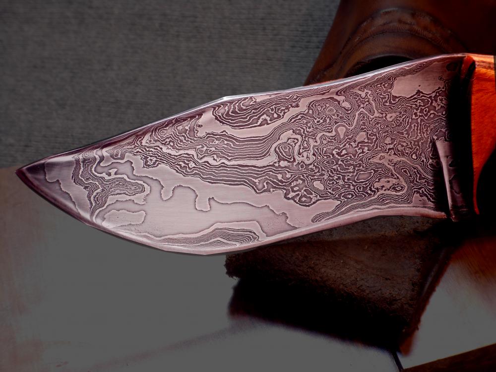

HEAP of JEEP Posted April 5, 2016 Share Posted April 5, 2016 Here's my latest effort. I think this is my 6th knife overall... maybe 7th. With all the hammering, I've lost count. I started this one as a commission for another Jeep guy. He wanted a knife made from steel off of a Jeep, so I got a deposit and started a billet. He ran into some financial problems a couple of days later, so had to cancel his order, but I got to keep the deposit and since I was already well on my way, I just decided to finish it.... maybe I can sell it to some other Jeep guy. Its a total of 283 layers. I made the billet from the leaf springs and 15n20. Every time I cut and folded, I sandwiched another layer of 15n20 between, just so I wouldn't have to deal with trying to weld the leaf spring (5160?). When I got to 140 layers, I gave it a good twist, then I treated it like sort of like a san mai blade and put a layer of 1080 between two layers of 15n20 and then the leaf spring billet on the outsides. So, with the 1080 running down the center, it should have a pretty decent cutting edge. The handle is from a tiger wood flooring sample from Lowes. Its not my favorite pattern that I've done, but the overall shape of the blade along with the fit and finish tell me I'm making some pretty good improvements. On to the next, I guess. Quote Link to comment Share on other sites More sharing options...
Robakyo Posted April 5, 2016 Share Posted April 5, 2016 Wow, that's fantastic! Very nice pattern too. Quote Link to comment Share on other sites More sharing options...
billyO Posted April 5, 2016 Share Posted April 5, 2016 I, too, like the pattern. Good idea on adding material in the middle of the forging to give wider layers. Quote Link to comment Share on other sites More sharing options...
orange Posted April 5, 2016 Share Posted April 5, 2016 Its a beautiful knife and nicely made. Are you worried about the thin piece of wood coming past the finger guard. Looks like a bump would chip it off. Quote Link to comment Share on other sites More sharing options...
HEAP of JEEP Posted April 5, 2016 Author Share Posted April 5, 2016 3 minutes ago, orange said: Its a beautiful knife and nicely made. Are you worried about the thin piece of wood coming past the finger guard. Looks like a bump would chip it off. Yup, very worried... hindsight being what it is, and all. I'm still learning though, so chalking that up as a mistake that won't get repeated in the future. Quote Link to comment Share on other sites More sharing options...
Steve Sells Posted April 5, 2016 Share Posted April 5, 2016 if you can remove the scales, add a 10 gage or so guard, along the leading edge, so it wont take away from the looks , but will help support the wood, before it gets broken off, which would be a shame, has good lines. Quote Link to comment Share on other sites More sharing options...
TheoRockNazz Posted April 5, 2016 Share Posted April 5, 2016 I really like the shape you've got there. The layering is looking great; seems like the san mai core drifted but it shouldn't matter since the whole blade is made of good steel. These last couple knives of yours have been real leaps and bounds, keep on forgin Quote Link to comment Share on other sites More sharing options...
Momatt Posted April 5, 2016 Share Posted April 5, 2016 I like it. Its a nice enough blade its worth fixing the scales Quote Link to comment Share on other sites More sharing options...

Jonah k Posted April 7, 2016 Share Posted April 7, 2016 Nice I like the bold clean stitching on the dark leather. Also the pattern on your knife is really cool with the inner complex patterns surrounded by thick borders. Is the billet welded under power hammer, press or by hand. Quote Link to comment Share on other sites More sharing options...
HEAP of JEEP Posted April 7, 2016 Author Share Posted April 7, 2016 6 hours ago, Jonah k said: Nice I like the bold clean stitching on the dark leather. Also the pattern on your knife is really cool with the inner complex patterns surrounded by thick borders. Is the billet welded under power hammer, press or by hand. Right now, its all done on the anvil. If I keep improving to the point where I could reliably sell some knives, I might invest in a press to save my arm, but for now, its all by hand. Quote Link to comment Share on other sites More sharing options...
