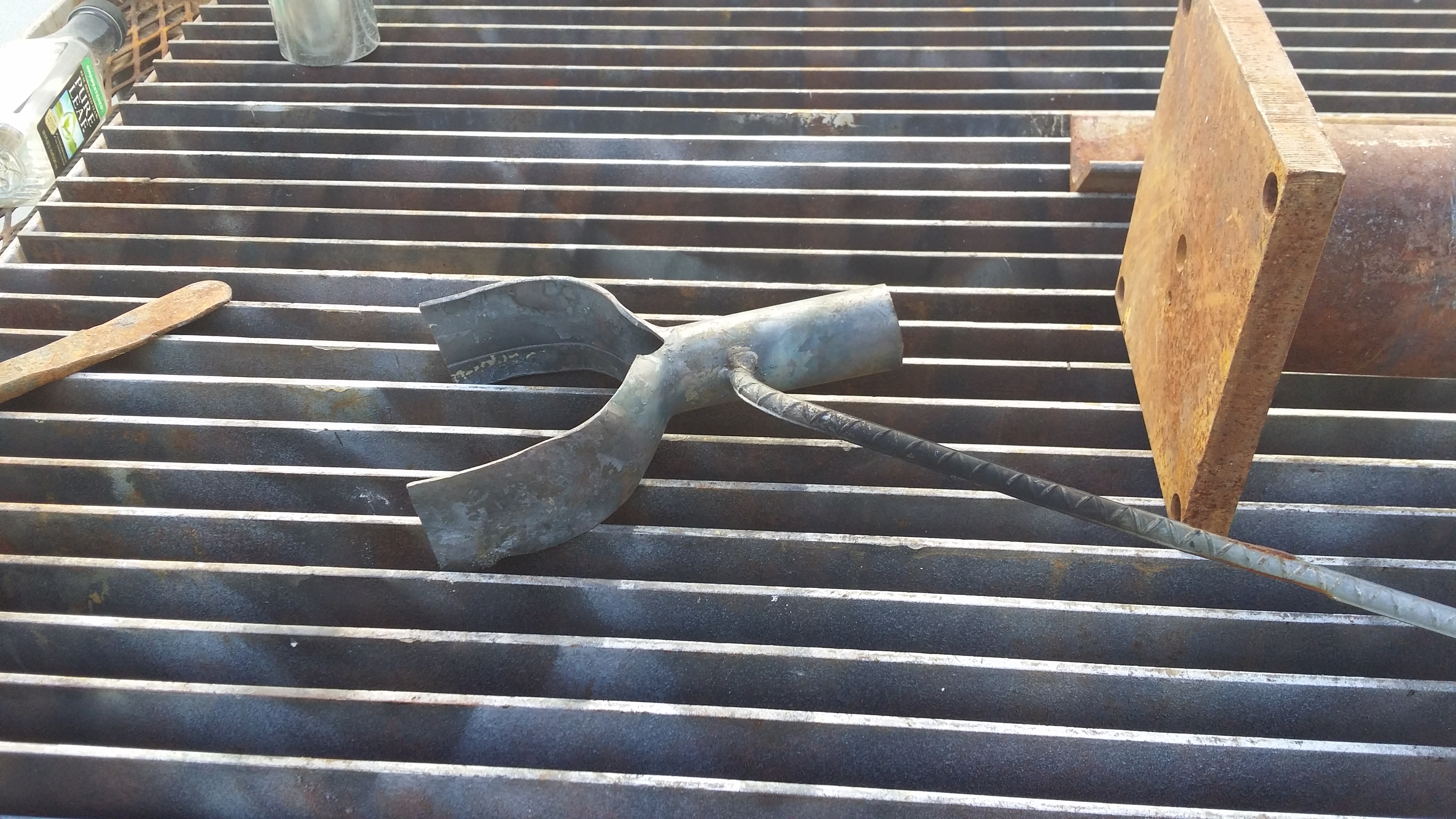

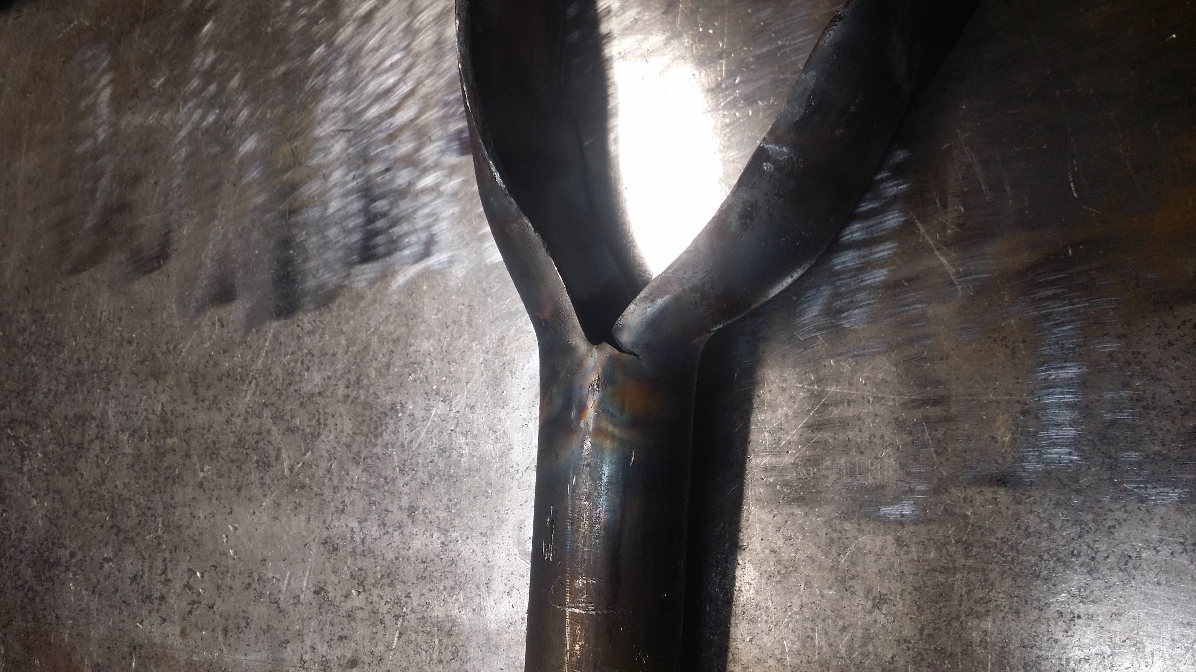

Trying to make a "D" handle for a scoop shovel. I started with a piece of 1.5" 10 gauge tubing because I have a bunch and it fits the shovel. I did some of the heating with OA to try and localize where I wanted it to bend. Everything was going fine till she cracked. I was trying to spread it open on the horn and probably didn't have enough heat where it cracked. Also the horn doesn't seem too well suited for evenly opening it up, it wants to twist. I have some heavy wall 2.5" pipe I may try in place of the horn. Thinking about mig welding the crack and continuing on. Any advice welcomed.

The material you are starting with is exhaust tubing. It's strength is low.
Neil

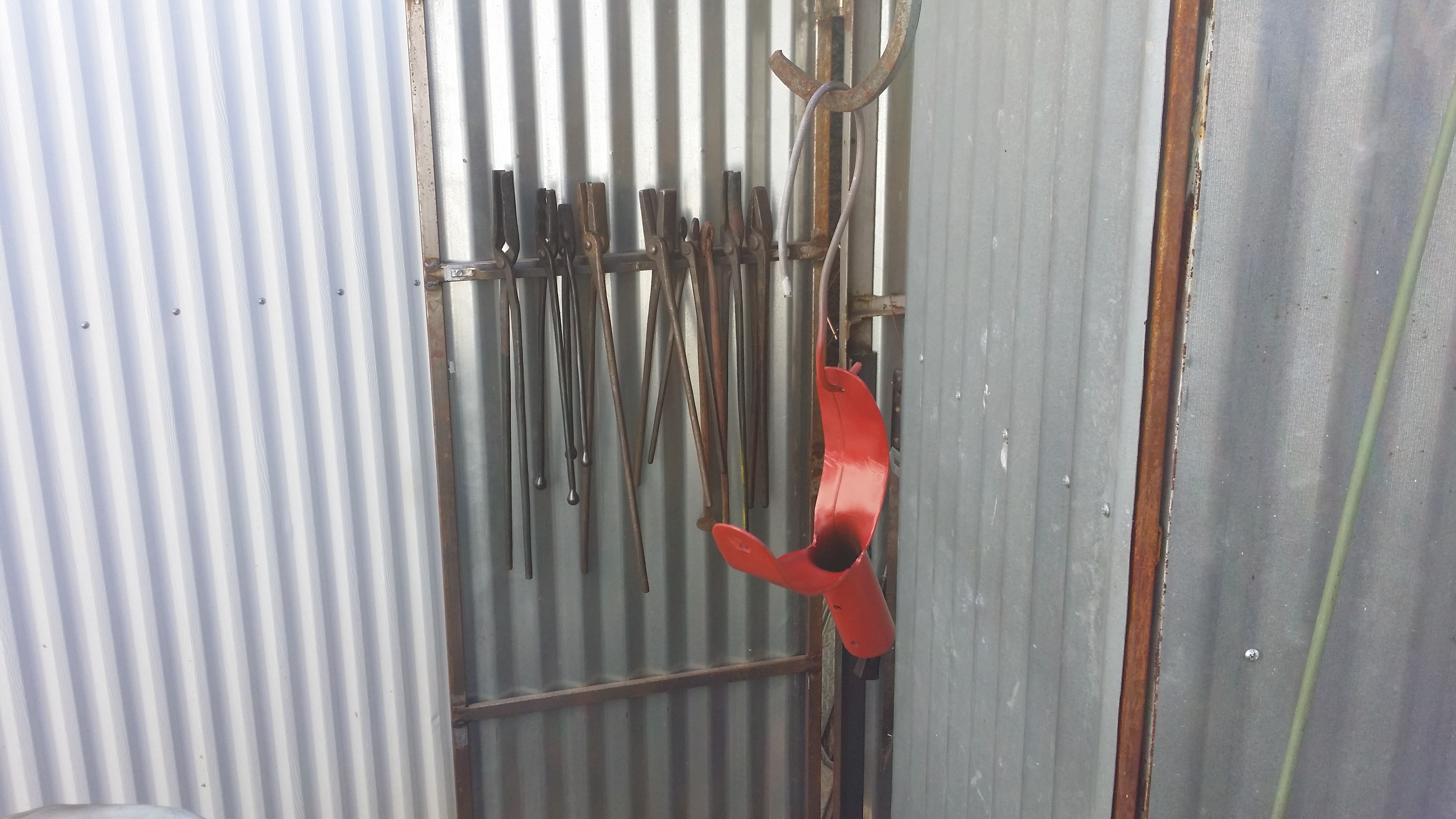

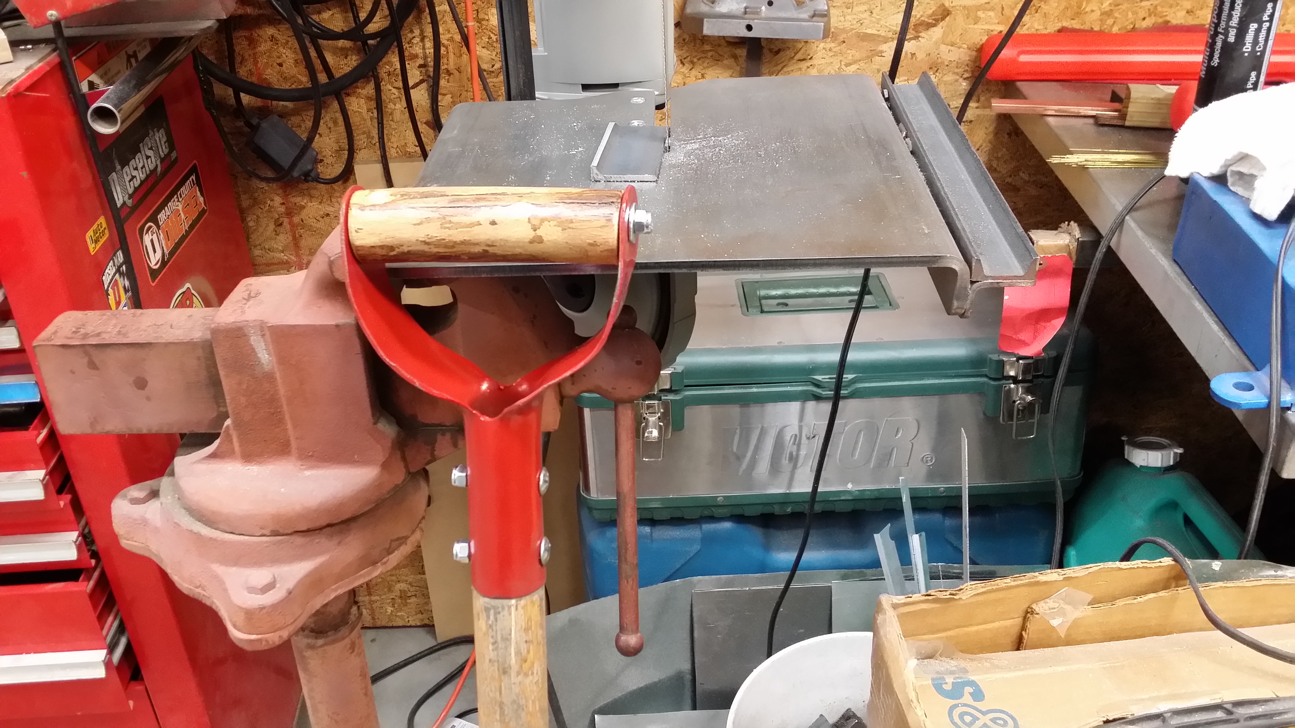

Success!
56f88bcd03f66_2016-03-2710.18.01.thumb.j
I knew this piece of scrap I got at the yard would come in handy someday.
56f88bda218cc_2016-03-2710.18.08.thumb.j56f88c156d8e6_2016-03-2714.29.10.thumb.j

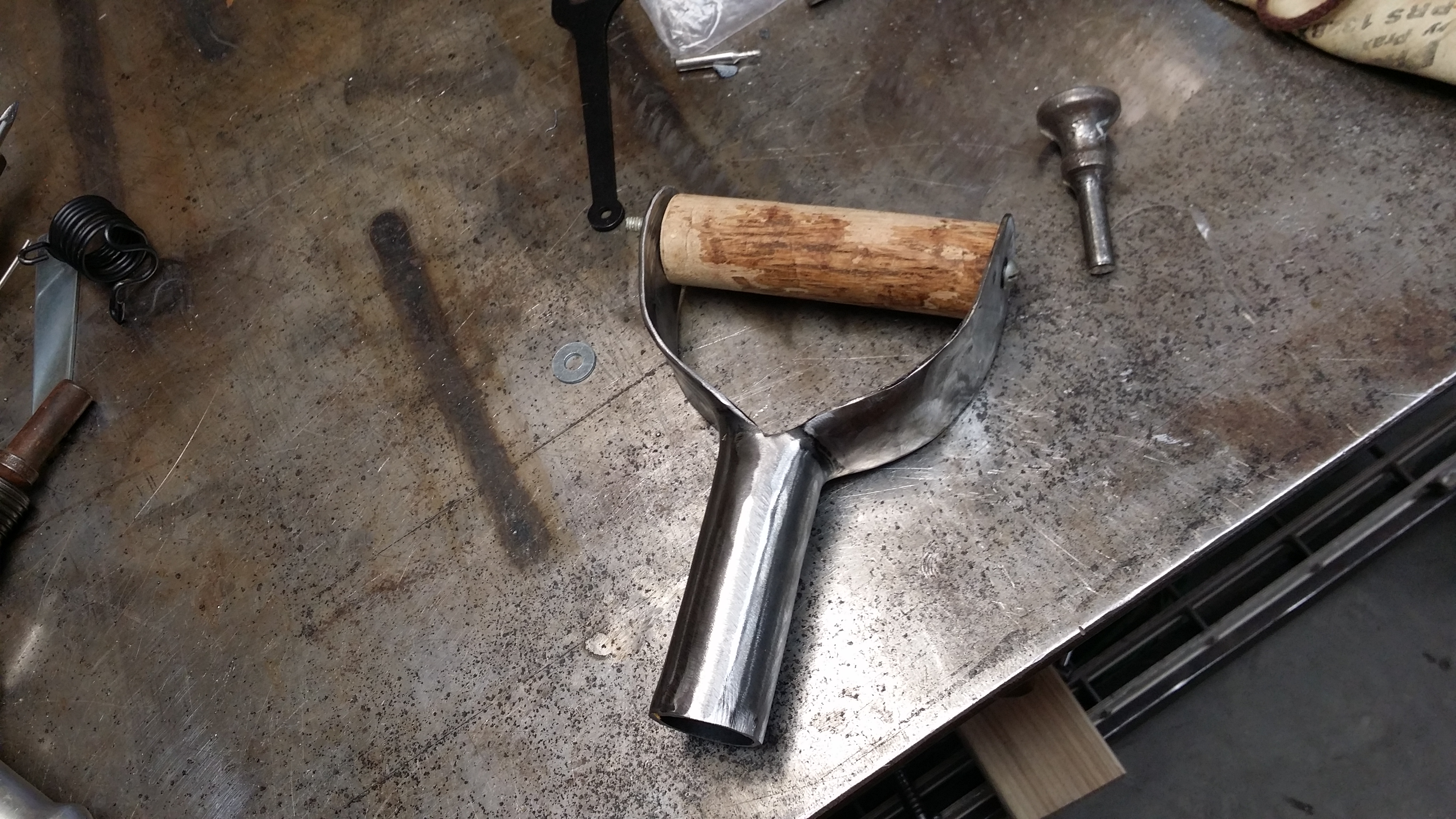

And a nice piece of varnished Arizona Mesquite off one of my own trees for the grip, with a little curve for comfort.
56f88c89ab396_2016-03-2715.22.44.thumb.j
56f88c90e8723_2016-03-2718.01.33.thumb.j

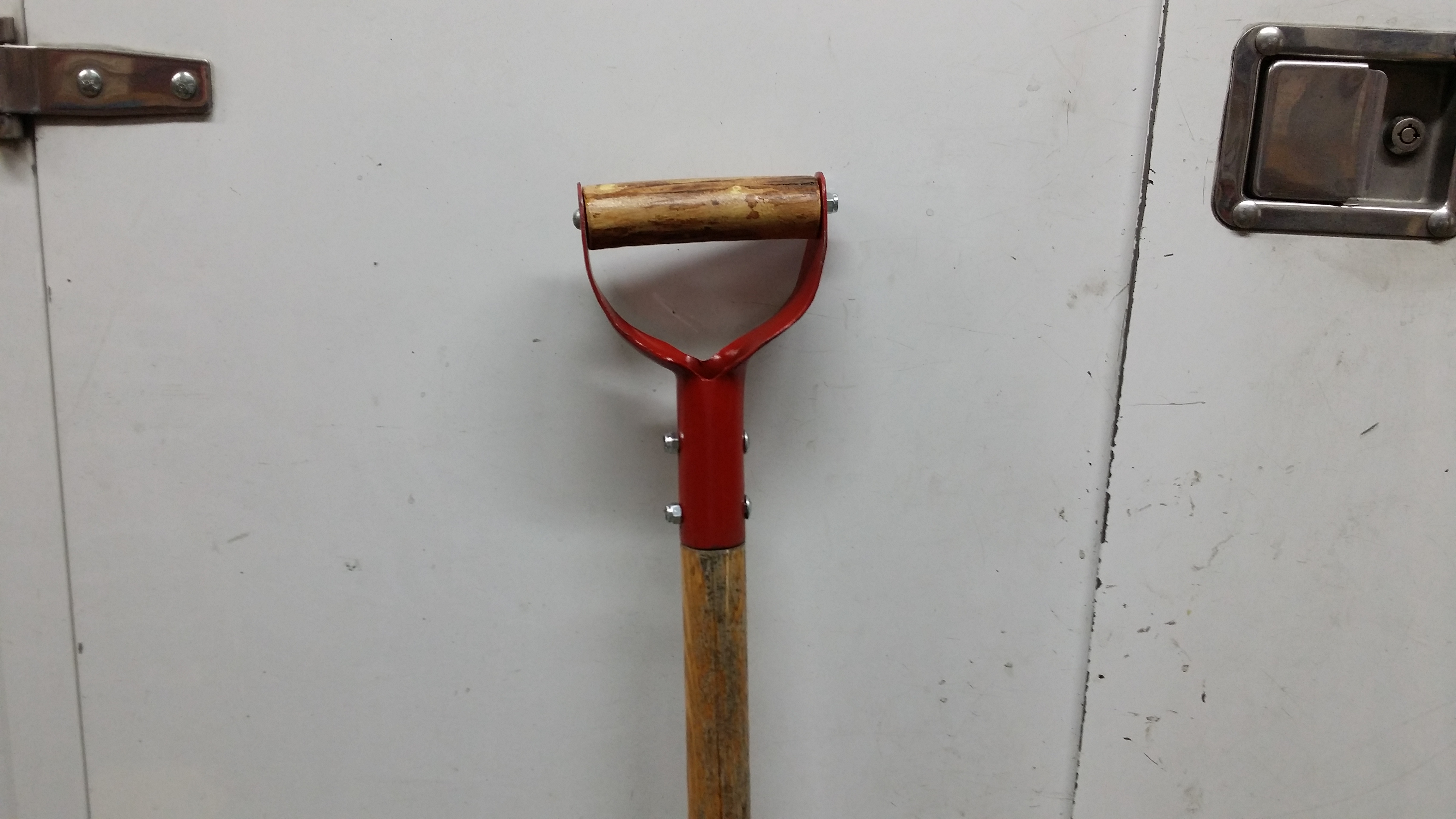

I wanted to do rivets but after an hour or so practicing on scrap with limited resources and no real rivet tools I decided that this would be bolted.
56f88c974309b_2016-03-2718.02.18.thumb.j

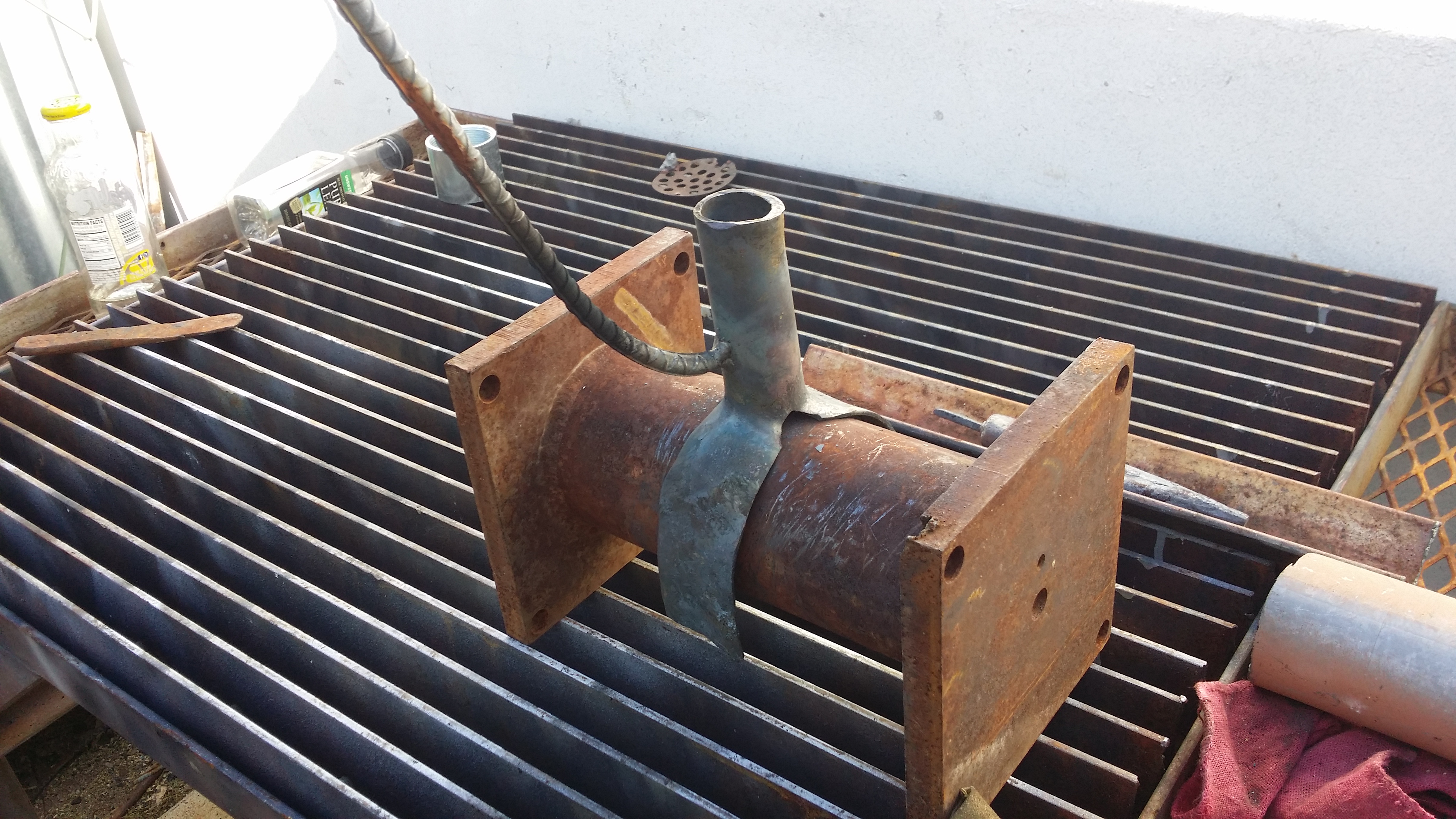

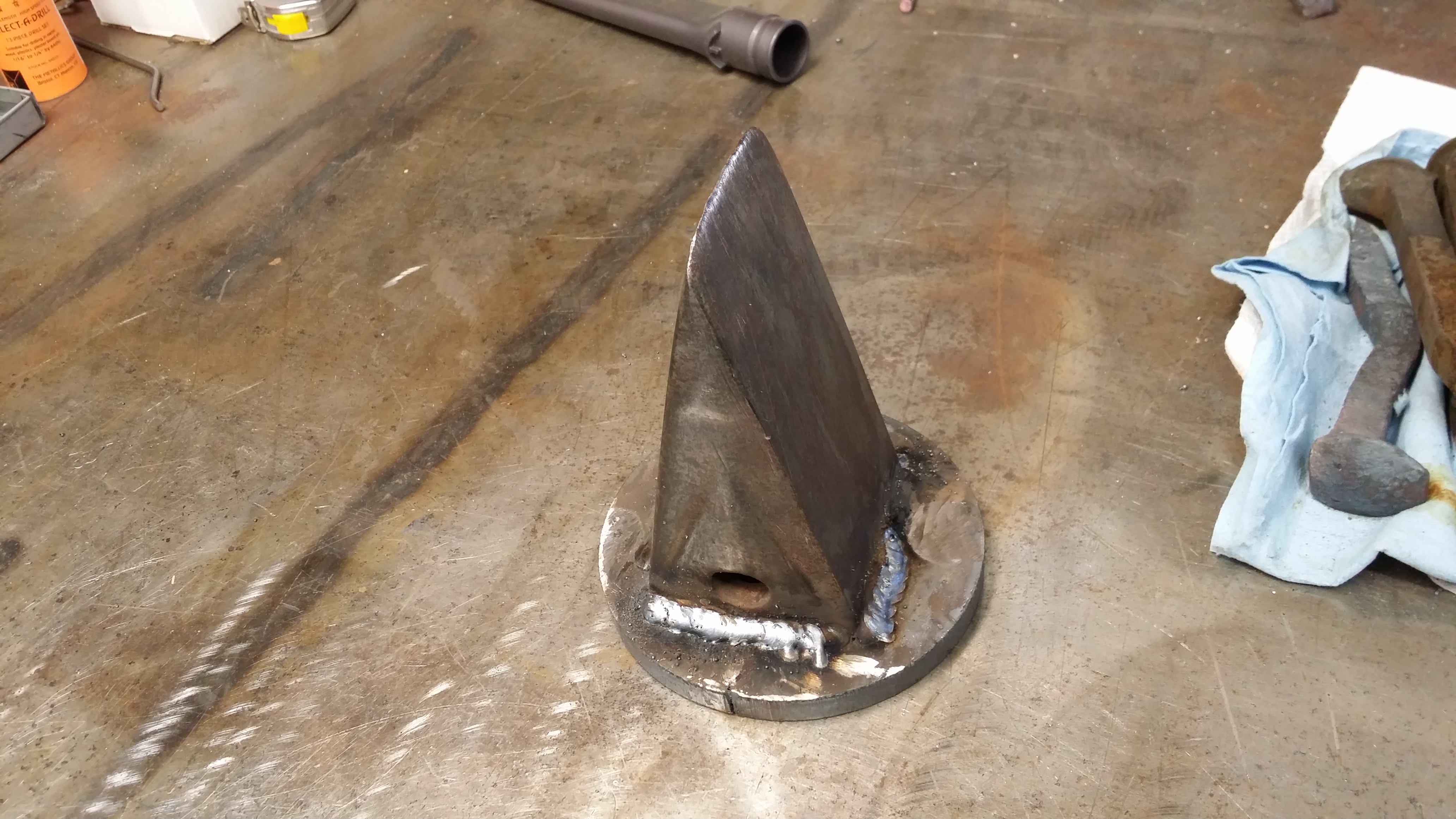

The bucket tooth welded to the 1/2" plate is my home made bottom tool. I used it to split the lengthwise cut open. I use it to open my split crosses as well, works great.
56f88d097d155_2016-03-2710.29.15.thumb.j
This time I drilled a 1/4 inch hole at the ends of the split. I also heated more of the piece at once with a larger fire. No splitting.
Neil, I don't think it is exhaust tubing. Exhaust tubing is 16 gauge, this is 10 gauge CRS. I can tell you that the finished product is rigid and strong, it does not flex with a full load of gravel.
Persistence pays off! Looks good, how's it work? That bottom tool you made sure looks like a primo kindlin splitter to me.
