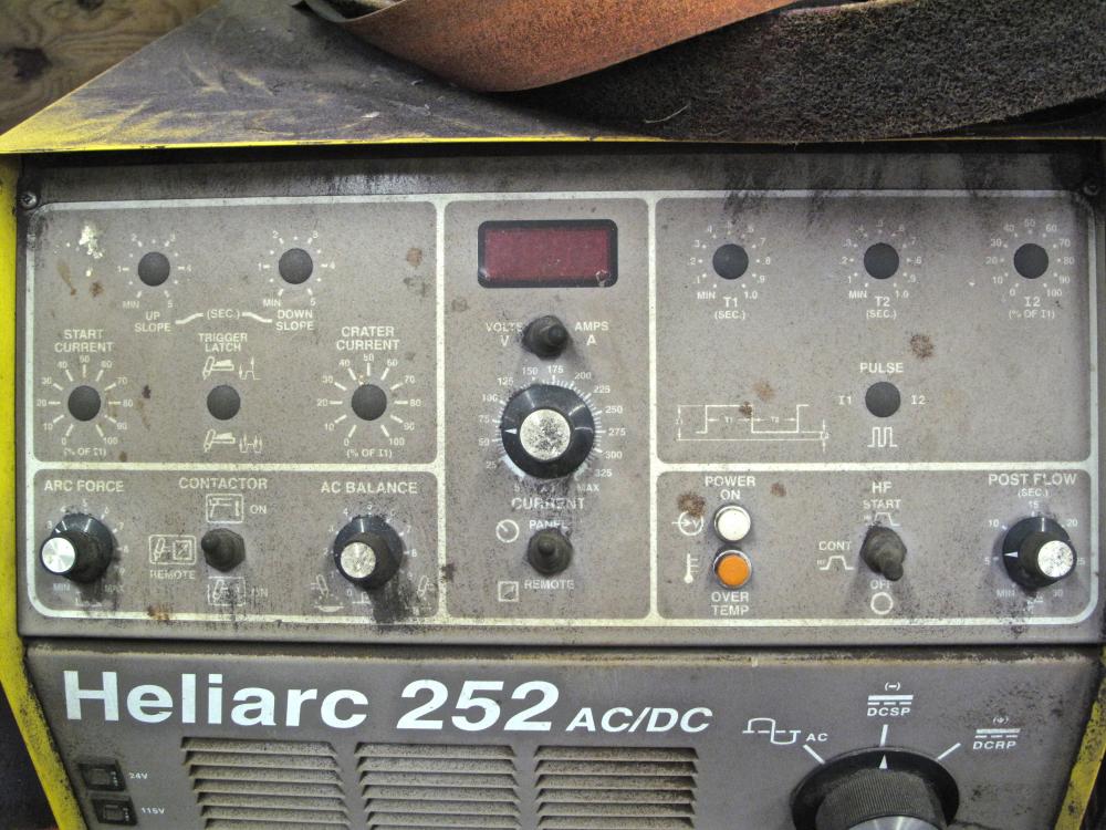

VaughnT Posted February 11, 2016 Share Posted February 11, 2016 I got her used, and really like that she's flying Steeler colors. I thought that would be good mojo for a metal guy, but apparently she thinks I'm some kind of Cowboys fan. It didn't come with a manual, so I'm trying to figure things out as I can. No formal training outside of high school metal shop more years ago than I care to think about. The good news is that there's youtube nowadays and that fellow Jody over at weldingtipsandtricks.com really puts out some good videos. I've even let my machine watch a few of his videos on the telephone so she'd understand what I was wanting her to do. She doesn't listen. I ran out of 7018 rods so I picked up seem 1/8" 7014 at Tractor Supply. The box says 120-170 amps, iirc, but that produces some of the worst beads you could imagine, with BB's flying everywhere and serious gouging of the metal. It's like a blowtorch more than a welder. I toned it down to around 80 amps and set the "arc force" (whatever that is) down a good bit, and it makes a fairly decent bead for a guy like me. Living and learning, very slowly. I need to call Heliarc to see if they have a spare manual for this thing so I can decipher what all the dials mean and how they are impacting my welding. I'm sure it's the machine's fault the beads are coming out all sloppy. Anyone familiar with these machines? Do they have peccadilloes I should know about? Quote Link to comment Share on other sites More sharing options...

John McPherson Posted February 11, 2016 Share Posted February 11, 2016 The switch is set in the photo to Electrode Negative, or what we used to call Straight Polarity. Good for TIG, less than wonderful for Stick. You want Reverse Polarity, or Electrode Positive for most operations. ESAB made these machines. http://www.esab.com/gb/en/support/upload/Heliarc-252-352-AC-DC-2.pdf Quote Link to comment Share on other sites More sharing options...

VaughnT Posted February 11, 2016 Author Share Posted February 11, 2016 The biggest problem I've had is trying to determine what is causing a particular issue when there are so many variables. The rods say they are +-, 120 -170 amps... I mean, can't you narrow it down a bit? Why give such a huge range of possibilities? And why does every video talk about volts and amps, but not this mysterious "arc force"? It's no wonder that a good welder gets paid good money! I'll try switching it over to electrode positive and dialing down the arc force to 2-4 like the above-linked manual talked about. Got my Ultra Jig in the mail from Yesteryear Forge and have a full day of smithing/tinkering planned, so I might as well throw some weld practice in there! Quote Link to comment Share on other sites More sharing options...
Quench. Posted February 11, 2016 Share Posted February 11, 2016 VaughnT, I run 7014 DC+ and set the amps low as I can for the metal and still push the slag back to see the puddle. If the rod said 120-170, I'd start with 130 because I'd stick the rod on 120 and make a mess on 170. My understanding of arc force is that is only matters if your arc gets too short and the voltage starts to drop too much like it's going to short out and stick. Then the arc force kicks in to stabilize the arc. WeldingWeb is also really good for questions like these. Very helpful to me. Disclaimer: I'm not a welder. I have a welder. Quote Link to comment Share on other sites More sharing options...
DSW Posted February 11, 2016 Share Posted February 11, 2016 Stupid disappearing post again.... Please move where required. Thanks. 120-170 amps DC for 7014 sounds high compared to what I typically use on 1/8" rods. Note though that AC settings are often higher than DC setting suggestions, so that may be in range for running 1/8" rods on AC. Note that it's important to note rod size as well as amps so things make sense. 120-170 sounds closer to the settings for 5/16" rod in DC vs 1/8" for example. With stick, how far you keep the tip of the electrode from the plate effects how hot the weld is as well as amps. Typically for 1/8" 7018, we have the machine set at 125 amps DC+ so the students can simply drag the edge of the flux on the plate as it burns and get nice beads. I can make just as nice a weld at 100 amps DC+, but I have to hold the rod off the plate farther to get the machine to increase the voltage and make the rod burn hotter. This can be useful to you if you have poor fit up and need to fill a gap. By turning down your amps and increasing your arc length, you can adjust how "hot" the weld is while welding. If the gap opens up, push the rod in closer and it tends to cool the bead some. Back it out farther and it burns in a bit deeper. Arc Force is kind of tough to explain. It's called "Dig" and other things by other manufacturers. It adjusts how "soft" or "crisp" your arc is. Rods like 7018 tend to run nicer with a soft arc. rods like 6010 tend to run nicer with a "crisp" arc. I don't have a really good way to explain this better. This is something that can be very subtle and newer students may not be able to notice the difference simply because they are changing too many other things at the same time while welding and those changes mask what the arc force is doing to the arc while welding. Keys to stick welding... Amperage, arc length, rod angle and travel speed. Get these right and things should work well. I try and have students eliminate as many variables as possible at the start. Arc length is an easy one to eliminate if you use "drag" rods like 7024, 7014, 7018. the flux builds up a little shell that extends past the tip of the electrode while welding. You simply keep the flux on the plate and your arc length will stay the same all the time. You can easily feel the flux touch the plate. Amps, mid range is a good starting point. For 7014/7018 that works out to around 125-135 amps DC+ using 1/8" rods. Not all rods from all companies are the same, so some variation may be needed to get what that particular rod likes "best". Rod angle... It's a bit easier to show someone than explain it, but I find tipping the rod so the top is in front of the bead at between 1 :30 and 2 O'clock is about right. Travel speed tends to be the hardest to keep consistent. On average a full length rod will lay down about 6-8" of weld bead, depending on the joint profile. If you are getting more length than that, you are traveling too fast. If you get a lot less, you are going too slow. When done you should have about 2" of rod left in the stinger, or about where the numbers are printed on some rods. You don't have to make any special motions while doing all this. You can simply drag the rod in a nice straight line. I find that some students fin trying to manipulate the puddle with circles, arcs, figure 8's etc just messes them up when starting out, and they forget to keep everything else consistent. If you do every thing perfect with 7024, 7014,7018 the bead will tell you when you are done. If you have to beat the slag off, you didn't do something right. If you are close, the slag will break up in nice big chunks with minimal chipping. If perfect, it will simply curl up behind you like a scorpions tail or just fall off. As a side note, 6013 is also a drag rod and can act similar to the rods suggested above. It does have heavier slag though and many students have issues seeing the puddle well with it or they bury slag because they can't differentiate between slag and puddle well. That's why I typically don't recommend it for new guys trying to learn on average. Quote Link to comment Share on other sites More sharing options...
