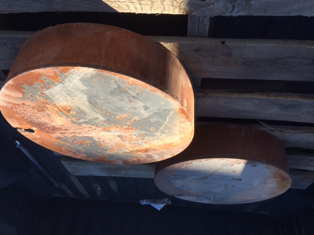

natenaaron Posted December 28, 2015 Author Share Posted December 28, 2015 Here is what I ended up with. each round is 3.25 inches thick, and 15 inches diameter. I can't decide if I should cut them in half stack and weld them together. Yes the pic is upside down but you get the point. Quote Link to comment Share on other sites More sharing options...
ThomasPowers Posted December 28, 2015 Share Posted December 28, 2015 To effectively add them together you need to do a full penetration weld across the face---noplace where steel is on steel that's not welded. Probably cheaper to buy an anvil. I'd use them as they stand and mount one on edge so you can use the curve as a horn... Quote Link to comment Share on other sites More sharing options...
Smoggy Posted December 29, 2015 Share Posted December 29, 2015 I agree with TP, use one flat and one on end, which is exactly what I have done with my counter balance weights. You could radius the odd edge if you wish or even cut a step in one, or other such "useful features". ID I recognise that from Stratford, worked perfectly well all weekend long as I remember. Quote Link to comment Share on other sites More sharing options...

natenaaron Posted December 29, 2015 Author Share Posted December 29, 2015 These will do for now. Frosty, these were ready to go, just siting there. No cuts needed. I'll mount one on it's side, dress the edges and start hammering away. Quote Link to comment Share on other sites More sharing options...
