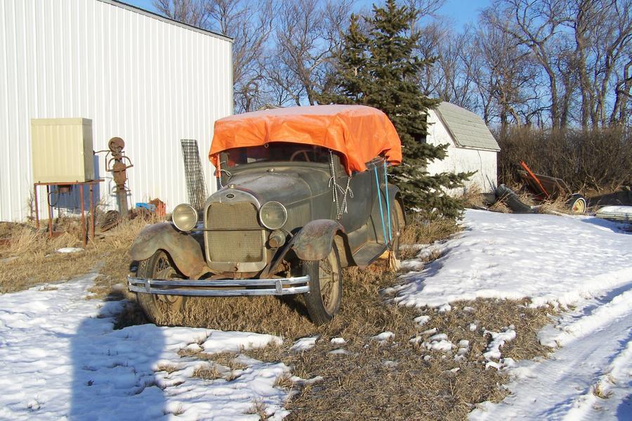

  6. the hammer is a 0 and comes with 1 set of dies. I should have pics later today or early tomorrow the Model A is for sale too, not mine so I can`t sell it. as much as I would like to buy it, I already have a `28 chevy project.
  7. I'm waiting for pics, have not heard from the guy yet since this morning. this is the only pic i`ve seen if it. it is that little thing on the left.
