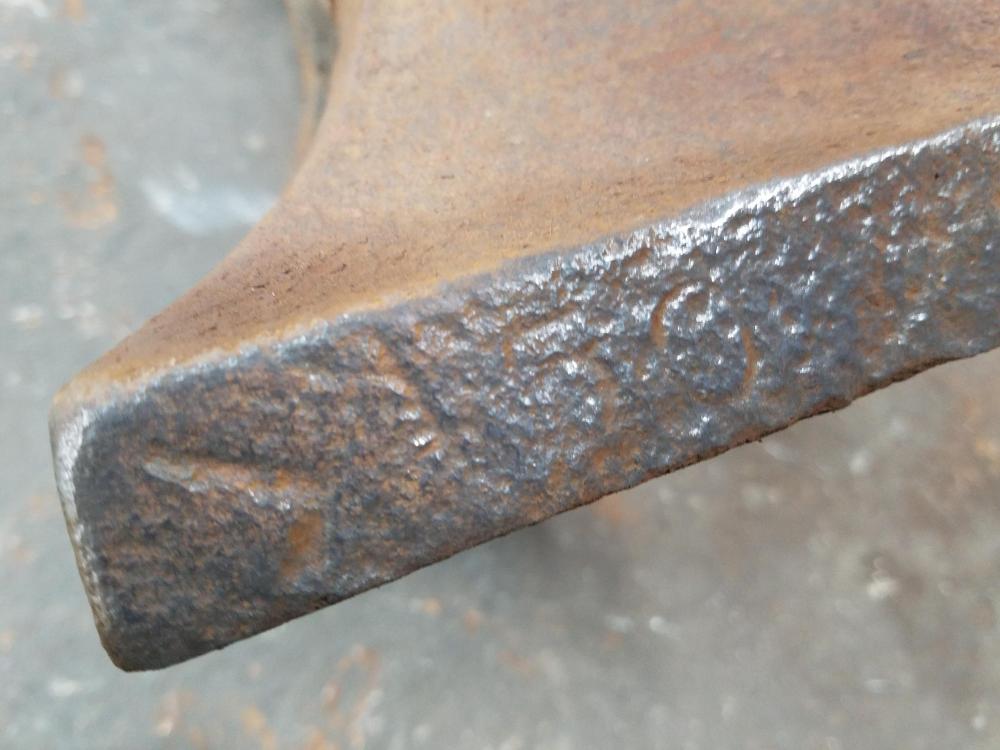

RHarrison Posted August 19, 2015 Share Posted August 19, 2015 I acquired a Hay-Budden, 204#, some months back and have tried to do some research, but can't find another one like it. It has three holes instead of two, the squared portion at the base of the horn only goes half-way, not all the way across. It does not have a serial number at the front under the horn like others, but does have 069 stamped on the side of the tail opposite the manufacturers stamp. Does anyone have a clue? Link to comment Share on other sites More sharing options...

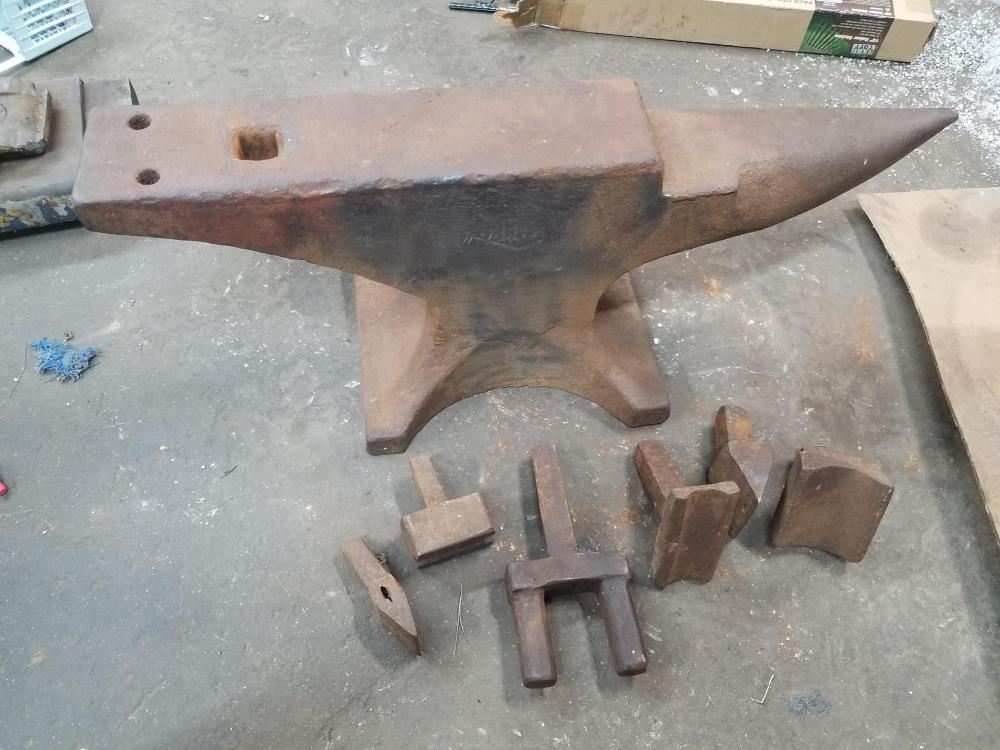

RHarrison Posted August 19, 2015 Author Share Posted August 19, 2015 Its actually in pretty good shape except for those torch cuts in the pic. The only other I've seen like is on the Hay Budden facebook page. But no info. Link to comment Share on other sites More sharing options...
Nobody Special Posted August 19, 2015 Share Posted August 19, 2015 Different, maybe an owner's modifications? It's not unheard of. The horn looks a little funny too...(besides missing part of the step...) Link to comment Share on other sites More sharing options...
Anthony San Miguel Posted August 19, 2015 Share Posted August 19, 2015 Looks like a farrier's anvil. Link to comment Share on other sites More sharing options...
RHarrison Posted August 19, 2015 Author Share Posted August 19, 2015 If you go to the Hay Budden Anvils Facebook page, the cover photo is of one identical to mine. Link to comment Share on other sites More sharing options...
George Geist Posted August 19, 2015 Share Posted August 19, 2015 Anthony San Miguel is correct.It's a horseshoers anvil. They usually have two pritchel holes and a cliphorn. The cliphorn on this one has been cut or ground off.Nothing unusual about it except that Hay Budden Horseshoers models can be a little hard to find. Nice scoreGeorge Link to comment Share on other sites More sharing options...
JME1149 Posted August 19, 2015 Share Posted August 19, 2015 There used to be a Hay Budden catalog in the Anvils by Brand forum, but it disappeared with the site upgrade. I seem to recall seeing anvils with double pritchels but don't think I ever saw that half cut table version. Hay would custom make anvils, so this could be a special. It also looks like the hardie hole is not centered which seems odd as well.In any case, she's a beauty and will last many generations to come. Link to comment Share on other sites More sharing options...
RHarrison Posted August 19, 2015 Author Share Posted August 19, 2015 Thanks for the info and replies. I'm attaching the photo from facebook which is identical to mine I think that would show no after market modifications on the one I have. Now I just need to find its value and how bad I need to keep it. Actually did find some numbers on the foot earlier. It shows a C or O with the numbers 77. Could it be a very early model? Link to comment Share on other sites More sharing options...

njanvilman Posted August 19, 2015 Share Posted August 19, 2015 I also have one identical to what is shown. There was never an extended clip horn on mine. They are not all that rare, just uncommon. Link to comment Share on other sites More sharing options...

Walnut Square Iron Posted August 20, 2015 Share Posted August 20, 2015 I have the same one. 201 lbs. I believe Frosty called it the lady with the surprised look. I have torch marks too. It is a great anvil. Link to comment Share on other sites More sharing options...
Judson Yaggy Posted August 20, 2015 Share Posted August 20, 2015 Looks factory to me. AIA shows that Trenton made a very similar anvil (half a shelf, 2 pritchel holes) so it's no surprise that another major manufacturer did the same. Hay-Bud specifically states in their adds that the made anvils to order. Link to comment Share on other sites More sharing options...
