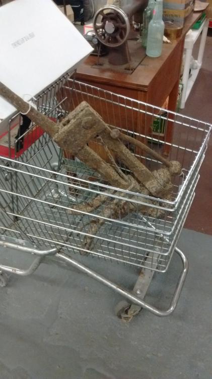

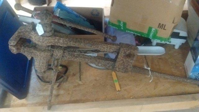

norrin_radd Posted July 31, 2015 Share Posted July 31, 2015 I was excited for a split second. But I think its actually all on piece now. Kinda sad. Tag had $65 on but nothing moves and it just looks bad. At what point is it too late? Quote Link to comment Share on other sites More sharing options...
Frosty Posted July 31, 2015 Share Posted July 31, 2015 (edited) ATF and a thinner like turps makes an excellent penetrant and let it soak. Something else an old timer told me back when I wasn't one. If you know what caused it to stick that's the stuff that will unstick it. I was surprised when he dropped a bolt with a rusted on nut in a bucket of water over night and it freed right up next morning.You don't want to try electrolysis on it till you can get it apart or it'll weld the pieces together. Long soak and gentle persuasion is probably the best bet. And there's no telling what she's really like till you get it apart.Frosty The Lucky. Edited July 31, 2015 by Frosty Quote Link to comment Share on other sites More sharing options...
ThomasPowers Posted July 31, 2015 Share Posted July 31, 2015 At what point? I stop when the screwbox and screw are trashed; however since they were often well greased they are often in the best shape one you get them loose.Price seems a bit high; I seen ones in much better shape at Quad-State for less. Quote Link to comment Share on other sites More sharing options...

norrin_radd Posted August 1, 2015 Author Share Posted August 1, 2015 (edited) Yeah I would have. I was in a hurry earlier when I said it looks bad sorry. I should have explained and said the working condition looks very bad. I picked it up and there is no movement at all. It's hard to even see any seams where the pieces touch each other. It's like its one solid thing. I may go make an offer and see what i can do. If I can get it cheap.Thanks Edited August 1, 2015 by norrin_radd Quote Link to comment Share on other sites More sharing options...
ThomasPowers Posted August 1, 2015 Share Posted August 1, 2015 No bad condition is broken and severely bent items, missing critical parts, (mounting bracket and spring is not a critical assembly), bad torch cuts, etc. Rust, meh; put on your face shield and respirator and unleash a wire brush on it when all the easy to get rid of stuff is gone then hit the joints/moving pieces with the best penetrating oil you can get. When the screw lets loose I used to take a narrow container and soak the screw and screwbox for a week in something like kerosene or diesel and then use a wire bottle brush on the SB and a hand held wire brush on the screw and get rid of 80 year old grease remnants Quote Link to comment Share on other sites More sharing options...

Charles R. Stevens Posted August 1, 2015 Share Posted August 1, 2015 Seriusly, tossing it in a stock stocktank over night and you may be able to open her up and then start cleaning it up once ots apart. Quote Link to comment Share on other sites More sharing options...
Glenn Posted August 1, 2015 Share Posted August 1, 2015 (edited) I try to tell people that it may have taken a year or more to get into that condition. Be prepared to spend the same amount of time getting it back to working order. Ok maybe not the entire years time, the point is do not rush things. Go slow, let it soak, move it just a bit and let it soak some more. You have time on your side. Edited August 1, 2015 by Glenn Quote Link to comment Share on other sites More sharing options...

norrin_radd Posted August 1, 2015 Author Share Posted August 1, 2015 Well I got it. He took 50.Now the fun starts. Quote Link to comment Share on other sites More sharing options...
DSW Posted August 1, 2015 Share Posted August 1, 2015 I think you did well. The spring and bracket are all there, jaw size looks decent. Looking forward to picts as you restore it. Quote Link to comment Share on other sites More sharing options...
Howard Raymond Posted August 2, 2015 Share Posted August 2, 2015 Seriusly, tossing it in a stock stocktank over night and you may be able to open her up and then start cleaning it up once ots apart. Yes, Charles, water is one of the best penetrating oils available. And it's cheap! Quote Link to comment Share on other sites More sharing options...
norrin_radd Posted August 3, 2015 Author Share Posted August 3, 2015 Are y'all saying to soak it in water? Quote Link to comment Share on other sites More sharing options...
Charles R. Stevens Posted August 3, 2015 Share Posted August 3, 2015 Yep, the rust will absorb water and become soft and crumbley. Then you should be able to unscrew the box and the pivot pin. Thoroly clean, dry and oil/greas afterwards. If it still needs a bit of "lube" try glycerin, it has an afinity for water and will fallow the water into the rust. Make sure to clean all the glycerin out tho, as it will atract moisture from the air. Quote Link to comment Share on other sites More sharing options...

matto Posted August 6, 2015 Share Posted August 6, 2015 (edited) fifty fifty mix of ATF and acetone drip it on and let it sit a couple days and she will free up. keep puting the mix on. had a post drill that looked like that and after a couple days things started to move freely Edited August 6, 2015 by matto Quote Link to comment Share on other sites More sharing options...
