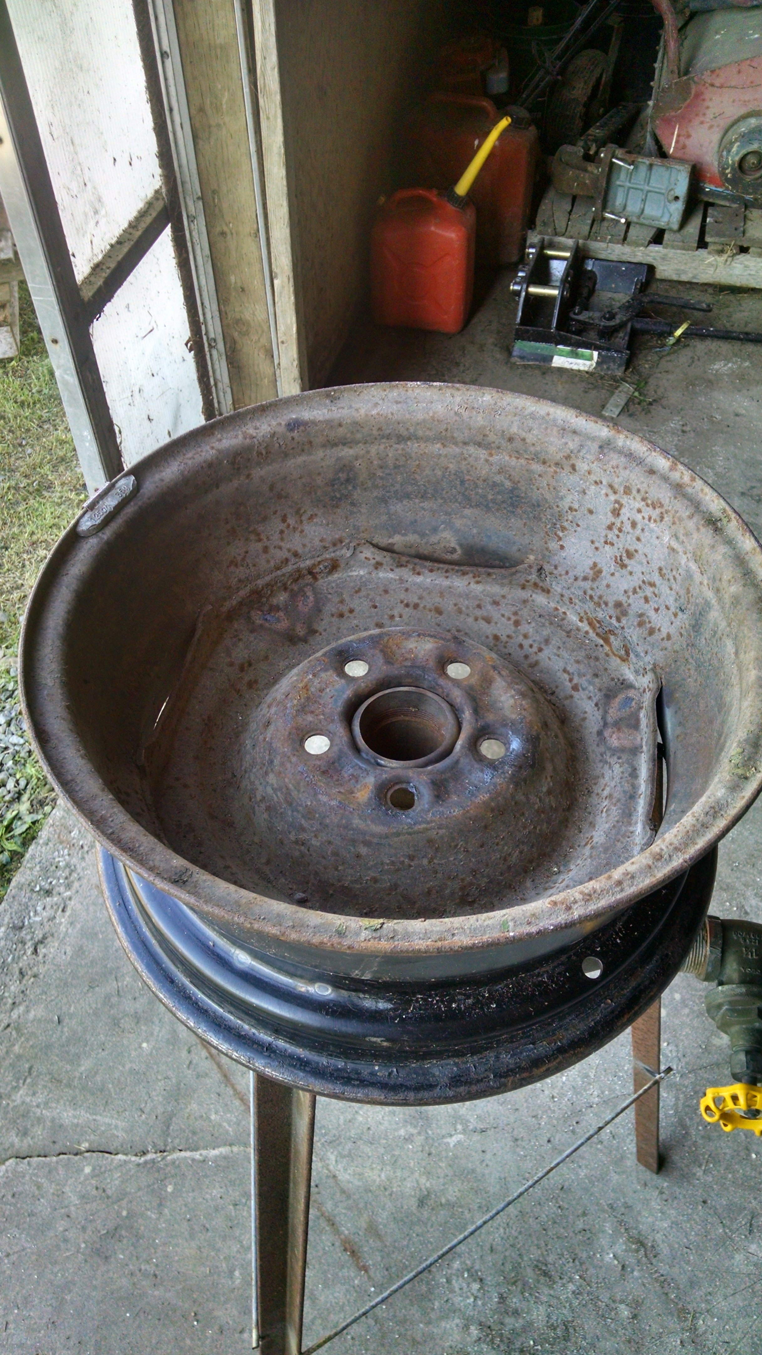

September 14, 201510 yr Hey guys I'm new here and wasn't sure on which thread to post in, sorry of its the wrong one. I'm in the middle of building my own coal forge and I just had a couple questions. The main part of the forge is made out of an old tire rim, I'm thinking of making a fire pot out of 1/4 steel plate and insulating the space between the firepot and rim. Is this steel thick enough to resist the heat? I would like to know if I should even bother making a firepot or if I should just line the rim with Clay. If so whats a good mixture for that? And if I make the firepot could I use the same mixture for insulation? Thanks, Johan
September 14, 201510 yr For that set up I would skip adding a firepot. As for clay I used what I dug out of the creek back where I used to live and mixed it with wood ashes. Solid fuel forges usually do not use insulation. If you need to drop the temperatures down air gaps are better.

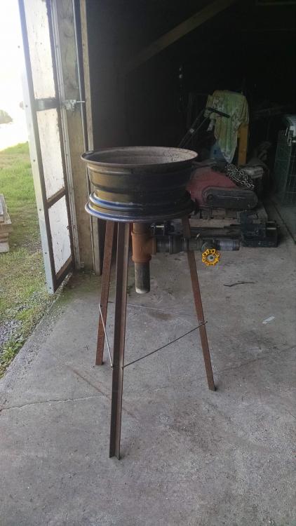

September 15, 201510 yr Alright thanks, would it last longer if I made a firepot? It's not too much work so in a way I wouldn't mind it being overkill. Do you have any other tips? Here is a few pictures, let me know what you guys think.
September 15, 201510 yr Yes, No or Maybe depending on a hundred little details you haven't provided. If you don't use it; anything will last till the building collapses on it.
September 15, 201510 yr And I offer both; you are free to ignore both as well or to go through and read the massive amounts of information already posted on this set of forums. I would be surprised if most questions have not been answered many times before.
September 15, 201510 yr I agree that's why I mentioned I didn't know whether this was the right thread, I wanted to stay away from searching for 3 hours lol. All Id like to know is what's better in the end game, regardless of how much work it will be? Assuming I'll be using it once or twice a week.Thanks
September 15, 201510 yr Small work/Large work? Forge Welding? How brutal are you with forge linings? Possible exposure to water? (You have mentioned the fuel, so that's to the good)When you get right down to it EVERYTHING in a smithy is a consumable---including the smith. Increasing the time between rework/replacement generally ups the cost and complication. For example buying a rammable refractory to line a forge with vs using creek clay and ashes. Using stainless for everything instead of mild steel . Protecting your vision and your hearing.... There is no one RIGHT way to do things and most of the differences are dependent on details related to the person using it. My first forge was made from a 1930's era dry sink. I lined it with creek clay and wood ashes in a linear trough design with an adjustable tuyere length. I used it for several years using charcoal as the fuel. When I was done with it I would slide a piece of sheet metal over it and put a weight on top. This was for OKC conditions/materials.
September 15, 201510 yr I'm more expert regarding gas forges, so take this for what it is worth. As Thomas mentioned you might be better served by looking at some of the already worked out forge designs illustrated elsewhere on this site. There is tons of great info in the section on solid fuel forges. Not sure why your time searching is more valuable than mine writing, but I'm feeling generous today.I've never used a coal forge that didn't have a firepot for concentrating the coke produced. Looks to me like your configuration could use the liner recommended by Thomas to, at minimum, level the bottom of the forge and close up the holes left by the drum configuration (I'm a fan of rammable refractory, but it does cost...). Personally I would probably include some level of Duck's nest at the air exit point.Clearly you will need some kind of blower and connection to same from your Tee fitting. The necked down size and gate valve are a bit overkill as regards flow metering, so hopefully you have a blower that will push around 140 CFM if you plan on getting a larger fire up to welding temps.You also will probably want to put in some kind of grating at the floor of the forge to keep the fuel from dropping down the air blast pipe. A clinker breaker is nice, but I've heard good things about a simple grid of 1/2" bar.If you are going to use the forge inside, and possibly outside as well, you will probably need to make a hood to direct the heat, smoke and fumes away. The side draft type work a treat and aren't that hard to build.Finally you will need to make an ash dump gate for the bottom, so you can clean out the dirt leg and keep the air going the right way.
September 15, 201510 yr Hey guys thanks for the generous responses.This is gunna be my first time using a forge and doing any kind of smithing, I mainly plan on using it for blades, forming and quenching. I would like to do some forge welding with it. I am leaning towards putting in a firepot made out of 1/4 mild steel plate and insulating the space between that and the tire rim. As for the floor of the forge I'm thinking of taking a 2" pipe endcap and drilling some 1/4" holes in it. The ash dump will just be a end cap screwed on the bottom. My air will either be coming from a 6hp shop vac or an inflated unit for a greenhouse, I'll take a look at the specs tonight to see if its sufficient. I can make a quick drawing tonight and I'll post it so you guys can take a final look and make some suggestions if need be. Thanks again, Johan
September 15, 201510 yr If you insulate your firepot it will burn out faster. WAY too much air; I've done tons of forge welding using fractional horsepower blowers and you want to go 6HP!!!!
September 16, 201510 yr Hense the control valve lol. So do you think it would be wise to build a firepot but don't insulate around it? That way some air can come up through the rim and cool it down a little? Also do you think the 2 inch end cap would be sufficient for the duck or do I need something heavier?
