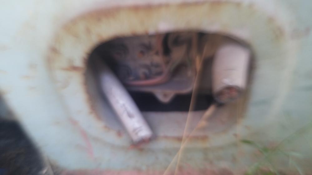

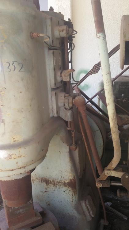

santisandreas Posted July 4, 2015 Share Posted July 4, 2015 Hello there, i am opening this post to get your opinion on a used rusty power hammer i found in the northern part of my country. since Cyprus has never really had a lot of manufacturing as an island it is extremely difficult to find a used power hammer here, but on the other hand Turkey is the country that manufactures the Sahinler hammers so i thought it would be a good idea to look for one over there.. In the end we didn't even look for it, this one was found by accident when my father was passing by. anw to cut a long story short we went to see it yesterday and found out that it belonged to a public school that is now closed for the main part but opens only on Mondays. so we are going to talk to them so as to ask for a purchase price. but before i do that i wanted your opinion if this hammer is worth the trip and if yes how much is it worth.. what is the maximum price one should pay for this? as you will see in the images below the condition is quite bad since it has been sitting outside for more than five years probably but it hasn't been opened on the inside to steal any parts (except for the motor at the back). Another thing is if you happen to know which is the manufacturer and if they produce good hammers. i did some research and found a couple of manufacturers who produce similar models and here are the links. : http://www.aref.fr/Second-hand-equipment-refurbished?formulaire_action=liste_machine&formulaire_action_args=8%2FrbUXta6g97jzK6CXgnW1JaZ6bpDEyBBjIbEpuCqkRUoIMlbNRV7WkzYctpTGDNviJYLWkio4knAjIVdigxmHrJcSMRFS6P&famille=MPF&puissance_mini=0&puissance_maxi=xxxxxxx&chercher=&nom_famille=aucune&famille_ref=Open+die+hammer++&lang=enhttp://scgmachinery.com/en/used-machinery-catalog/forging-hammers/ (this is the Astrakhan which is very similar to the one i found with the same model number, just a few extra letters. mine is M4129 while here is MA4129A. SO i am guessing that this is the manufacturer.) does anyone know these hammers? what can you say about them in general. After viewing the images do you think it is possible to repair this hammer and bring it back to working condition? Any advice or comments on the subject will be appreciated. thanks for reading. Quote Link to comment Share on other sites More sharing options...
Alan Evans Posted July 4, 2015 Share Posted July 4, 2015 (edited) I have been unable to post a reply in the normal way…keep getting the no permission page...so if this works maybe one of the mods could put it into the Power hammer M4129 thread... I don't know anything about Stanko hammers, maybe some of the old eastern block smiths do.It looks well made and finished. And appears little used, but the photos may be leading me astray.It is one-piece which is an enormous advantage as far as ease of installation goes.If you are able to undo nuts and bolts I am sure you can strip and clean it up. Make sure you take off the rust on the tup before you pull it up throughout the bore! Are you getting it at scrap price or are they wanting more? If so what is the history /provenance of it, is it in working order?It looks similar in proportion to my 1cwt Alldays and Onions but is double acting (blown up and down) So possibly a 50 or 75 kilo tup?The advantage you will have with it over a steel fabricated hammer like the Sahinler is the length of stroke. This is good because for the same weight of tup you generate more impact, and you have the height and clearance to use top tools more readily.Compare the prices if you can get this one cheap enough to allow some money for the refurbishment. As long as nothing is broken, a simple check to see if the drive wheel will move back and forward and is connected to the piston will tell you most of what you need to know...Do some more research, get in touch with Olga and Sergiy Polubotko in the Ukraine, they organise the annual blacksmiths conference in Ivano-Frankivsk and may well know somebody with such a hammer. If I could raise the money I would not hesitate. I would have no fear of being able to get a working hammer out of something like that... I may be horribly over-optimistic of course. Obviously you must check it carefully for signs of damage and misuse, but the engineering is fairly basic and robust. Even if it cost you double the purchase price in rebuild parts you will be ending up with a more versatile tool than a Sahinler, Kuhn, Reiter or Gruell type. The only part you would have difficulty and uneconomic expense to replace will be the main frame casting. Alan Edited July 4, 2015 by Alan Evans Quote Link to comment Share on other sites More sharing options...

Alan Evans Posted July 14, 2015 Share Posted July 14, 2015 (edited) That all sounds very hopeful. The motor may not be too far away. Are there bolt fixings for the motor on the hammer or was it on a seperate mounting?At this stage if you can get it at a nominal figure I can't see you going wrong. The guy you spoke to who said it was working fine before decommissioning would presumably have no reason to mislead you.Before it is moved I would take a paint scraper and take off any rust that is on the tup. This is just in case the people that lift and shift it do not push the rusty tup up into the bore.If you wanted to check it will work before you commit, you should take the cylinder heads off and ensure that the bores, pistons, con rod and bearings are all present and correct. A long bar under the flywheel will tell you whether the main bearings are good, though I have seen a working one with almost 6mm (1/4") of play. Frankly I don't think you need to bother. However, if you will be hard stretched financially to take it on, then any checking will be worth doing. Take a friend who knows about machinery with you to get a second opinion.The valve gear is an unknown to me, but nothing about these hammers tend to be high tech. Just good simple engineering. With a lathe and possibly a milling machine you can make most of the parts.Have you done any more research into the maker?Alan Edited July 14, 2015 by Alan Evans Quote Link to comment Share on other sites More sharing options...
santisandreas Posted July 14, 2015 Author Share Posted July 14, 2015 yes, i too agree that it is 99% a good deal considering that the school principal has no benefit on this deal. i guess it will be bought at a scrap value price which is very cheap around these parts. i am assuming that the price will be from 800 to 1500 euros max. i will take a friend to help me and get a second opinion but i don't think that i will need to run any tests. it is quite difficult to do so there at the school because it is in the occupied part of my country which adds pressure on all matters. i think the motor was at the back where the cage is cracked open, if you see in the images posted at the beginning. but i am not sure. if it is indeed missing i will buy a new motor as part of the renovation. but this is a matter that will be dealt later. i will see if the guy pulls through and we can buy it. by then i will post any news abot the subject, thanks for your advice, i will consider it when i make another visit. thanks again! Quote Link to comment Share on other sites More sharing options...

jhegge Posted July 19, 2015 Share Posted July 19, 2015 I have a MA 4129 A in my shop and I am very impressed with the quality of the hammer. I recently exchange messages with an individual from the company that is currently selling these hammers and he quoted me the purchase price of $8,000.00 +/-. From the pictures you have attached it appears that the hammer has had light use. Look for the obvious issues related to the hammer sitting and offer something appropriate for a price. Quote Link to comment Share on other sites More sharing options...
