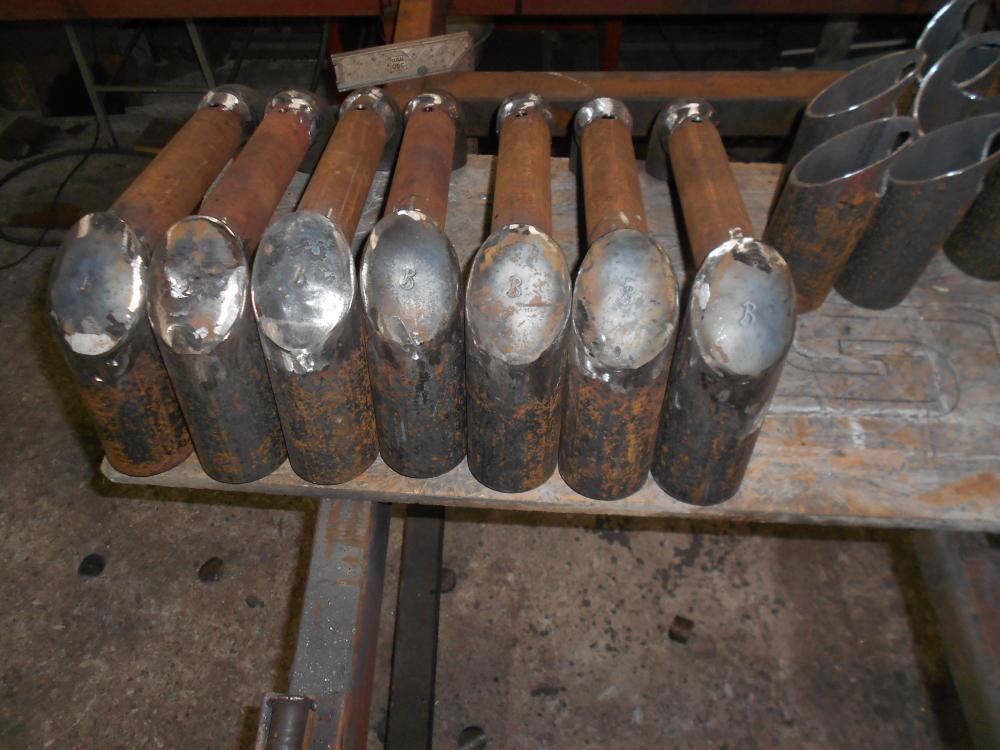

    The first five burners in the first photograph, can run 5 miles from the socket
  3. BANAN replied to dps9999's topic in Gas Forges
    The advantage of naturally aspirated burner is that it does not need power. Burners operating with fans have the advantages of a lot more. I will mention here less gas consumption, adjustable flame atmosphere, the opportunity to work with a heating recuperative air supplied to the burner, absolutely safe operation without rolling back the flame to the burner. Such an image as the photograph is very common in my forge, sometimes it can not keep up with the production of burners. Demand for cooperating with ventilator burners is very high. None of the blacksmiths who once worked on the burners naturally aspirated, does not want to return to them.
