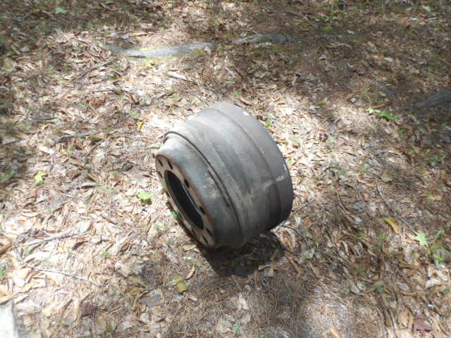

would their be any advantage to using a larger brake drum,  Buddy of mine kicked off a brake drum from his shop today in my driveway.
looks better suited for a fire pit. LOL

Nope, fire pit or buried anchor are the best things I've seen done with a heavy truck brake drum. Run 3 long bolts through the lug holes for feet and put a grate over the hub hole and it should make a nice enough brazier / fire pit. Maybe a decent BBQ but it's pretty deep.
Ah ok. Now I'm thinking I'll cut the lower hole larger and taller and just put a stainless bucket I have under the dump.
it doesn't have to be stainless. I'm using a bucket that had a first life holding polyurethane for hardwood floors. Just metal bucket should be fine.
