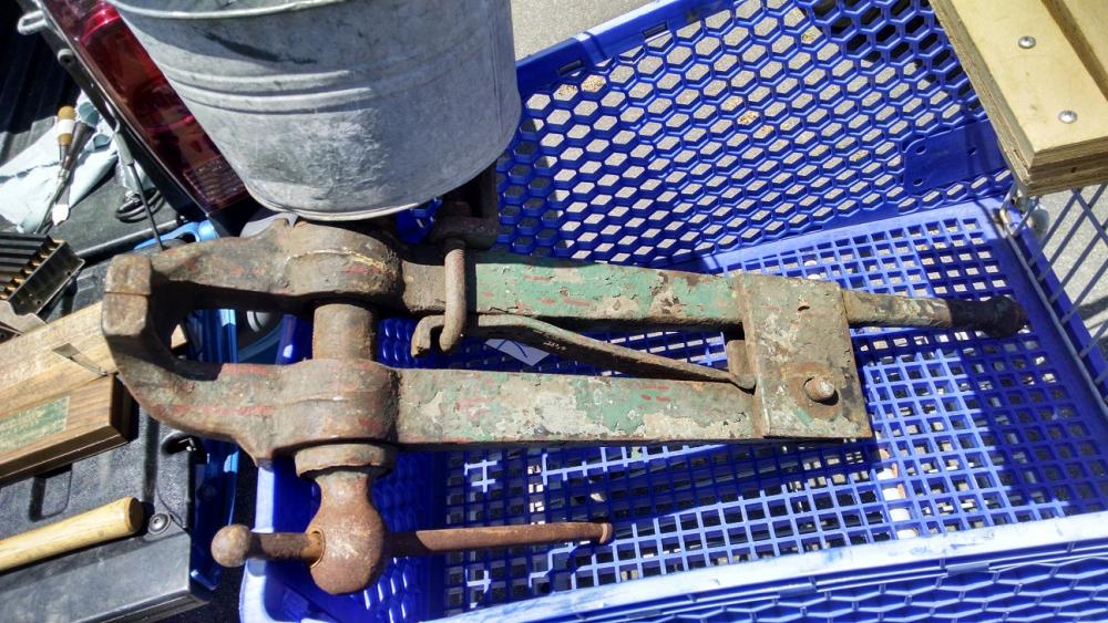

Here's the beast,Billsvise.thumb.jpg.a4294f55c552f4cfa20b took 3 of us to carry it out, with a 4th guy running blocker for all the crowds looking at their cell phones. Once we got moving there was some INERTIA in our forward progress.
a few years ago I got some help carrying a 60lb vise out of that flea market, that was a feather compared to this thing.
That's an oversized, Costco style shopping cart by the way.
good shot, michael.  thomas, i didn't even think to knock off the moving leg.  DOH!  we finally got it to the front and michael snagged the cart, and we took it to the tailgate of kirk's truck for pictures (per our usual alameda finish).

some more pictures.  the vise, next to the 4"-jaw vise I am still refurbing, the face of the moveable jaw after wire brushing (interesting dot pattern!), and the pivot bolt.  I think I will replace the bolt with a new one!
The stripped bolt doesn't need to be replaced.  Depending on fit,  just cross drill for a hair pin, cotter pin or bent nail.  That is one beautiful Brute!
