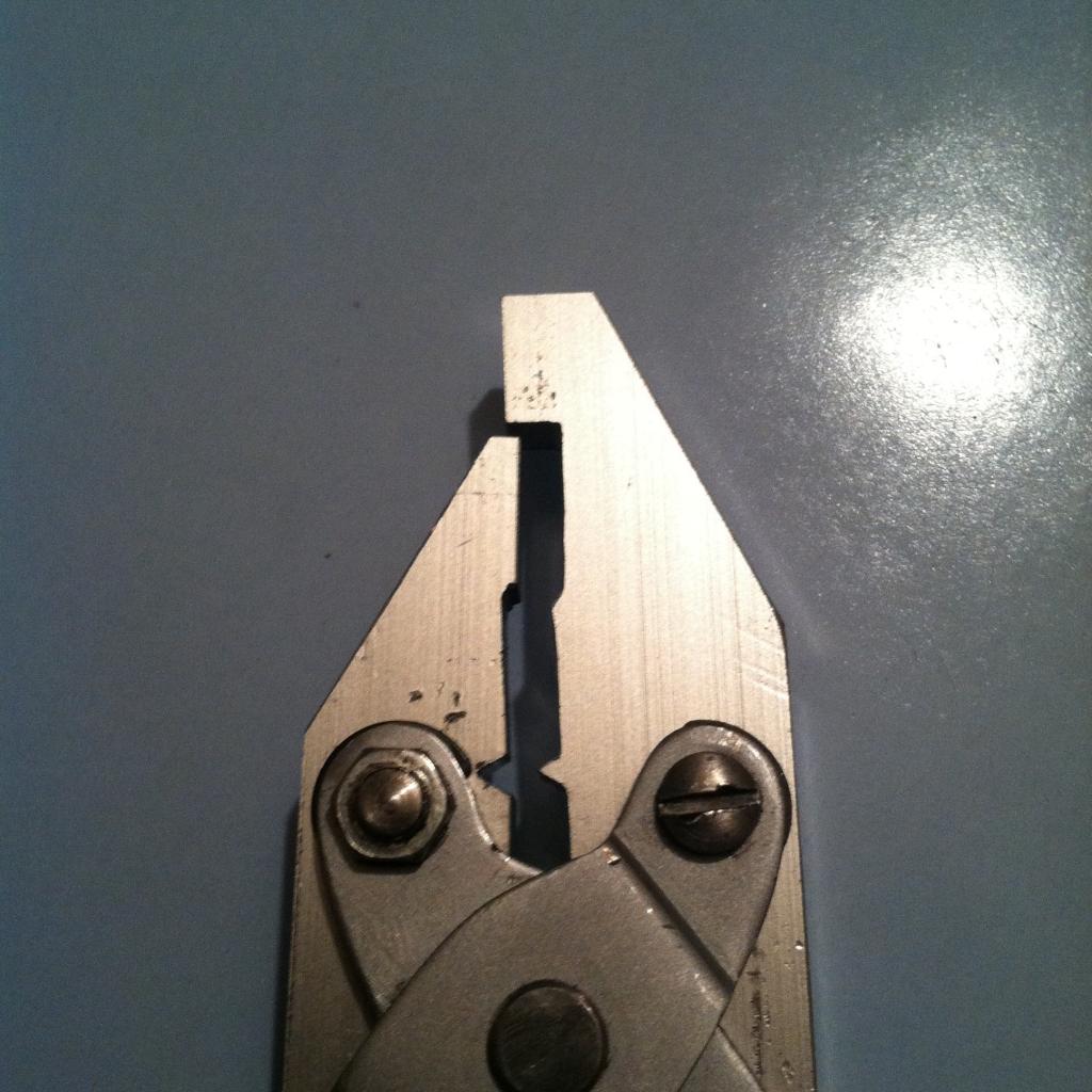

​I have seen a one off tool that can do this, pictured, but I was looking for something simple.  I have heated the quenched but did not try to flatten while heated but it is worth a try.

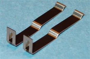

​The picture are of pieces already from but not necessarily flat on the contact patch. The .020 is the thickness of the shoe and it is actually closer to .015" when I checked it with calipers. They do get twisted sometimes but that is an easy fix as it is typically on the "hanger" which is at the far end of the picture.
Below is a picture of how they hook up with the springs providing tension.  Notice the are actually disconnected from the slotted front end. And a picture of them connected.
I want to flatten the to improve the widen the contact patch to make the car run smoother and improve electrical contact.  When not perfectly smooth you get arching which produces a blackened are on the contact patch thus further reducing the electrical contact. I have used 400 grit sandpaper to polish and you can actually flatten the patch in the manner is you sand long enough and have the patch flat on the sandpaper.
