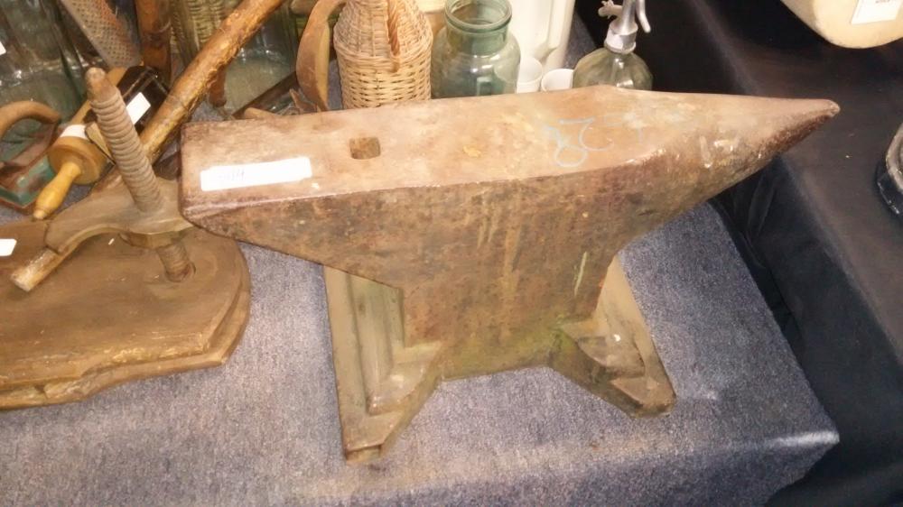

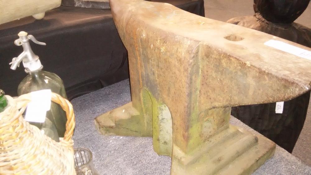

stan Posted May 8, 2015 Share Posted May 8, 2015 This anvil for sale at the moment don`t plan to buy it but wondered how rear it is with its church windows.Weighs 438lbs. Quote Link to comment Share on other sites More sharing options...
neg Posted May 8, 2015 Share Posted May 8, 2015 That is my dream anvil. Quote Link to comment Share on other sites More sharing options...
alextynan Posted May 8, 2015 Share Posted May 8, 2015 Where abouts is that, and how much is it going for? Quote Link to comment Share on other sites More sharing options...
stan Posted May 8, 2015 Author Share Posted May 8, 2015 Hi alextynan its in WA up to $1520 with 20 hours to go Quote Link to comment Share on other sites More sharing options...
alextynan Posted May 8, 2015 Share Posted May 8, 2015 A bit out of my beginners price range! Thanks for the tip off though. Quote Link to comment Share on other sites More sharing options...
Dan P. Posted May 8, 2015 Share Posted May 8, 2015 That's a nice lookiong anvil but the "church windows" don't anything to its value, in my opinion, apart from rarity. Quote Link to comment Share on other sites More sharing options...
VaughnT Posted May 8, 2015 Share Posted May 8, 2015 I would gladly pay $2000 for an anvil like that. Nearly new in all respects, and it has some nice deep church windows.You can't get church windows on newly made anvils, and 400# anvils are definitely hard to find - new or used. Do the church windows add value to the anvil? Well, as a swage, yes. You can use them to form bowls and curves, though they probably won't get used very often unless you make a line of product that just happens to need that curvature.However, we can't discount the value that beauty plays in our tools. Anyone can fabricate an anvil, but creating an anvil that is beautiful and inspires beauty in the shop... well, that's worth a dollar or two in my book.If I had a decent paycheck coming in, I wouldn't hesitate to pay $6 a pound for that anvil. Maybe I'd even go to $7. The size and shape are perfect for general blacksmithing tasks, and she's a genuine beauty to behold. Very rare tool, so why not spend good money to acquire it? Quote Link to comment Share on other sites More sharing options...
ThomasPowers Posted May 8, 2015 Share Posted May 8, 2015 And I wouldn't pay US$3 a pound for it as lovely as it is; I'd take that excess $$$ and buy a powerhammer. Quote Link to comment Share on other sites More sharing options...
HWooldridge Posted May 8, 2015 Share Posted May 8, 2015 It appears the edges may have been welded on at some point - which would detract from the value to a degree. Quote Link to comment Share on other sites More sharing options...
Dan P. Posted May 8, 2015 Share Posted May 8, 2015 To counterpoint VaughnT's enthusiasm, I would not pay $1500 Australian dollars for that to use as an anvil. There must be much cheaper anvils to be found, or objects that can function very well as anvils. Unless you are buying it as an antique, or art, or your assets are feeling very fluid and you just really, really can't be without it.And I also want to add for the record that those "church windows" are just an old European anvil making convention. They don't serve any particular intended purpose, and I believe that even the term "church windows" has its origin somewhere deep in the guts of the internet, probably anvilfire or somewhere. Quote Link to comment Share on other sites More sharing options...

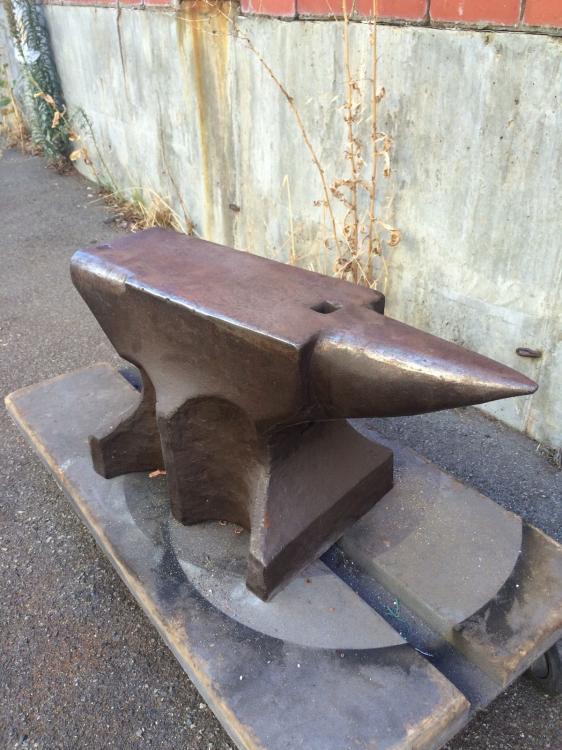

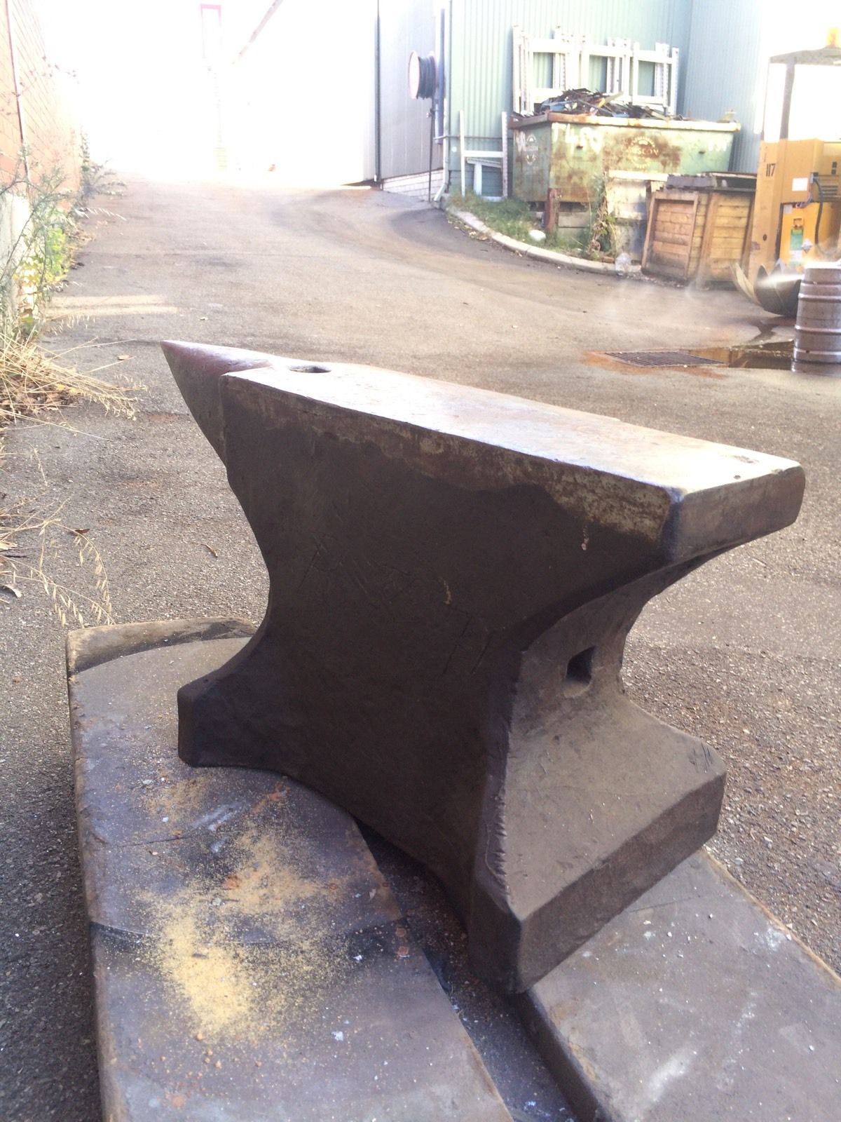

Anthony San Miguel Posted May 9, 2015 Share Posted May 9, 2015 This one was at an auction house here in San Antonio this past Saturday and I went to try and win it. It weighed at least 250lbs, maybe 300. I wanted it really bad but $500 was my limit. Some lucky guy got it for $600 and I'm watching eBay where he will probably put it up for $1200. It was a JEB Austrian anvil that came in a lot from the Czech Republic. Quote Link to comment Share on other sites More sharing options...
stan Posted May 9, 2015 Author Share Posted May 9, 2015 Hi Anthony that looks like a pretty special anvil shame you missed out. Quote Link to comment Share on other sites More sharing options...

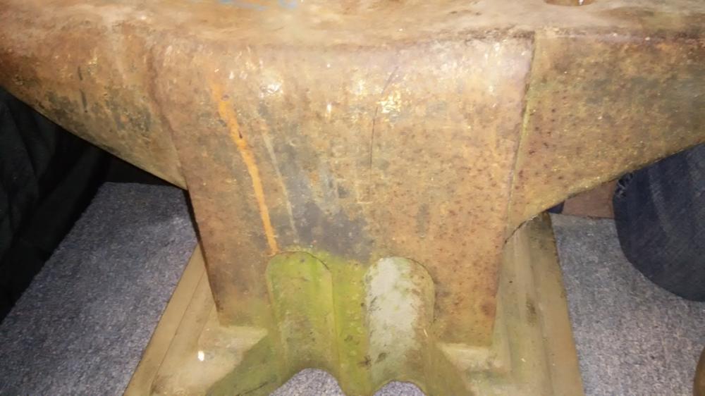

stan Posted May 9, 2015 Author Share Posted May 9, 2015 It appears the edges may have been welded on at some point - which would detract from the value to a degree.Yeah see what you mean about being welded on that section along 4" from the horn.The other side looks suspect also. Quote Link to comment Share on other sites More sharing options...
Anthony San Miguel Posted May 9, 2015 Share Posted May 9, 2015 Hi Anthony that looks like a pretty special anvil shame you missed out.Hello Stan. Yes, I will probably regret not getting it for the rest of my life. The guy I bought my Hay Budden from had a 125lb Mouse Hole Forge anvil and I had to go buy it as a consolation prize because I was so heart broken! Quote Link to comment Share on other sites More sharing options...
matei campan Posted May 9, 2015 Share Posted May 9, 2015 that s Austrian pattern anvil is the most common pattern in central and eastern Europe, maybe 90% of the anvils, like the London pattern in the US, that's "the anvil" in the people's mind. and theJEBs tend to dish more than other anvils, maybe from it's construction or from the kind of use and abuse they suffered, that's a very common issue on them. the perfect flat ones are very rare. that doesn't mean the faces are not hard and the rebound poor. it's interesting that the communist era copies you can find here, even that the faces are softer, they don't tend to dish, but to rather "mushroom". Quote Link to comment Share on other sites More sharing options...
