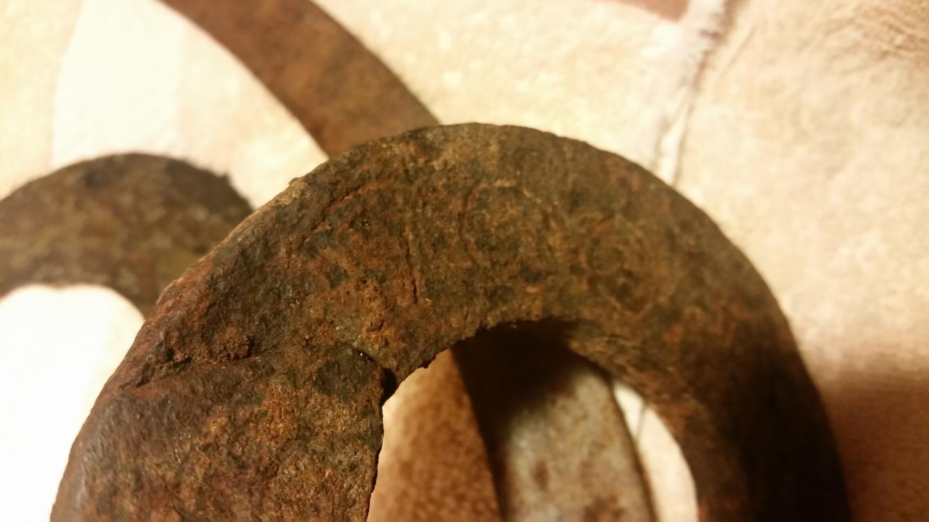

April 9, 201511 yr Author Haha, purely coincidence. My natural smile looks like a grin... has gotten me in trouble a couple times.So two days in vinegar took off some nasties, but I'll still hit it with the turbodisk to get rid of the final bits. Date showed up on the machete; 1914, so that answers that.The markings on the weight are still illegible to me, but seeing how it's a weight... probably it's weight
