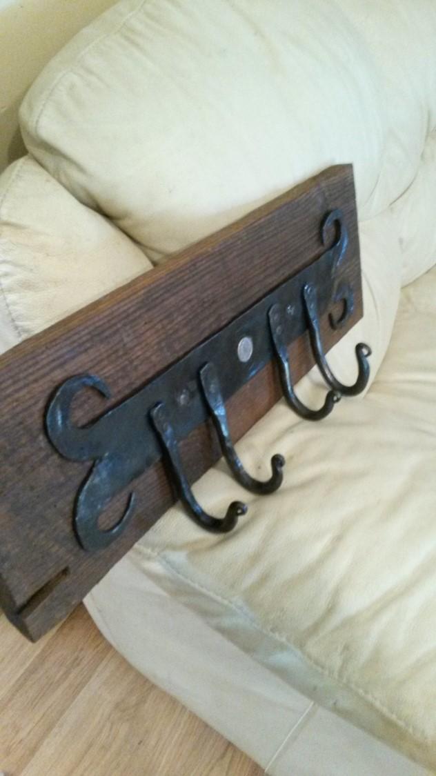

So....one of the great freebies of scrap that you tend to end up with is the lawnmower blade, right?
And most beginners tend to want to make a knife or a hatchet.  They're then promptly attacked on FB or wherever and it turns into an ugly discussion of the quality of scrap in general and lawnmower blades in particular.  But I think most people miss the point with lawnmower blades, i.e. it's a flat bar with holes in it.  So why not use it as such?
I've made knives out of lawnmower blades. Check block. Wrapped and welded hatchet? Check block. And if you're not sure of the steel, you can weld a bit in.....
Or....you can use it for coat racks, backings, brackets, bracings, hinges. Towel holders, Mini-chandaliers, your own Game of Thrones Iron Crown (king of the north!) .............anything you can imagine that you can make out of a flat bar with holes in it.
This one in particular is an easy beginners project. How do I know? My kids worked on this one. I helped. Hence the rustic, (okay, let's call it textured and asymmetrical. Be nice, they're kids. :P ) look.  You can also drift the middle a little and add a coin, pic, or slump glass for a nice effect.

Actually most rotary mower blades that I have run across are about 1084 to 1090 carbon and will make very fine cutting tools... including knives!  Limited sizes and the inconvenient holes are drawbacks.  I sometimes run into some edge damage that is a bit of trouble to work around as well.  None of the old blades that I have on hand are low carbon!
If you are collecting some, the thicker ones are preferred as they are more versatile.

I thought I remembered that mower blades were L6 or something comparable?  A little Nickel, and some Chromium for wear resistance, have a little bit of shine (some brands have more shine than others) when you pattern welded with a file and or some leaf spring???  I can't remember which brand of lawn mower blades Billy Merritt said had a particularly good flash when welded up in a billet.
SJS, everybody seems to want to give me mower blades. I've found they're all over the place. Some soft, some hard, some hi-carbon, some not so much, some that act stainless-ish. (some harden in oil, some in brine, some just don't, really) Older ones maybe a greater likelyhood of mid range carbon or so.  So I've just taken to skipping and using em for everything else. Although the holes do invite creativity.............
I really like lawnmower blades for things other-than-knives.  Right now, I'm working on a dead-bolt that uses a mower blade for the back plate.

Yah I have noticed that the manufactures of these different products don't feel bound by the junkyard steel lists at all, or even the ASTM lists.  That is why Billy Merritt says for doing junkyard Damascus you should try to stick with known quantities, like John Deer mower blades for commercial mowers like on a golf course.  Find a brand that works on the mower, and in the forge like you want, and then stick with it till they change the steel on you...  For random scrap blades that people just give you out of the blue, cause your a blacksmith you can use this, I can see how that can be a crap shoot...
