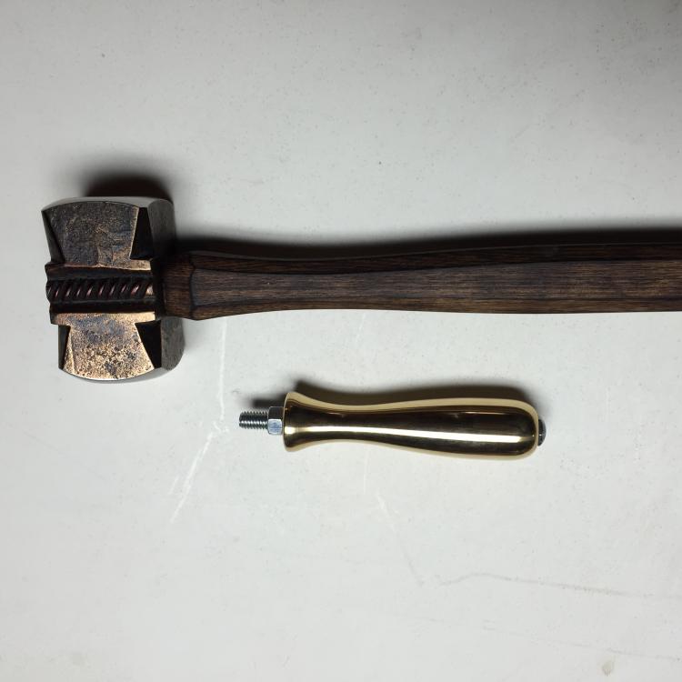

Jim Coke Posted February 23, 2015 Share Posted February 23, 2015 Greetings All,I of course with my elite status only use a custom A J Cergol design rounding hammer .... THE TRUTH .. I have many hammers with different shaped and after 40 years am still not sure wich is my favorite.. The pictured hammer is a birthday gift from A J and the custom brass blower handle a gift from the Frogman ... They joined me at my shops for a weekend of blacksmith fun and had a blast.. We all should be blessed with such great people around us .. I am indeed a lucky man.Forge on and make beautiful thingsJim Quote Link to comment Share on other sites More sharing options...

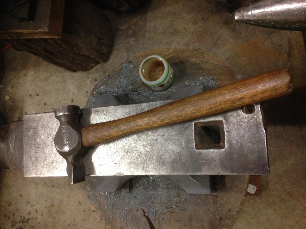

stan Posted February 24, 2015 Share Posted February 24, 2015 This is my favorite hammer, wt 28oz not really sure what it is but does a great job taking any hammer marks out and feels right.Also don`t know how common this but I have`t seen many big old 3lb ball pean Quote Link to comment Share on other sites More sharing options...

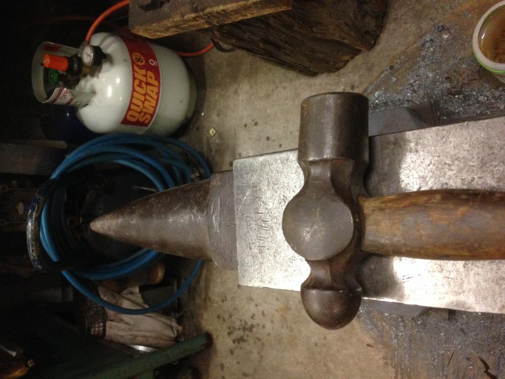

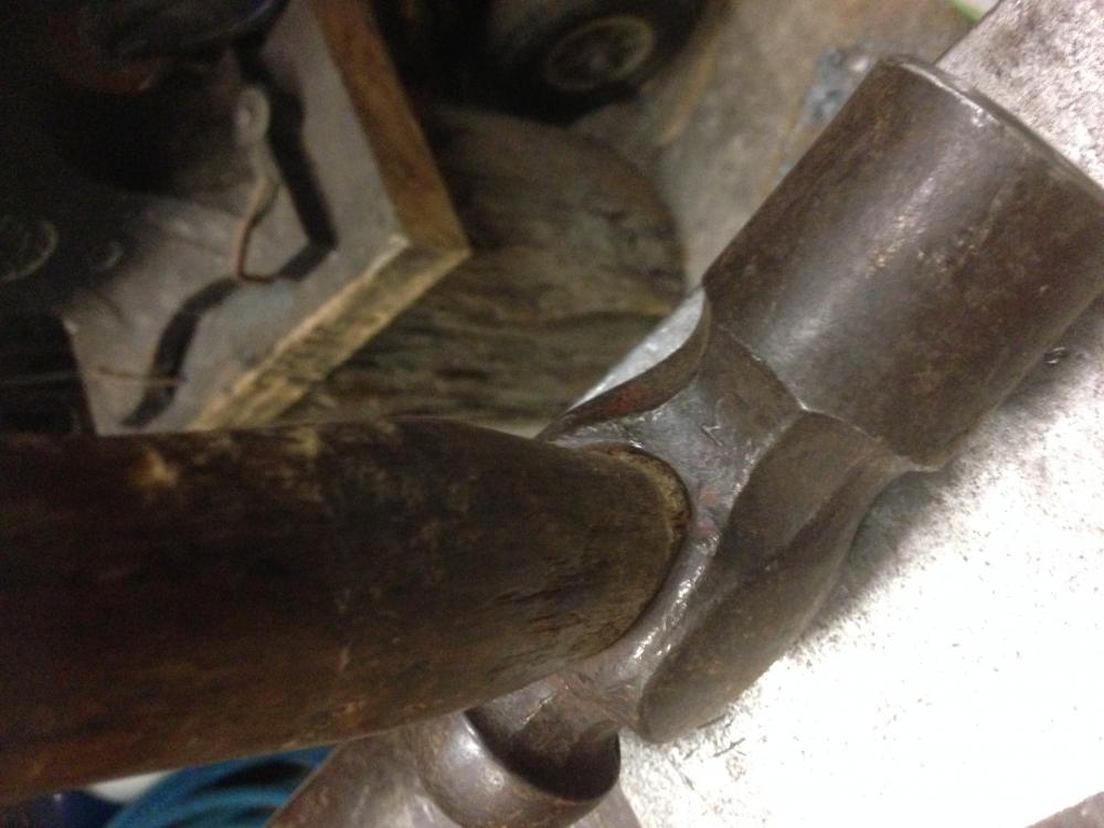

Big-D Posted February 25, 2015 Share Posted February 25, 2015 I only use two hammers for forging. This one I made, and one of the Swedish hammers I re-forged. The peins are way too "sharp" on most store bought hammers. Quote Link to comment Share on other sites More sharing options...
