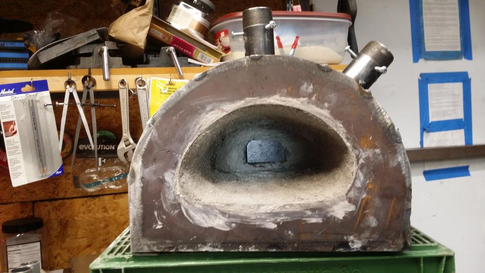

My Kast-O-Lite is presently curing and I will be starting my doors soon. I am going with 2 soft fire bricks that will slide on angle iron rails. One thing I am considering is to cut a notch into each fire brick so when the doors are closed I will still have an opening for exhaust and a viewing hole. Not sure if this would make the bricks break though. I could accomplish the same thing by just not closing them all the way and having a vertical slot instead.

I was heading this same direction, C-channel slides for brick at the front and back of the forge, but have ordered hard brick as it seems awkward to have 2-1/2" bricks at the ends and the hard bricks are half that thickness.
Will hard brick be too much of a heat sink? Even with IR coating?
Alternatively, I see soft brink available 3/4" thick but will that be too fragile?
