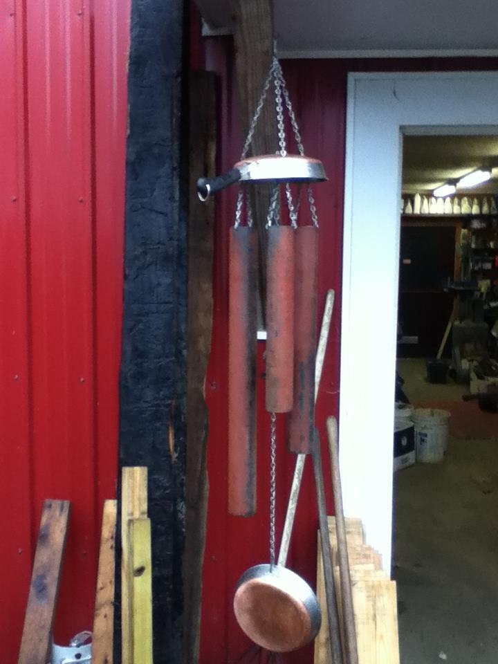

  3. lally column make great wind chimes if you cant get your hands on bell material this one was made for the guy that runs our transfer station and i managed to get all the parts out of the metal dumpster of a month or so right down to so really bad 7018 and a ball hitch for the clapper
