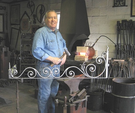

knots Posted January 9, 2012 Share Posted January 9, 2012 Nice looking forge. Looks like it may be one with a rear blast water jacketed tweir. It should work unless there is a damper hidden up in the hood some where. Riche's suggestion of burning news papers to start the draft is standard proceedure for many forges. if the hood has an accessable smoke shelf that would be the ideal place to burn the news papers. Quote Link to comment Share on other sites More sharing options...

jkmas Posted January 10, 2012 Share Posted January 10, 2012 Kendall I have over 30 years of experience with the construction of chimneys. However 99% of these chimneys are of masonry construction. I have a home built forge table with a centaur forge firepot. My side draft hood is constructed from a dissambled water tank and re-shaped into a cone with a 8 " round stove pipe. I do rarely get some light puffs of smoke when starting a coal fire but most of the time i have no problem with a good strong draft. For the size of my forge the 8 " will suffice. It does not hurt to have a larger diameter pipe. However cost and availlability at the time was an issue. My garage is kept at a minimum 62 degrees (northern Illiniois winter). Even very strong winds hardly have and effect on the draft. Some questions? Is the spark screen that terminates on top of the flue too low to the top of the last pipe? In other words is there too much restriction at the top. Make sure that the termination is at least the same diameter of the pipe (It can be wider but never narrower never reduce diameteter below what you start with.). Is there a high efficient furnace nearby in the same structure as your forge? On some of my fireplace jobs over the years, I made a point to install a wider pipe or at least a higher pipe than the architects planned called for because of the "stack effect" of existing taller chimneys and the negative pressure created by cold air returns , tight insulated walls and new windows. In other words, some of these factors can pull air down form the smaller or lower flue. It is Ok to have slight bends in the flue as long as they are not tighter than 45degrees. I have approx. 14 lin, feet of 8" pipe . with two 45degree fittings. The only other question I have for you is if the side blast tuyer is to strong. It may be blowing the smoke out beyond the hoods capability. Quote Link to comment Share on other sites More sharing options...

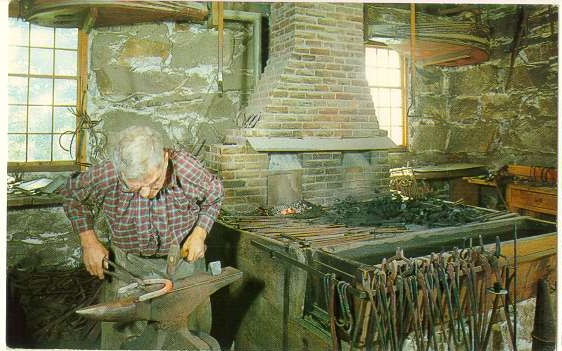

Pat Roy Posted January 13, 2012 Share Posted January 13, 2012 For what it's worth, I operate with an 8" flue. It is about 16 feet tall and has a small offset bend. I have tall trees all around the building so wind has little effect. I wanted to use a 10" flue but the double wall insulated stuff was just too expensive in that size so I went with 8". It works in my shop. Randy, that crevice tool you refer to increases the air velocity but it is a restriction and the overall aif flow is reduced. Quote Link to comment Share on other sites More sharing options...
Old N Rusty Posted January 13, 2012 Share Posted January 13, 2012 My stack is a 12" pipe suspended directly over the forge. Straight up 20' with 6' above the roof. 12 " above the firepot, this chimney draws dust out of the shop on a hot day with no fire. When there is a fire ,it DRAWS! This might be the IDEAL stack as it is 316 stainless steel and will never rust. Quote Link to comment Share on other sites More sharing options...
