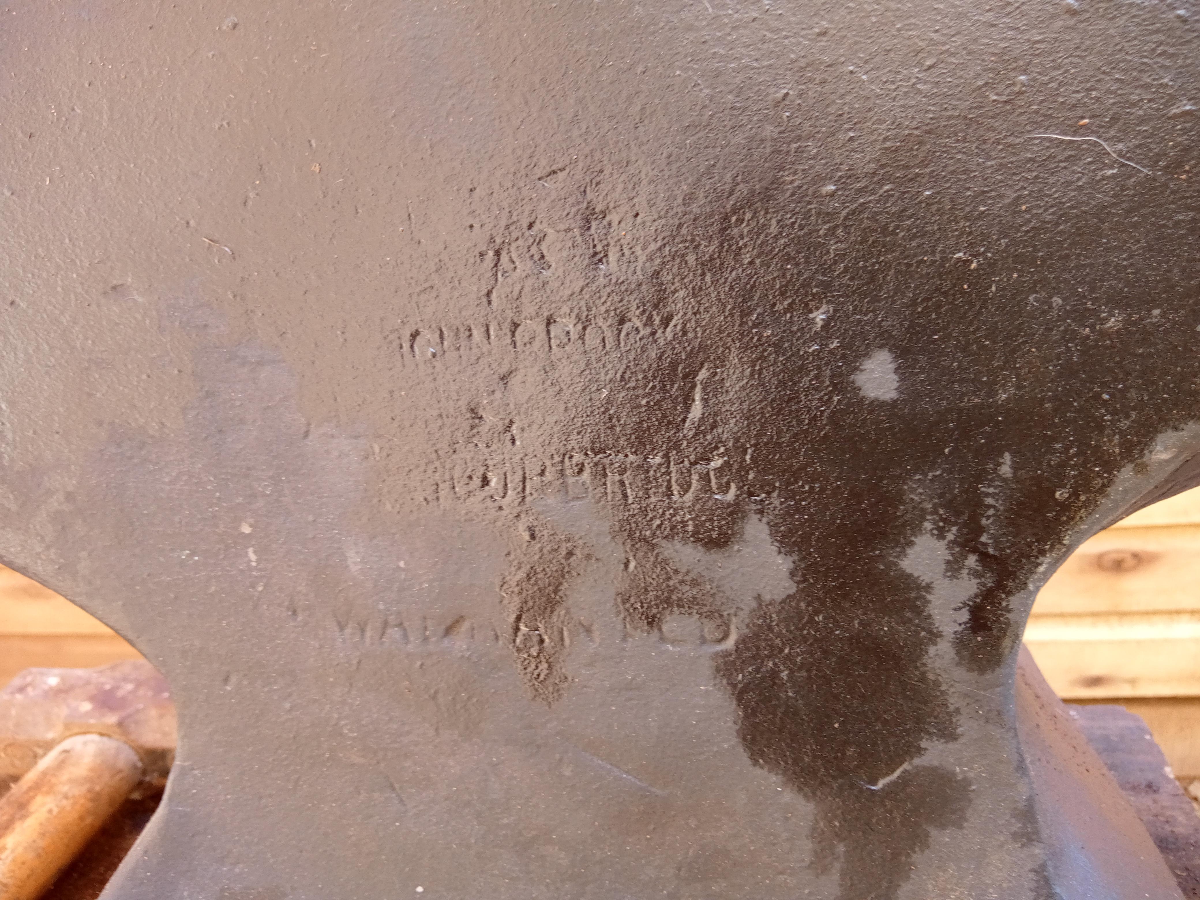

Mrkensei Posted October 29, 2018 Share Posted October 29, 2018 Hi, new member here. Sorry for the massive necro on this thread but I was looking for info about my “new” anvil, and since its John Brooks this looks like the right place. the markings are almost worn off but its seems to be in great condition. My Dad, who gave it to me says its the best part of 200years old, tallying with the 1820s reference above. Can anyone shed any light on it for me? Quote Link to comment Share on other sites More sharing options...
Irondragon Forge ClayWorks Posted October 29, 2018 Share Posted October 29, 2018 3 hours ago, Mrkensei said: new member here. Welcome to IFI... I suggest reading this to get the best out of the forum. https://www.iforgeiron.com/topic/53873-read-this-first/ Your Brooks looks to be in excellent shape. Have you read about not doing any grinding or milling on the face? Where are you located? What did you want to know that wasn't covered in the previous post's? Quote Link to comment Share on other sites More sharing options...
Mrkensei Posted October 30, 2018 Share Posted October 30, 2018 I was hoping to get a better indivation of the age. It does aeem to be in surprisingly good shape for its age. I was looking at restoring it, but ive read that just oiling it and putting it tonwork are the best ways to bring it back to life. 11 hours ago, Irondragon Forge & Clay said: Welcome to IFI... I suggest reading this to get the best out of the forum. https://www.iforgeiron.com/topic/53873-read-this-first/ Your Brooks looks to be in excellent shape. Have you read about not doing any grinding or milling on the face? Where are you located? What did you want to know that wasn't covered in the previous post's? Quote Link to comment Share on other sites More sharing options...
JHCC Posted October 30, 2018 Share Posted October 30, 2018 No clues on age, but worth noting that the absence of a step (sometimes called a "cutting saddle") between the face and the horn means that this is a "Birmingham-pattern" rather than "London-pattern" anvil. Quote Link to comment Share on other sites More sharing options...
ThomasPowers Posted October 30, 2018 Share Posted October 30, 2018 Does not look like a 200 year old anvil to me due to it's configuration, (*old* anvils tend to have small sharp feet and small horns/heels and no pritchel---look for "colonial anvils" to see some examples); but 100+ I could see easily! If the pritchel hole was drifted and not drilled it generally dates to after 1830. We don't consider an anvil "old" till it gets to 200+ years. I work on an 1828 William Foster at times. Quote Link to comment Share on other sites More sharing options...
