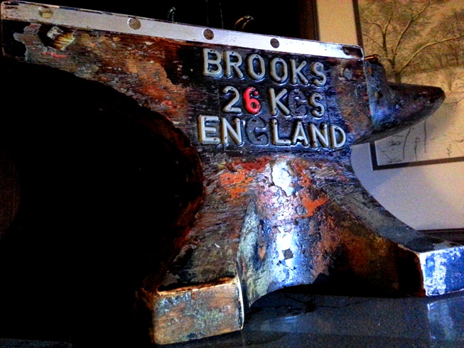

Black Frog Posted February 17, 2018 Share Posted February 17, 2018 Here's a bit of Brooks history. Factory wood anvil pattern. .... love the oddball '6'. Quote Link to comment Share on other sites More sharing options...
