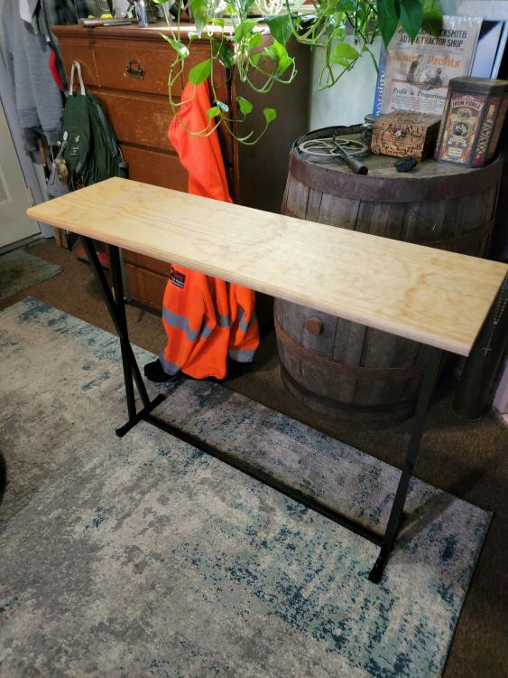

Thanks guys yes I could have been more descriptive. The table is the exact size the customer wanted it to be, I wasn't impressed with the design (which is also per the cutomer) so I shot it down which I really shouldn't have done. The last pic like I said was from the customer and they loved it, I need to learn to not be so hard on myself. After all they did comission me to make it, when they could have bought something at a big box store. Scott build away good sir. -

Maybe I need to look at it differently. The customer sent this so they must be happy and that's all that really matters. -

Those railings are something! The architectural work you guys do blows my mind. As far as the pendant and arrow head go I'd like to know what the "contaminant" was so I can accidentally contaminate my acid with it! Clean, sharp work. Table done. To me it's nothing to write home about, but the customer is always right. Right? -

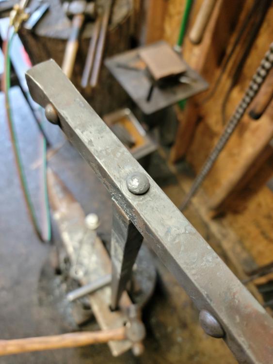

Thanks Anvil I appreciate it. The upsets are simple but elegant in my opinion also. Here's the base. I wanted to do exactly what you said with drifting the "x" but the angle is too acute. The points of the X are only going to be 9" apart as the table top is only 11" wide. I've been thinking about it for days. I don't like the way it looks if the X bars are placed on either side of the horizontal bars so my only choice is to do some fab work and cut and weld the X. I chose 3/4" sq bar instead of 1" sq. I wanted the framework a bit thinner than the table top which is an inch thick. That and 20ft of 3/4" sq vs 1" sq was over $100 less.

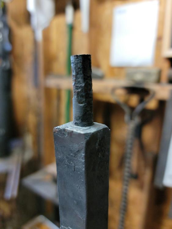

I'll try that technique for sure thanks again. BillyB I was able to get it pretty square on the initial set downs with die I made for my guillotine tool. They're 45 degree butchers with a 16th of an inch radius instead of a sharp edge. Suggested in a video by my hero Mark Aspery lol. After that I used squaring dies (also 16th of an inch radius) to draw out the tenon. The monkey tool really didn't do much since it was already pretty clean. I suspect if it wasn't that's where Frostys tip of a stout monkey tool would come in handy. I will admit at first I tried to "wing" it and it was BAD, after realizing there's a reason some techniques are done a certain way I made the tooling. Now it's my new favorite thing and everything is going to have a mortise and tenon joint. Kinda like how everything had a brass finish when I learned that technique. -

The monkey tool I made is NOT stout, it was made from the same 3/4" bar I'm using in the project. I didn't think about that so I'll make another one. I've never heard of a chisel cut in the mortise. So with the tenon in place just before piening where would the cut be made? Thank you very much for the tips! -

My first serious attempt at tenons for a table I'm working on. I made die for the guillotine tool and a monkey tool today, then finished up the base of this table. -

Ugh I see what your saying. I knew I got the idea from somewhere. Gonna have to remedy that. I figured with how much I've been posting I should start my own instead of blowing up "What did you do in the shop today." Unfortunately his wife picked the "X" but he said he may ask for another table down the road because he preferred the scrollwork.
A repeat customer ordered a table and supplied the wood top. The wife wants a long thin table for under a windowsill. He gave me a picture of one with an "X" design so I drew my version up and gave him another couple options I thought of. I really wish I could draw! Anyway he's my best customer and usually gives me artistic freedom. Hopefully he likes my ideas more than the "X"
