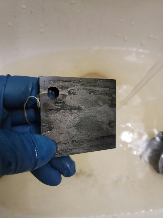

UPDATE. Here are more pics of an untouched sample after a long etch. I'm also having a full spectro analysis done. The PMI gone showed the following. Zn 1.22%, Pb 0.37%, Fe 94.97% +/- 1.55 I'll update again after I get the spectro analysis. Just curious what you guys think. Thanks!

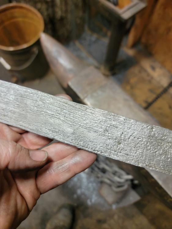

Hello. Looking at some pieces from other makers, some wrought items have a distinct layered pattern when etched. Does the WI need to be cut, stacked and welded to achieve that look or will working/drawing it out do it? That's pretty much it. I've read through the forum about everything WI and think I have a better understanding of what I have. It seems to be more refined to me. It works at lower temps without splitting and the tear test showed a tight string cheese look. Here is a few pics of what mine looks like as is for g-whiz. Any observations are welcomed.
