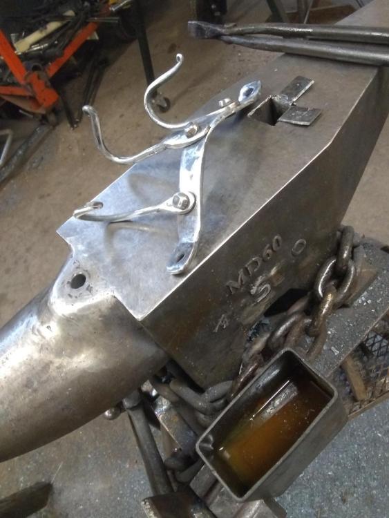

Reducing the holes on an Acciaio anvil
lary replied to lary's topic in Repairing and Modification to Anvils
The first one I did 8 months ago I used a piece of 1 inch shaft bored out 1/2 inch lengthwise. A lathe is needed for this method. The second one I slid a piece of 1/2 inch into a piece of 3/4 inch thick wall black pipe. Long enough to poke out the bottom of the horn, and slightly above the height of the face. The method with the pipe did a better a job of filling in the hole. And then weld peen, weld peen, I think it was 4 or 5 layers before getting it built up enough to flap disc it level with the face. -

Yeah adapters, I thought about that too. Every hardy tool I have is 1 inch as with where this anvil will wind up when I'm done with it. Typically you would see a hardy hole this big on a larger anvil. Not saying you guys aren't bringing up a good point, it's probably a more common way to deal with a hole that's nearly a 1/4 inch too big. Besides, if the need for a larger square hole repeats itself it give me an excuse to start bringing home swage blocks. Speaking of size, there advertising for these things might be a bit misleading... -

It was 1 3/16". It's now 1 1/8", I used 1 1/2 x 1/8" angle and cut it lengthwise to fit. Had to do a little die grinding / touching up for a 1 inch hardy to fit. -

Sounds like the welds are breaking away from the cast iron part of the anvil? May have used the wrong type of rod or not enough preheat. These Acciaio anvils are cast steel except for the occasional patch of plastic body filler on the bottom. Which was a little annoying when welding the hardy hole. As far as critiquing don't sweat it. I'm glad somebody's paying attention. Just a little FYI, anybody considering fixing damage to the face of an old anvil with 7018, I was able to cut into the welds easily with a file when dressing things up. -

I reduced the size so a 1 inch hardy tool can fit with just a little play. -

I used an air chisel to smooth out the rough casting down inside the hardy hole. I cut a piece of angle iron long enough so I could get two weld beads on the top and bottom of the anvil. Used a die grinder with a carbide bit just inside the hole on top to put a bevel for welding in the angle. -

Goods- Sorry my post was pretty vague on details. For the pritchel hole I laid down short beads of 7018, then peen then air needle. Repeated this several times to build up the area. Used a flap disc to smooth it out. The ice was mostly to keep the heat treatment from being affected between the two holes. These anvils do have that sweet spot where there is good rebound and are sort of hard in that area. As far as separation/cracks, the horn does get pretty hot from the repeated welding. Pictured below is the same make model 132 lbs 60kg. I did the same to it back in February. I've been forging on it ounce or twice a week ever since. But I used a mig welder for that one. Its not perfect, there is some pitting. But I can use it to drift holes. I figure it wont likely see any heavy forging in that area. -
Acciaio anvils have some really large hardie and "prichel" holes. Worked on making this one a little more user friendly. I did lay blocks of ice on the face while welding. Cool idea for a broach Shainarue.

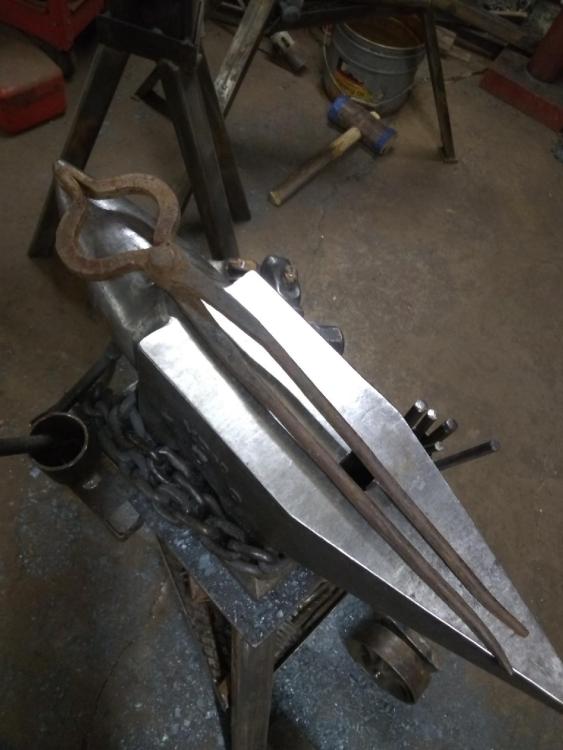

That bowl looks nice. Very symmetrical, and no cracks from work hardening. Attempting to come up with the "perfect" set of tongs for a small wood stove. Was planning on wrapping the tapered ends but didn't have enough material. So last minute change was to scroll the ends of the handle, didn't get them to match. -
