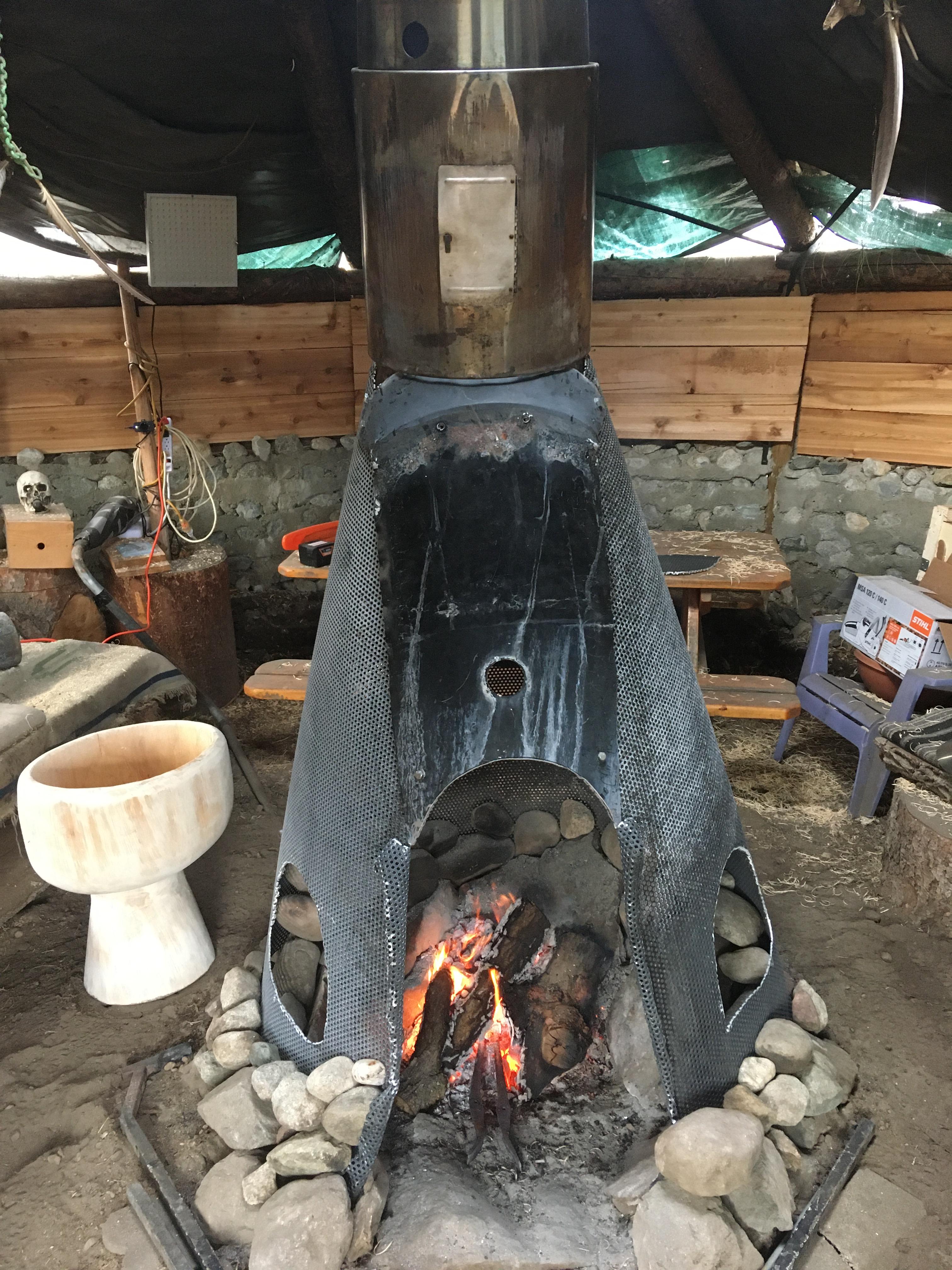

Day off so spent time polishing up hood. Sealed up leaks with high temp silicon after adding 14” pipe a few days ago. Added Thor’s hammer accent to cover hole. Wrapped aluminum flashing and screwed to shroud. Cut harder aluminum and screwed down. Cut another arch. Grinded face accent. Finished ugly greenhorn tongs but they work for thick material. Pounded 1” diameter screw to make hardy hole cutoff. Pounded flat railroad spike. Need to improve hotness to yellow; bright orange is hard day.

I had a fire going under the hood while I was angle grinding circular openings in it. The grinding disk is well worn. It melted through instead of cut through in many places. Several times even bogged the grinder to a halt. I smelled aluminum fumes! I drank plenty of water and aimed the debris away from my body.
The other day I had to cut 2 openings in a 4ft diameter perforated aluminum hood for my firepit forge. Since the reciprocal saw was causing too many vibrations, I had to use the angle grinder. In the process off cutting/melting through arc cuts I caught many whiffs of aluminum vapor. The next day I was more tired than usual and had less endurance on a run with my wife. Metal fume fever?

Day off from work; forged last half of day. More progress on aluminum fire pit hood. Took solid aluminum center flange that I removed from satellite dish and cut with reciprocal saw to fill in void in hood cone; drilled and bolted this down. For transition from hood to 14” pipe, repurposed old stainless steel smoker and bolted to hood. Cut 2 openings with angle grinder, difficult. Smoothed sharp surfaces too. Buddy will bring over free stainless steel roll to cover perforated aluminum hood in future. Worked more on drawing out reins on tongs. Love larger ball peen hammer ambidextrous. Hood makes hotter fire and less smoke. 14” x5’ pipe will finish project when arrives in a few days. Also sanded djembe drum and played drum. Transferred hot coals to smoker for pork loin. A good day, time for a beer.
Are you are planning to penetrate the roof and install hood and pipe; super sucker? If you are, I am sure the folks on this forum could suggest the best location based on rafter pics, ergonomics and code clearances.
If you go to the home depot website and type in "master flow pipe" , in results you get a whole line of round metal duct pipe from 8" diameter all the way up to 14" diameter that are way cheaper than standard stovepipe in one 5' long piece.
