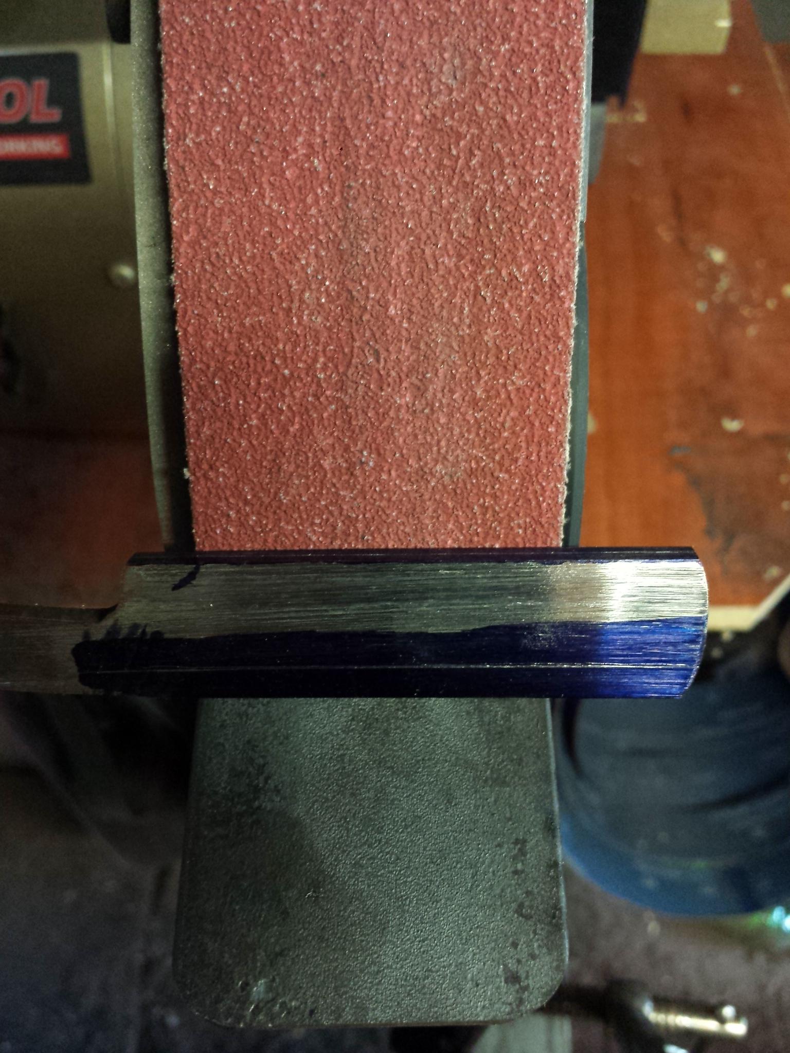

I made a basic tool rest for my belt grinder today and started putting a hollow grind in a straight razor. It's still too thick, even for heat treating, but it was about all I could get done before the mosquitoes carried me off. They were bad today for some reason. -

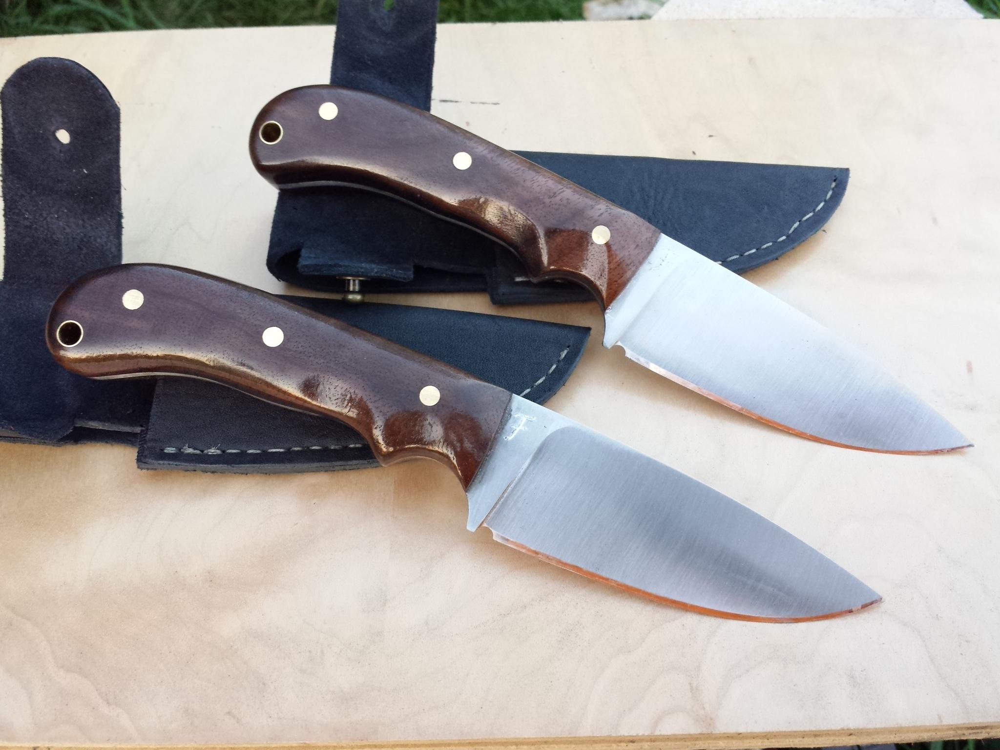

Those are very nice! Stunning detail and excellent fit and finish. I'm envious of your leather work as well. Mine is almost up to an amateur level now haha.

The only thing I can see to even be nit-picky about (and this is probably getting really nit-picky), is that I see a couple wire edges left on the sharpened edges. I shave with straight razors, so the sight of those make me cringe a little, but other than that they look spectacular. -
