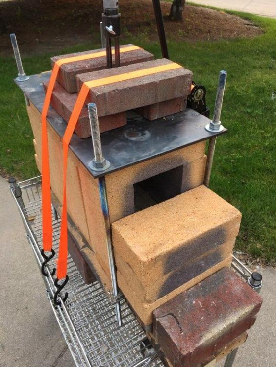

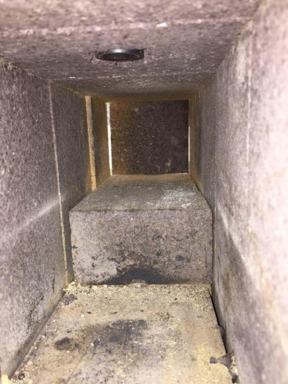

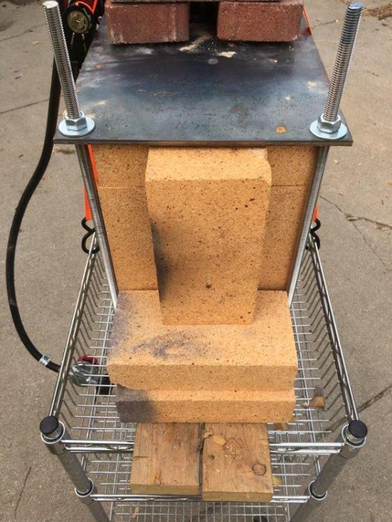

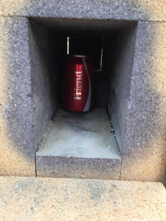

  9. Awesomeness. We'll get on all of these and then repost when we've got things a little more finely tuned. Thanks everyone, we love that you're all willing to share experience - we certainly need it. 1. Straps. Check. Good catch. 2. Soft Brick: Any recommendations? We're learning names and numbers, but it's always good to go to the pros with specs. It totally makes sense that the heat is sinking into those hot spots. We'll modify the floor and work some IR magic and see if we can get things a little warmer, too.) 3. More images of the burner - we'll get those and a link. 4. Burner. We'll move it up so it's not flush and see what happens. Cheers and thanks everyone! If you all think of anything more, don't hesitate to let us know. Troy and Nick
  10. Heyas everyone! First off... thank you for all of your encouragement and information. Here's the result of our first go at building a gas forge a la 'cart'... you'll see what I did there. It gets hot, it makes things glow, and it makes the mother nervous... so we must be on the right track. Would you all take a peek and offer suggestions to our design? Ultimately, my son, Nick, wants the ability to forge weld, but it seems like we're just a little shy of that mark as of right now. In a couple of the images below I've placed a good ol' Coke can in frame for reference, but belatedly realized that most of you know the size and shape of every brick ever made and mumble them in your sleep. So... what could we do better? What are we doing wrong from the outset? And most importantly, what do you need to know to answer these questions - we're as new as new can be, but we'd like to do it right. Cheers! Troy and Nick
