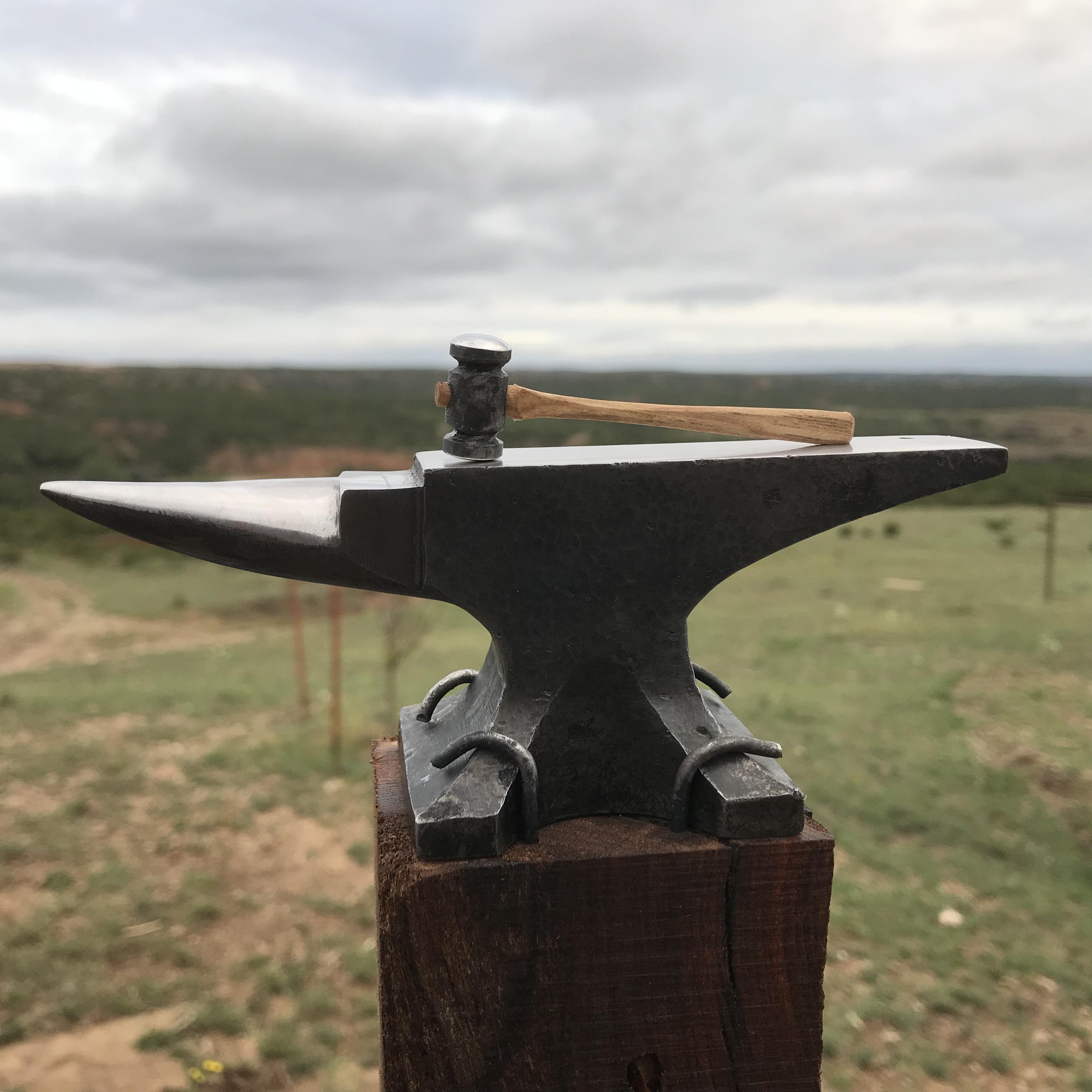

Jennifer, it hard but not like hard rock maple and fairly brittle. The burls are absolutely beautiful. It’s not terrible rot resistant though. Here a picture of this stump in the sun so you can see the colot and grain better. -
Ranchmanben replied to Mark Ling's topic in Blacksmithing, General Discussion
Arkie is for the most part correct although I’ve seen a few random ones that were bigger. I’ve got some chunks in my barn that are 26” diameter. I don’t have a saw big enough to cut it into useable lumber. Jennifer, that piece was some of my firewood. -

Thanks Gergely. Mesquite is mighty pretty and it’s stout enough for this but this one is extremely portable. JHCC, I like that forming dish. I’d really like to have one that’s just a tad bit shallower than yours. Did you do anything to reinforce the underside? -

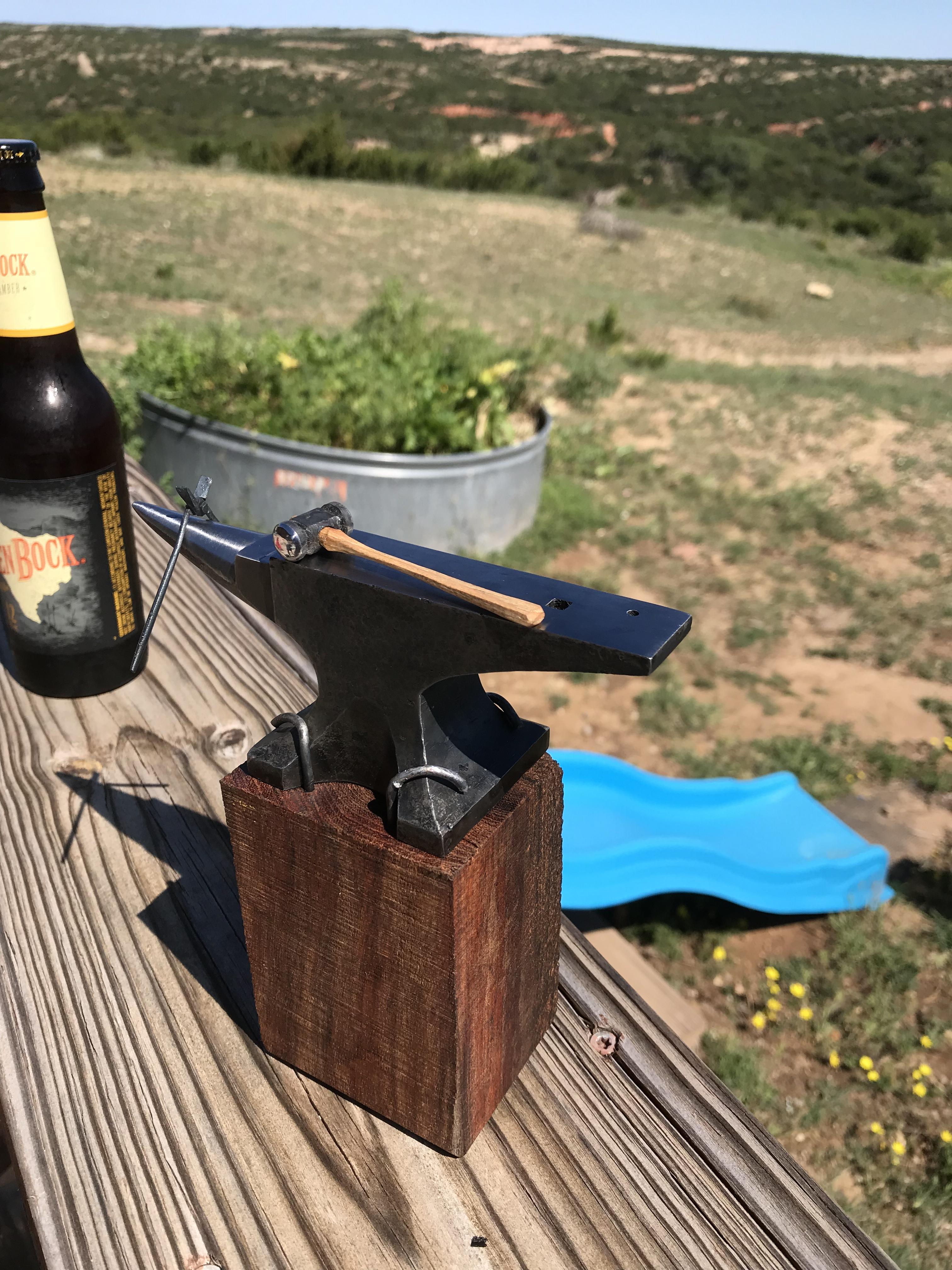

Mesquite isn’t that bad to work if you’ve got the right tools. That handle is pretty thin, maybe 3/32” at the thinnest section. -
Mike, it’s only there for the picture. I’m probably going to keep them in my living room. -

Made a mesquite anvil stump for a new anvil and also built a new hammer. The anvil is on the small side but I really like it -

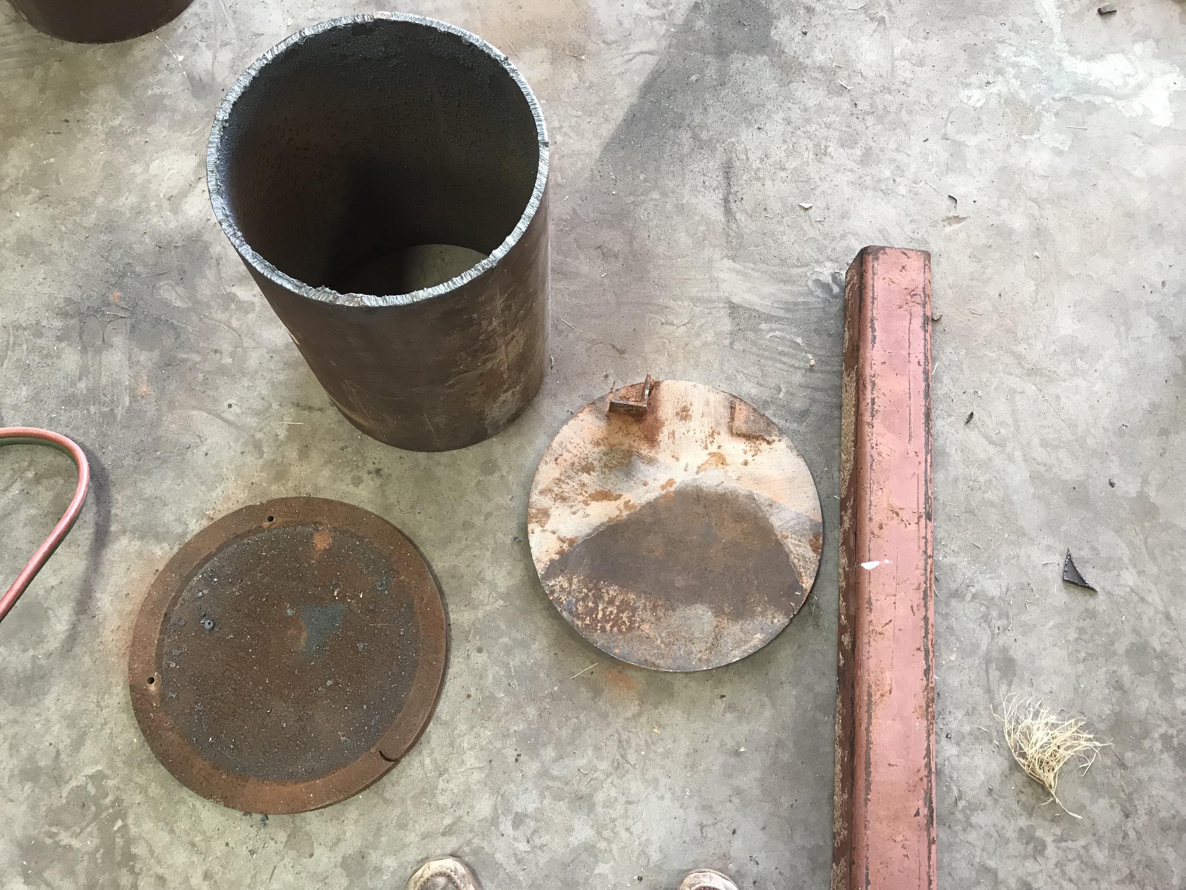

Thank you. I’ve been going back and forth about doing that. It only over hangs the pipe 1.25” all the way around so I don’t really think it will be too much of a hinderance if I don’t do it. I’ll probably stick the anvil on it as is and see how it is. I’m planning on putting a rack for hammers and tongs so that might make me stand too far away. I really should just make a rolling hammer rack and only put the swimming tool tray on the anvil stand. -

Made a little bit of progress. Cut the square tubing 1/4” longer than the big pipe and welded it to the center of the bottom plate. Next I cut a 4.25” square hole in the top plate to give me a little wiggle room when doing the fit up. I then welded the pipe to the bottom plate and did a test fit of the top plate. At this point I’m at a stand still until I can get some sand and drill holes for mounting bolts. Ordinarily the sand wouldn’t be an issue since we’ve got a couple of dry creek beds running through the ranch but last night we got a couple inches of very much needed rain. I suppose I could cook the moisture out of some sand but that sounds like a pain. -

It’ll certianly be heavy but I do t know if I’d call it big, still easy enough to get right up next to it. I do plan on filling it with sand and oil, I don’t like my anvils to move. If I could, I’d like to bolt it to the floor but that’s not in the cards. -

Thought I’d post pictures of a new anvil stand build. The pipe is 12” diameter 3/8” wall. The round plates that will be on the bottom and top is 16” diameter 3/4” thick. The 4” square tubing will be welded To the center of the plates and lend additional rigidity. The interior of both square and round pipe will be filled with sand.
